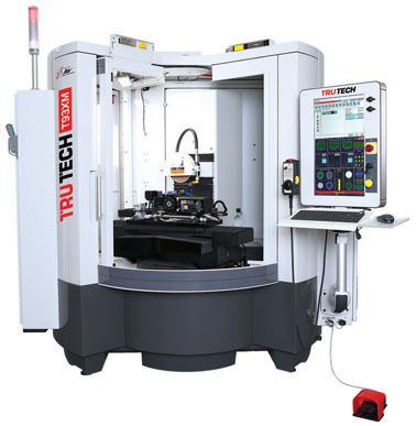

Image of Star Cutter Shown is the Star Cutter T93XM high-precision centerless profile grinder. Star Cutter Company

Leading tool grinding systems providers are also advancing their offerings with important design features for tool manufacturers to leverage. Floor space can be at a premium, which is why there are now options for compact machines with small footprints, yet relatively large grind zones. Additionally, operator comfort and ergonomics are being addressed with easy access and wide door openings. Additional safety features such as fire suppression are also becoming more prevalent. Modular designs are making an impact in several ways, such as including automation to expand unattended machining and continuous productivity. With that, base machines like the TRU TECH T93XM are augmented (T93XM-A) with an automation module that includes a pallet system and auto loading for a significant productivity boost — up to two and a half times the throughput. Other innovations to extend productivity cycles focus on the grinding wheel itself. Automatic and in-process wheel dressing offer flexibility and speed for lights-out manufacturing.
