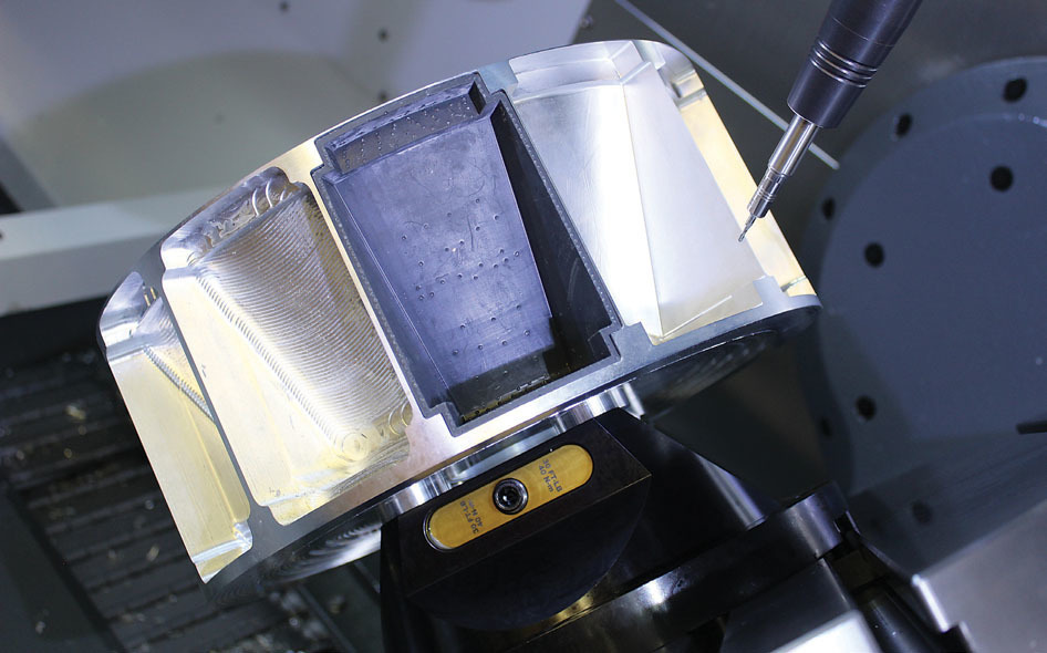

When machining thin-walled features on parts, the lack of rigidity introduces vibration into the system. Vibration, in combination with cutting forces causes chatter, which can lead to poor surface quality and out-of-tolerance features, as well as being detrimental to tool life.
The use of clay as a stabilizer is the traditional way to combat vibration and chatter while machining parts. Clay is dense and sturdy enough to add support to thinwalled features and can withstand cutting conditions and fluids. However, clay is a dirty material that can be hard to clean from parts and is time-consuming to implement.

SVMS dampening inserts are custom-designed and 3D-printed for use with a specific workpiece to be machined. SVMS dampening inserts are composed of a rubber resin that is flexible without loss of integrity. These inserts can be stored and reused for identical projects, and they can last for up to two years before breaking down, depending on frequency of use. The customized, 3D-printed inserts enable a machinist to create any complex shape that needs support during cutting, milling, boring, turning or grinding.
Use of SVMS instead of the traditional clay method reduces the vibration in almost all areas. In some cases, the traditional clay method can still be used in conjunction with SVMS to eliminate the vibration, hold tolerance and keep the feature more dimensionally accurate.

This innovation allows for 100% customization that allows the NASA machine shop to meet the specifications of a specific machining task. Using the SVMS process, hardware can be machined more efficiently with a shorter set-up time and easy mobility, allowing for a quick change of setups.
Rapenchuk and Veneziano have been using the SVMS system successfully in Glenn’s machine shop since 2021, primarily for the manufacture of prototypes, and it has resulted in cleaner, easier and faster machining of parts. Also, the risk of damage to parts caused by vibration is mitigated, saving labor and machining time.
Compared to traditional clay vibration stabilization, using the SVMS 3D-printed dampening inserts has saved an average of one to two hours in clean-up time per job, and up to 12 hours on more complex jobs. The time savings is primarily with clean up — because clay gets messy.
