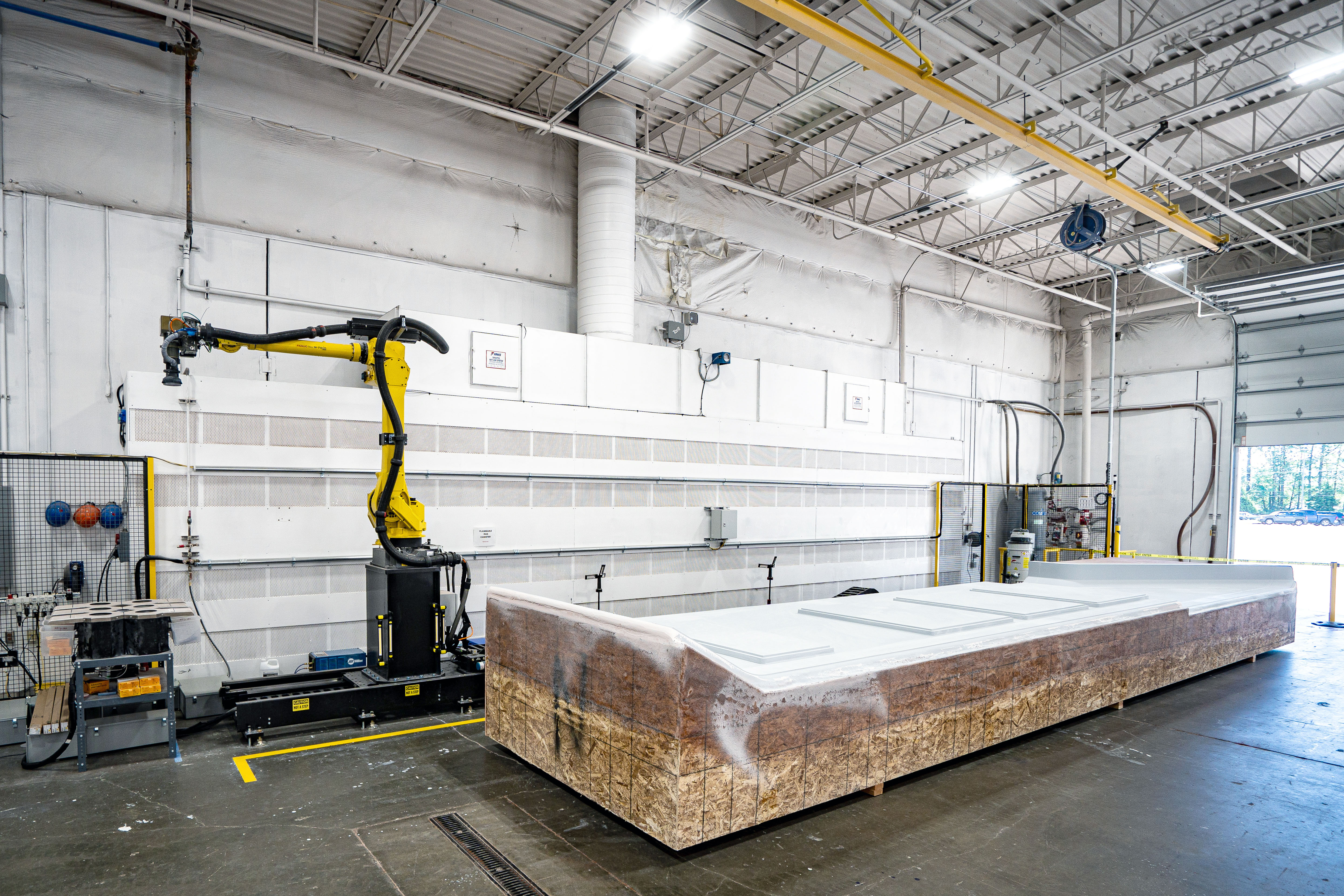

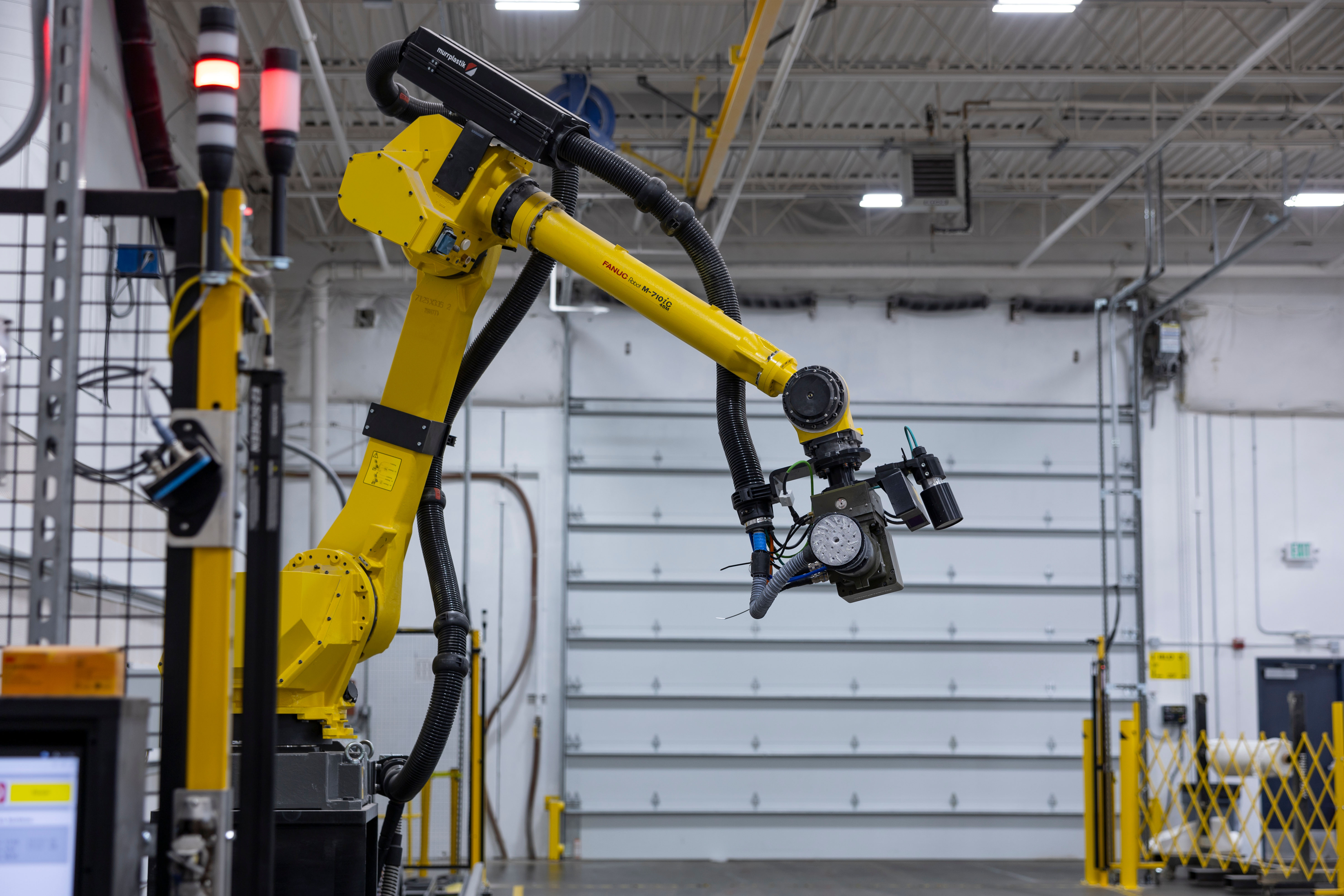

The Scan&Sand system incorporates a Fanuc M-710iC 6-axis robot. Image courtesy of GrayMatter Robotics“>
The workpieces measure from 1.83 m long by 1.22 m wide (6′ by 4′) up to 21.34 m long by 4.88 m wide (70′ by 16′), which is the maximum pass of the mill, he noted.
The system’s M-710iC 6-axis Fanuc robot uses a laser scanner and an RGB camera to scan the surface of a part, McKenzie explained. “The laser scanner is used to determine the physical shape of the part, where the RGB camera is used for tape detection. Sometimes we are able to use the tape to avoid areas and also encapsulate the area you want to sand versus not sand.”

Because sanding putty generates a lot of fine dust, the system has a vacuum to suck up the dust and keep the work area clean, he said. Being a nickel-iron alloy, sanding Invar does not create as much dust, but the vacuum helps.
“The sanding cell is located in what we call our ‘putty land,’ which is where we make putty tooling,” McKenzie said, adding that the cell is technically located in the company’s B3 finishing bay, and the bay’s nickname also applies to the area where Janicki makes the putty.
With the GrayMatter system, putty sanding is an unmanned operation in which an operator presses a button to activate the robot and sand the workpiece, McKenzie noted. “Every once in a while, you have to fill up the sandpaper container.”

The system is set up for scanning Janicki’s four common part sizes of 1.23 m, 1.83 m, 2.44 m and 3.05 m (4′, 6′, 8′ and 10′), McKenzie said. “The operator can say this part is 6-feet tall, I’m sanding putty, and I want to sand it to a 120 grit and clicks those three buttons. There are some popups that asks: is tape in place, is the part in the right location in the cell, is anyone in the cell. After that, he presses continue and the robot is off doing its own thing without any human involvement.”
Janicki Industries uses the Scan&Sand artificial intelligence-powered robotic sanding system to finish tools made of putty, as well as Invar. Image courtesy of GrayMatter Robotics“>
The sanding cell measures 5.49 m long by 15.85 m wide (18′ by 52′), he noted, and a laser sensor that surrounds the cell will automatically stop the robot if someone enters the cell. A radar system on two ends of the cell can be turned on to allow processing of parts larger than the cell. “Scan one section, sand it and move the part down 10 feet to sand it. The maximum part size we can put in there is 16 feet by 60 feet.”
The system is powered by GrayMatter’s GMR-AI application-specific software. With AI, once a part is scanned, the system plans the toolpaths for the robot to follow along the part as it sands while ensuring there are no collisions and the surface shapes are properly maintained, McKenzie said. “Without the AI system, all these parts we’d have to have someone manually plan out the toolpaths. With AI, you can have a tech who doesn’t have any experience with that run the cell.”
