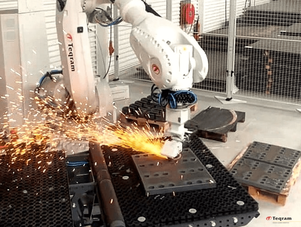

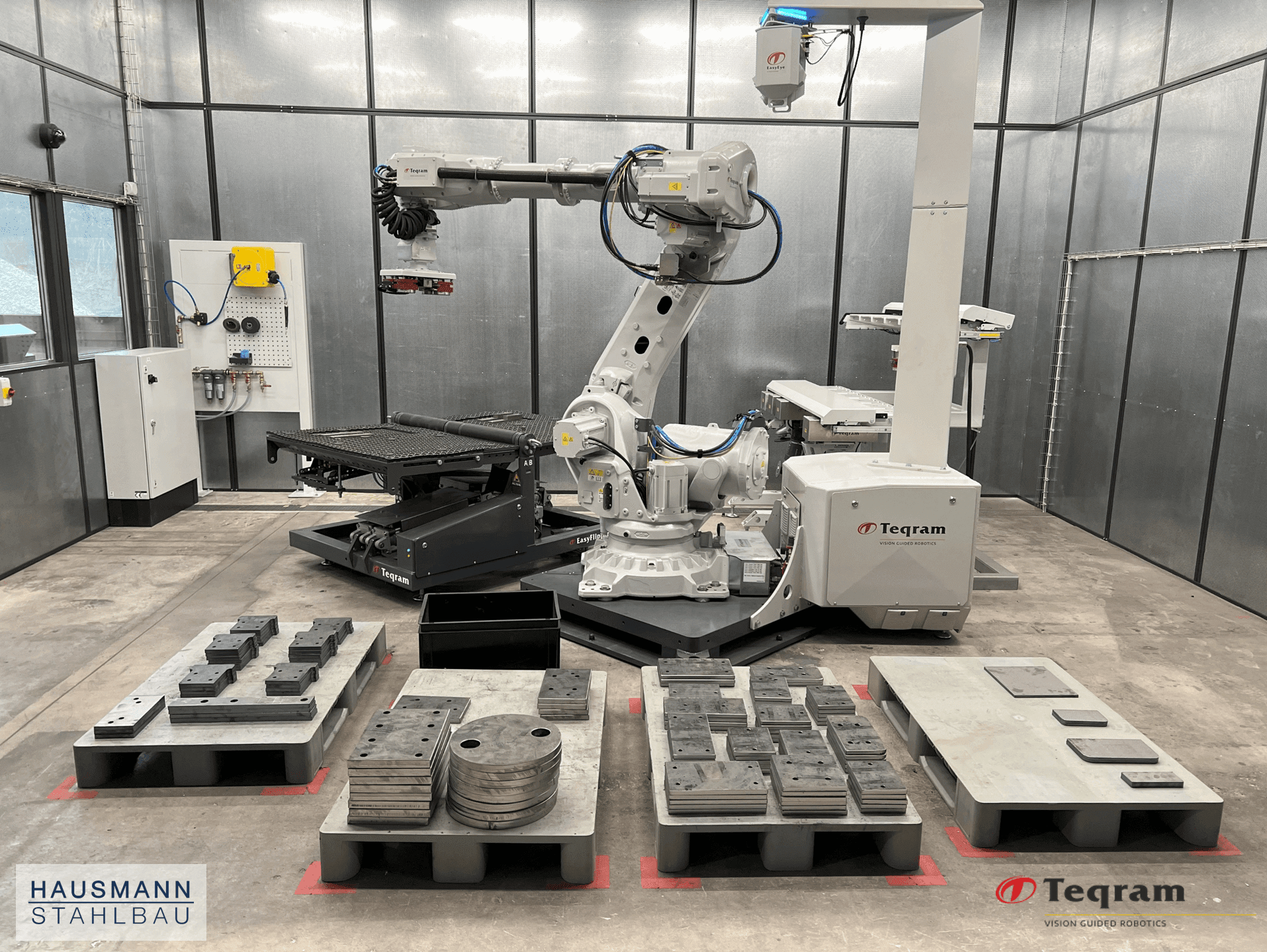

EasyGrinder autonomous robot for high-quality preparation of steel construction parts.

Equipped with advanced 3D vision and an AI-driven controller, the EasyGrinder processes thermally cut steel workpieces without requiring programming or preloaded geometry data. This capability makes it an ideal solution for steel construction firms that frequently work with custom designs or small production runs. By adapting on the fly to different workpieces, the system ensures a level of precision and efficiency that manual methods struggle to match.
Versatile approach to grinding

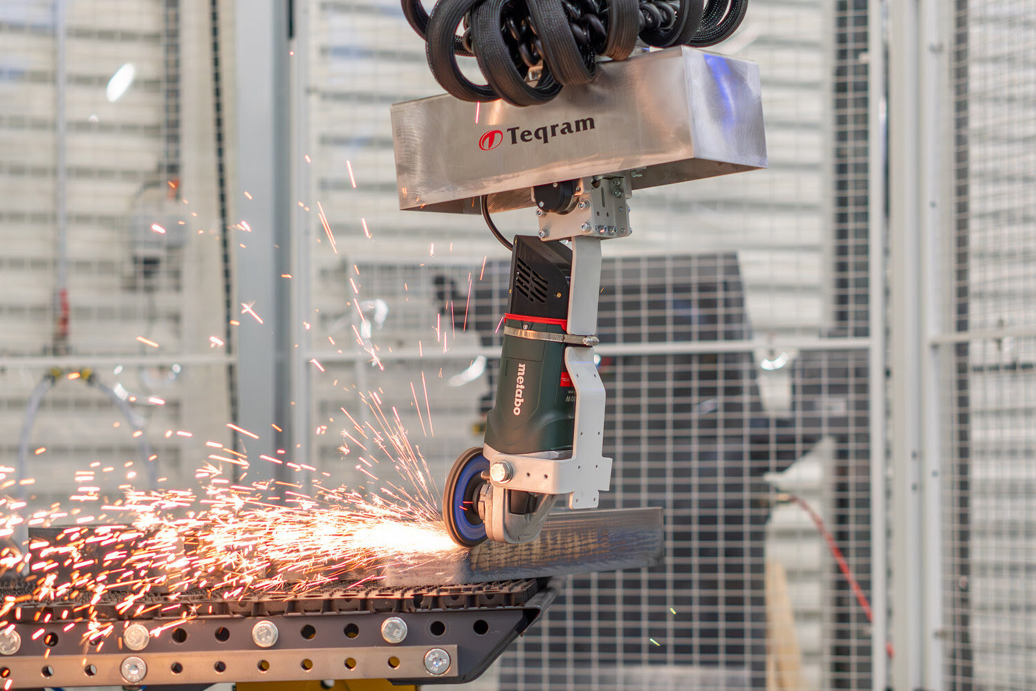

What sets the EasyGrinder apart is its flexible tooling system, which adjusts to the specific needs of each component. Slag removal is handled with a chisel, while edge rounding is achieved using a lamella disc or a pencil grinder, depending on the shape of the workpiece. For cutting edges, an angle grinder is used, while countersinking tools refine drilled holes. Even intricate lead-ins or starting points are efficiently removed. This adaptability guarantees optimal surface preparation, regardless of complexity.
No programming, no hassle
One of the standout features of the EasyGrinder is its ability to operate without programming or preloaded geometry data. Using real-time 3D vision, the system detects the geometry of each workpiece and determines the best processing strategy.
For instance, when creating a 3/32-inch radius, the system performs the operation in three controlled steps with a flap disc, ensuring compliance with AISC 360 and AWS D1.1 standards for structural steel fabrication. The operator’s role is simple: place the workpieces on pallets within the robot cell and select the desired processing quality from pre-set options.
