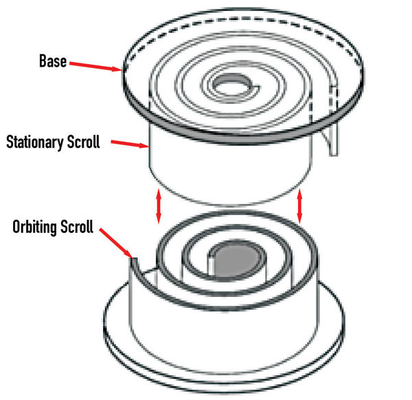

There has been an increase in demand for scroll, or spiral, compressors as the accuracy of the methods used to make them have improved. Scroll compressors are used to compress refrigerant or air to create vacuums. A scroll compressor has two Archimedes spirals nested together. Figure 1 shows components of a scroll compressor, and figure 2 shows how it works. The gas enters at two places on the outside of the scrolls and exits through a hole at the center of the fixed scroll. Patented in 1905 by Leon Creux, this is an example of an inventor being way ahead of the curve. Creux could never make a unit that worked. The way that a scroll compressor seals in the gas is the conundrum. In figure 1, the open ends of the helixes have a groove to accept O-ring material that sets against the base of the other spiral. That seals the unit axially. Radially the unit is sealed by the gap between the stationary and orbiting spirals. The smaller the gap, the better the seal and efficiency of pumping. But if they touch, it is trouble.

Figure 1: Components of a scroll compressor.
