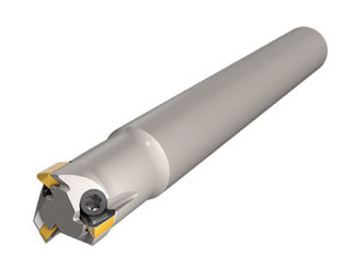

Adding Indexable Heads
In recent years, these interchangeable systems have been further augmented with the introduction of interchangeable-indexable heads. This provides users with the inherent cost benefits of indexable inserts along with the added versatility of customizing the interchangeable head and its indexable inserts (geometry/grade) to the material and part geometry at hand.
