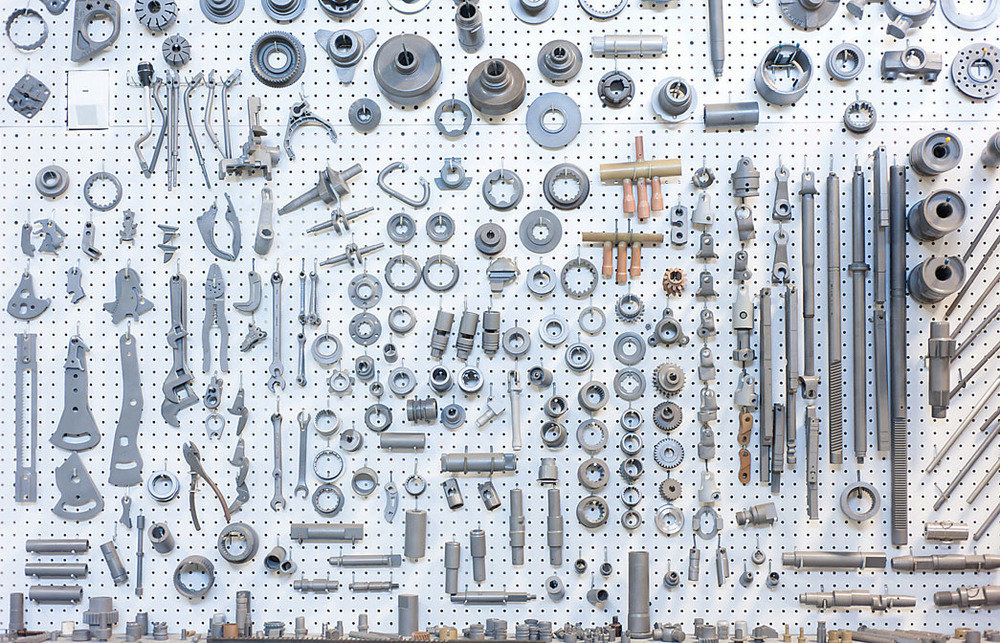

Broaching can produce a wide variety of parts, a small sample of which is shown here. BMS

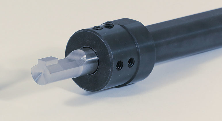

For applications involving harder materials, Renner said a newer alternative to rotary broaching can be employed. Known as punch or single- point broaching, this technique relies on a “peck mode” that has the tool making a number of shallow passes to remove material a little at a time until the desired shape and depth have been achieved. With this method, parts made of difficult-to-machine materials can be produced at high volumes on CNC machines.
Renner pointed out that single- point broaching isn’t as fast as rotary broaching, but it is a way to use a CNC machine to take on applications that are not appropriate for that process. She noted that single- point broaching is ideal for slotting keyway forms, as well as for producing splines, couplings and other parts with tooth heights that require greater pressure to make than the rotary broaching process allows.

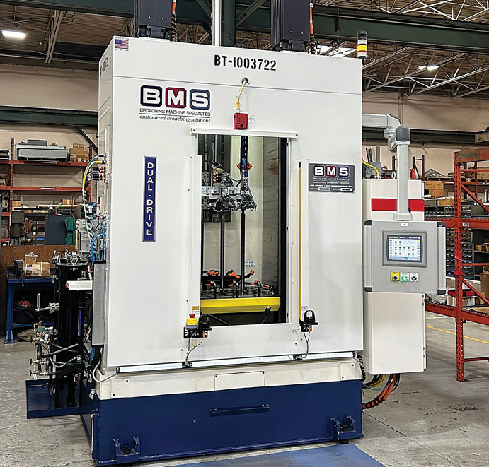

Image of an electromechanically powered broaching machine
An electromechanically powered broaching machine, the eco-friendly BMS Dual Drive features clean operation and low energy consumption. BMS

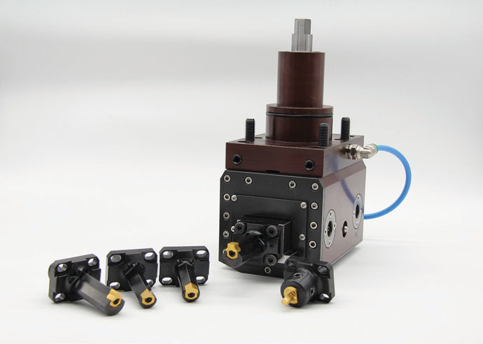

Another option that allows broaching on CNC machines is the REV broaching tool, developed by the Italian firm F.P. Officina Mechanica. Attached to a mill or lathe, the company’s motorized tools use a reciprocating in-and-out motion to create part features. Like rotary and single-point broaching, REV broaching on a CNC machine eliminates the need to re-fixture parts when they’re moved from machine to machine, which increases cutting accuracy, noted Preben Hansen, president of Platinum Tooling Technologies, a distributor in Prospect Heights, Illinois, that sells REV tools. Hansen added that REV tools are not a recent development, but the technology has been refined in the last couple of years to boost both accuracy and production.
On the negative side, he also pointed out that REV broaching is limited when it comes to stroke length, which in turn puts a limit on part sizes. “You’re probably looking at no more than 2½" of stroke,” he said. “Anything longer than that and you probably have to go back to the more traditional (broaching) methods.”

For those still interested in dedicated broaching machines, developments have been made that make the option more attractive. For one, more broaching machines are being built with electromechanical instead of hydraulic power, according to Matt Egrin, president of Broaching Machine Specialties (BMS), a seller of broaching machines and tools in Novi, Michigan. Driven by ball or roller screws, electromechanical machines eliminate some of the backlash that causes chatter in hydraulic machines, which results in better part finishes, Egrin said.
In addition, systems with screws driven by servo motors are more accurate than hydraulic machines, noted Ken Mackenzie, general manager of Crankshaft Machine Group (CMG) in Jackson, Michigan, another seller of broach tools and machines. Servo-driven systems, he explained, include encoders and linear scales that allow more precise positioning than oldstyle hydraulic cylinders and limit switches — thereby boosting part quality and reducing scrap rates. The servo/screw combination also eliminates the need for a large hydraulic tank, which frees up floor space, he added.
The lack of hydraulics offers other benefits as well. One is that plants with electromechanical machines don’t have to deal with oil leaks on the floor, noted Egrin of BMS. Besides running cleaner, he said, electromechanical systems run quieter and cooler than their hydraulic counterparts. Moreover, they’re significantly less power-hungry, which is good for the environment and the corporate bottom line. “With a hydraulic machine, the motor’s constantly idling whether or not the machine is in motion,” Egrin said. “But with an electromechanically powered machine, the motors are only turned on when the machine is in motion. So you’re saving probably at least 30% on the electrical bill.”

Image of Motorized REV broaching
Motorized REV broaching tools create part features with a reciprocating in-and-out motion. Platinum Tooling
