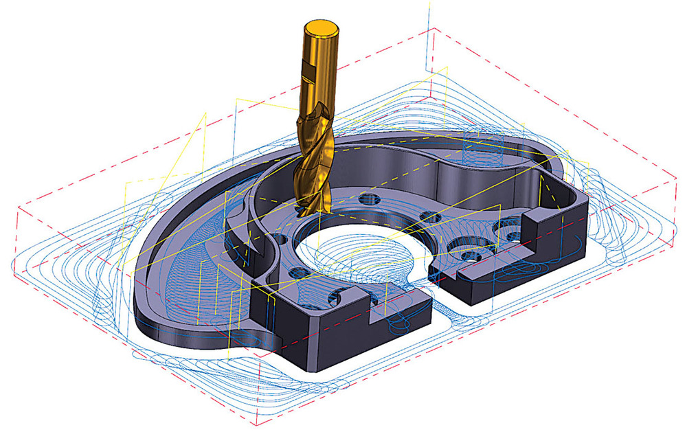

image of CAM software
CAM software (above) guides the tool to create complex parts using HEM. Mastercam

HEM tools also benefit from the special CAM-generated toolpaths — trochoidal, adaptive clearing and constant engagement, for example — that are employed when machining complex parts. These produce lower peak cutting forces than traditional roughing, which can cause high load spikes while cutting corners and curved features, noted Mike Gomez, principal R&D engineer at MSC Industrial Supply.

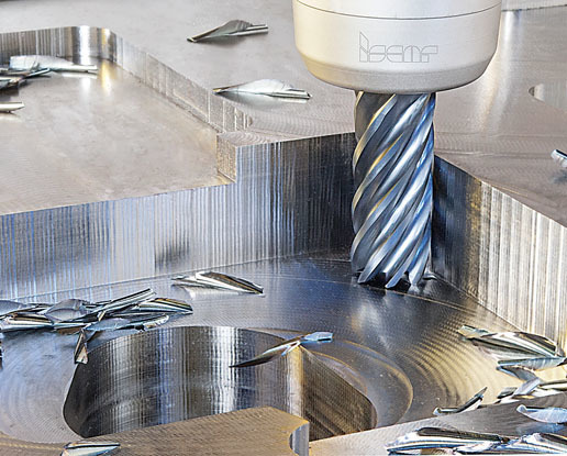

image of high-speed trochoidal milling
HEM users employ tools like this seven-flute endmill featuring variable helix and pitch for chatter-free high-speed trochoidal milling and finishing operations. Iscar USA

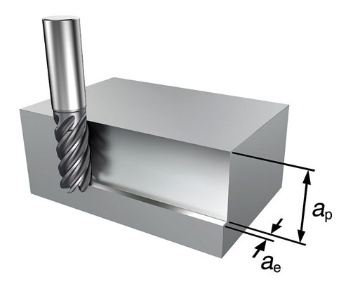

image of smaller radial depths of cut and larger axial depths of cut.
High-efficiency milling (HEM) is characterized by smaller radial depths of cut and larger axial depths of cut. Sandvik Coromant

Distinguishing characteristics of HEM tools include unique edge prep and eccentric grinds around the relief face of the flutes to help with heat management, Gomez noted. In addition, HEM tools feature a variable pitch, variable helix cutting flute design. “Traditionally, endmills have had evenly spaced flutes. So, when they’re running at higher feed rates like you typically do with HEM, it’s easy to hit a resonant frequency that leads to chatter or unstable cutting,” Gomez said. Now, however, “you see a lot of newer tools with slightly offset flute spacing — that is, variable pitch.” As for variable helix, he explained that varying helical angles helps break up cutting forces into different frequencies, further reducing the risk of chatter.
