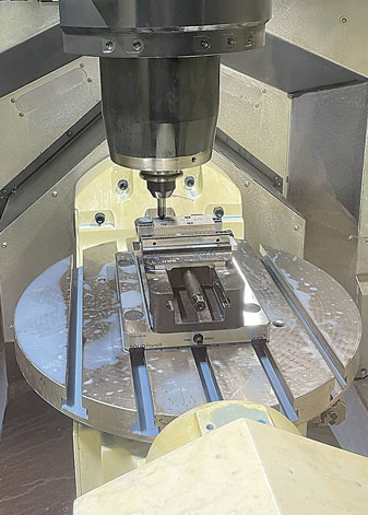

The manually actuated SolidPoint offers the possibility of combination plates that include both 96 mm and 52 mm grids in one plate. With two locking slides and a threaded spindle with opposite rotation, the company reports that the mechanism consists of only three components and therefore has minimal friction losses. The locking force within the mechanism is applied at a 45° angle, which increases pull-in force and provides repeatable, safe clamping results. The wedge system has a repeatability of 5 μm (0.0002"), Saur noted.

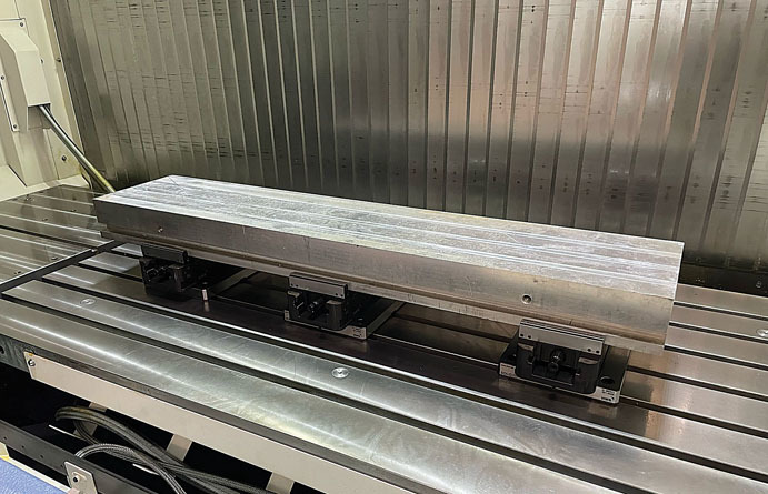

The design of SolidBolt is based on an optimization of the SolidPoint principle, according to HWR. By reversing the interaction of zero-point mounting and studs, SolidBolt can be used to equip a large machine table for a low cost. This means that machine tables or base platesare equipped with bolts and not with zero-point mechanics, and zero-point technology is only used punctually at the required points.
SolidBolt is basically a reserve system, according to Saur. A large machine table could require four or six SolidPoint plates, which are expensive because they contain internal mechanics. On the other hand, SolidBolt base plates do not contain internal mechanics and fit practically all machines. Pull studs can be placed wherever they are needed on a machine table. Zero-point mechanics are housed within the vises, allowing them to only be applied where needed. “Then, with a very big part, you just put devices in different corners of the table, and you can clamp parts up to 800 mm wide and the length of your table.”

Zero Point is predominantly used for milling, Dang said, and the system typically requires two Zero Point pots for alignment purposes because lineage cannot be built with one circular pot. In conventional workholding, the entire vise is bolted down and cannot be moved, whereas with Zero Point the vise can sit on a plate that has a clamping stud. “I can put that whole vise on to that Zero Point system. The whole vise can come off and the whole vise can come back in within seconds, without indicating the clamping stud or the clamping part.”

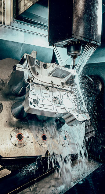

Hoffmann Quality Tools USA Inc. is another provider of zero-point clamping systems with its Garant ZeroClamp. Paul Lanham, application engineer for the Knoxville, Tennessee, tooling manufacturer, emphasized that due to the central zero point, the system provides thermal symmetry at all times and is therefore a “true, absolute zero point. It has thermal symmetry, so it can pull individually from each clamping pot.”
image of Garant ZeroClamp system With the Garant ZeroClamp system, thermal expansion is compensated by acting always in relation to the center axis, so only one type of clamping stud is needed. This offers a great degree of freedom when arranging the clamping points and simplifies handling at all stages of production. Hoffmann Quality Tools USA
According to the company, conventional clamping technologies that use floating studs to compensate for thermal expansion produce inaccurate results if workpieces are rotated around the central axis. Garant ZeroClamp, however, does not have floating studs nor sword studs, and compensation for thermal expansion is always symmetrical about the central axis.
“It can pull in all four directions to keep your part centered. It repeats within 2 μm,” Lanham added. “When you are pulling in one direction, your part wants to grow or move and then you have tolerance issues.”

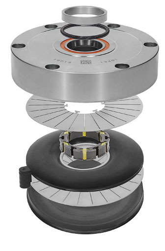

Another advantage of the system is it only requires 5.5 bar (80 psi) of compressed air to release the clamping studs, and locking is by spring pressure, Lanham said. “You open up the doors, you plug your air line in and, as soon as you take the air line off, it’s clamped. You don’t have to have all this custom piping. We do offer it if it’s needed for more automation.”
image of clamping pots The Zero Point clamping system uses technology similar to HSK that allows for high repeatability with a low profile. Lyndex-Nikken
In addition, the low-maintenance, sealed system functions without hydraulic oil.
He added that the 120 mm-dia. (4.7") clamping pot provides 25 kN (5,620 lbs.) of clamping force and the 138 mm one offers 40 kN (8,992 lbs.) of clamping force. “It’s not going to go anywhere.”
Another zero-point highlight is that the system can be rebuilt with a kit, Lanham said. “We can send it back to Europe, but we would really like to go through it with them [customers] and have them do their own thing. It can be completely taken apart and put together with the same parts, and you have a brand new system. The whole locking unit is made so that it can be broken, and you can repair it.”

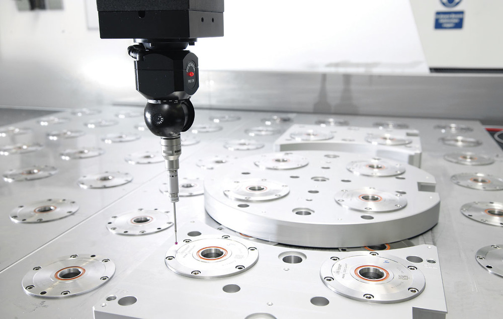

In addition to using a zero-point clamping system for machining parts, the system is also suitable for quickly doing first article inspections, Saur said. “In our case, you would have a zero-point plate on your CMM. You take the whole vise out, you put it in the CMM, you bring it back and you can re-machine it.”
He added that there are multiple ways a zero-point clamping system can save time. “If shops understand what zero point can do, they will buy zero-point systems. Maybe not from us, but they will buy it if they understand the advantages of it.”
Lyndex-Nikken’s Dang added that using Zero Point for inspection purposes enhances repeatability because a part can be inspected with the datum point already in place. “Anytime you unclamp a workpiece from its clamping element, you’re exposing it to material changes, expansion; things move around and then you try to put it back into an inspection machine and you have to recreate that datum point. You don’t need to do that with a Zero Point system as it can be used in machines for milling, turning, spark erosion and quality assurance. As the datum is already established, you simply remove the clamping unit with the part in it from one machine and put it in the inspection machine.”
