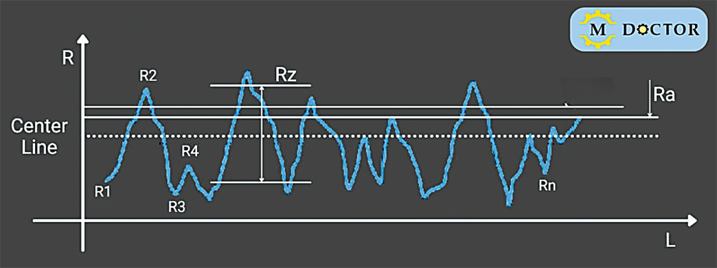

  • Mechanical Scanning: The most widely employed technique for measuring surface quality involves scanning the surface using a stylus that documents the microscopic peaks and valleys across a linear path. This measurement generates a profile (see Surface Finish Scan chart below) that undergoes mathematical analysis to produce a surface quality value.

a chart Surface Finish Scan Surface Finish Scan

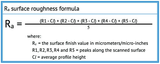

Ra, known as the roughness average, is the most frequently used unit. According to ASME B46.1, Ra represents the arithmetic mean of the absolute values of profile height variations from the centerline, measured within the evaluation length. Using the same parameters that correspond with those shown in the Surface Finish Scan chart, the calculation follows the formula shown above.

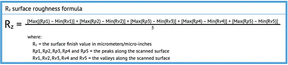

Rz, is the “Peak to Valley” average, and is the second most common unit. The calculation involves measuring the vertical distance between the highest peak and the lowest valley within the scanned profile. The top five peaks and the five deepest valleys are measured, and then these distances are averaged. Rz consistently produces higher values than Ra. The calculation uses the formula shown below.
a chart of chemical equation
A frequent question from machinists and engineers concerns the conversion of Ra to Rz values. Direct conversion from Ra to Rz (or Rz to Ra) is impossible since they represent different characteristics.

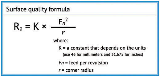

The Surface Quality Formula and Key Insights
Understanding the best course of action begins with familiarizing yourself with the surface quality formula.
Analyzing this formula reveals three interesting observations.
  1. Reducing the feed rate enhances surface quality.
  2. A larger corner radius improves surface quality.
  3. Since the radius is squared in the formula, it is a much more influential parameter for optimization.
Experiment with this equation using the Surface Quality Calculator on the Machining Doctor website.

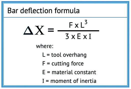

  • For both external and internal tools, minimize the overhang. Even small overhang reductions can substantially affect system rigidity. The bar deflection formula (below) shows that deflection correlates directly with overhang cubed.
