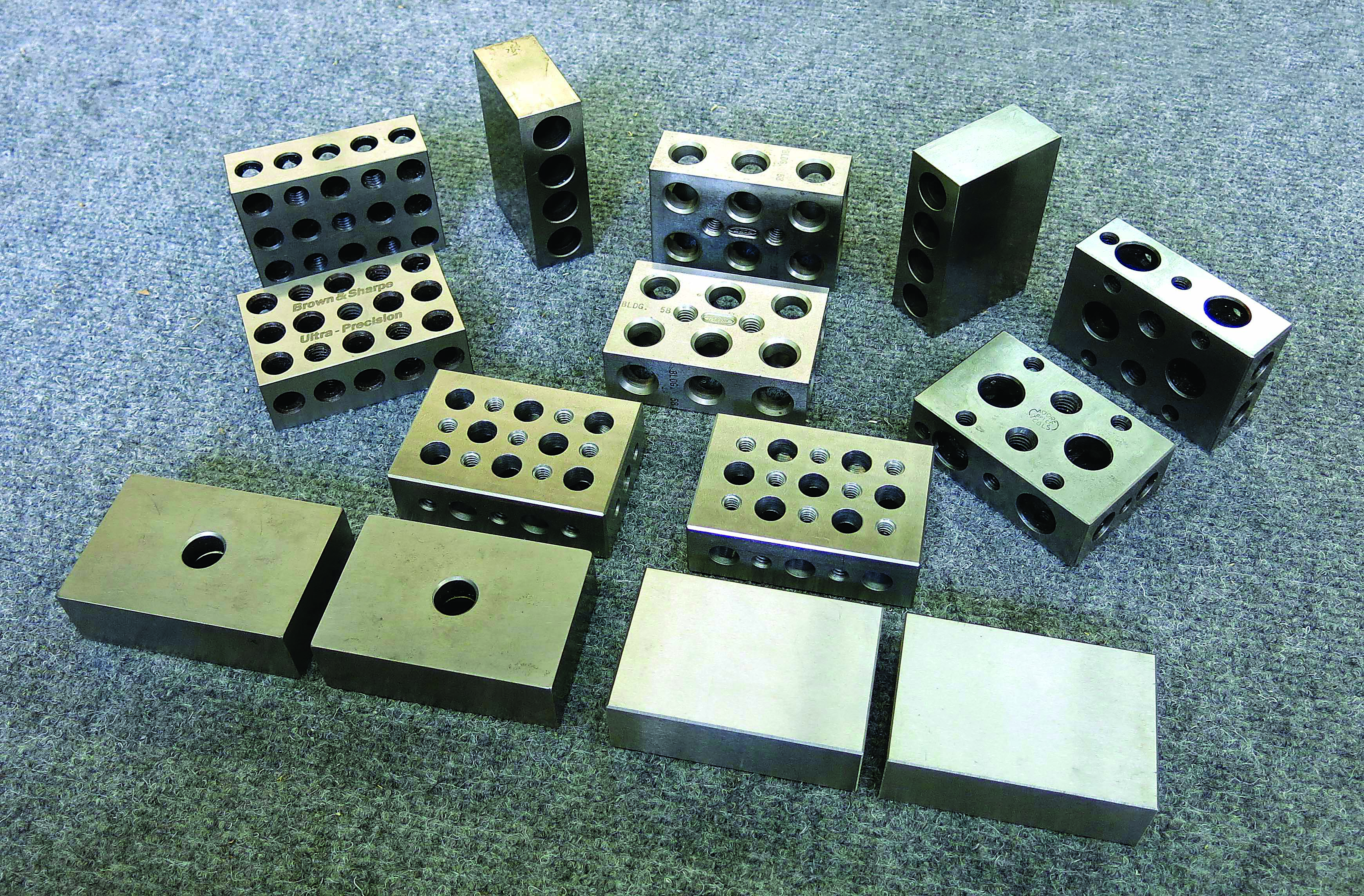

These blocks typically are riddled with an array of holes, which, depending on the maker’s whim, can be drilled, tapped, counterbored or processed some other way. Sometimes holes are drilled to lighten the blocks. Supposedly, the hole patterns help machinists attach the blocks to machines or connect them to form more elaborate setup aids and fixtures.

Figure 1 shows an array of 1-2-3 blocks with various hole configurations. I will focus on blocks with threaded attachment holes because this is the feature that makes them a universal inspection tool.

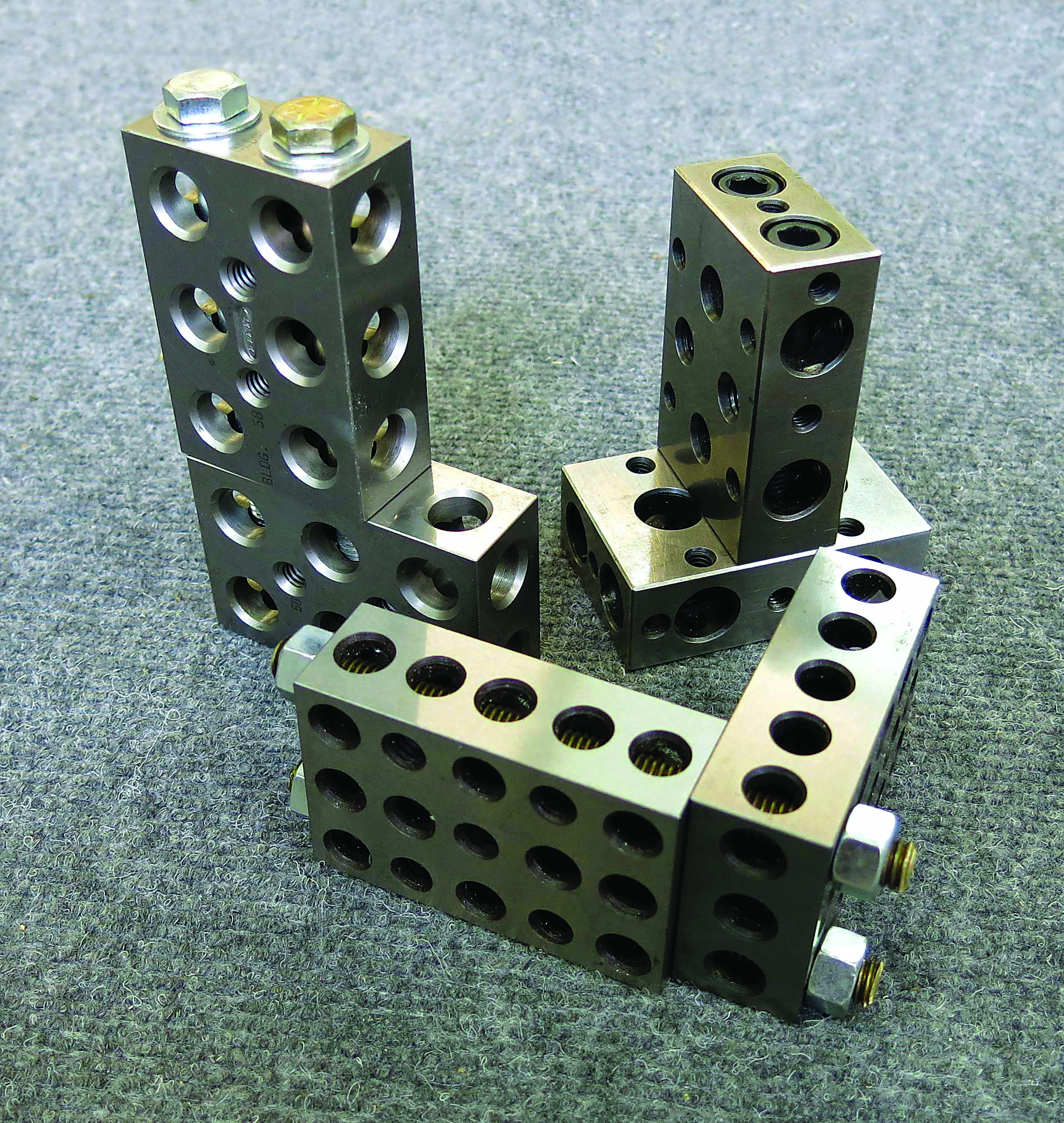

The dirty little secret about commercially available blocks is that their hole patterns severely limit the ways the blocks can be configured. When first glancing at Figure 2, for example, it appears the holes should allow many possible assembly configurations, but the configurations are limited. For example, the hole patterns don’t match or, when joined, two blocks don’t come together at 90°.

Figure 3. An example of a universal configuration that’s possible with 1-2-3 blocks.
Also, many of the hole configurations allow only through-bolting, resulting in the fastener sitting above the working surface of the block. This fastener interference limits the block’s setup applications.
To unlock the potential of these humble setup tools, the blocks should have the ability to be connected orthogonally and axially in a series. To do this requires rethinking how they fasten together. For straightforward manufacturing, let’s limit ourselves to a small number of easy-to-produce, basic hole types. We can thread a hole, drill a through-hole to create fastener clearance and add a feature, such as a counterbore, that sets a fastener below the surface.
Figure 3 shows a possible configuration with universal 1-2-3 blocks. I call these “Renzetti universal blocks,” after the name of the toolmaker who first showed them to me. There are no protruding fasteners; all connections are made below the blocks’ working surfaces.
These universal blocks have an array of counterbored and threaded holes on a ½” (12.700mm) pitch. At the bottom of every counterbore is a ¼-20 threaded hole.
The secret to these blocks is the captive fasteners that allow the user to connect one threaded hole directly to another. Just drop one of the modified captive-socket head cap screws down a counterbore and thread it through the first block. After the fastener passes through the thread, it can turn freely on the relieved section of the captive screw. The user now can thread this into the next block’s threaded hole and make a flush, hidden connection.
You can’t buy universal 1-2-3 blocks, at least not yet. If you want some, you will have to make them.
