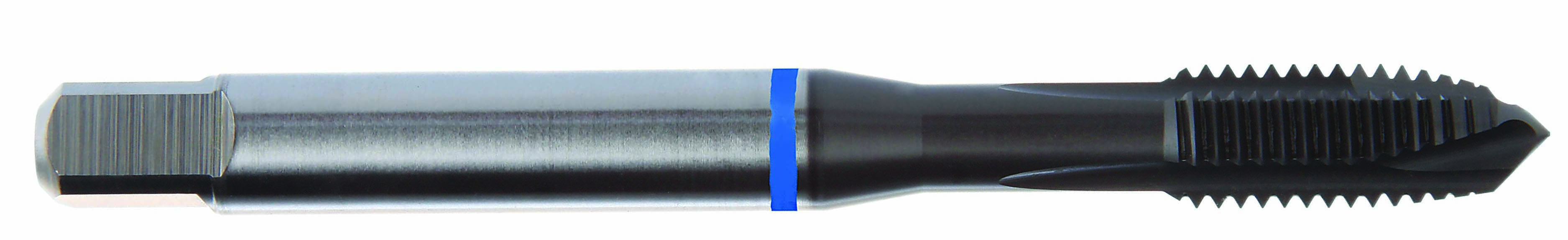

When tapping stainless steel, the blue ring Shark tap reduces axial forces and torque compared with conventional taps, according to Dormer Pramet. Image courtesy of Dormer Pramet
“The material wants to stick to the tool, makes the tool spin in the part and makes the part harder,” he said. “Workhardening is the No. 1 challenge with stainless steel.”

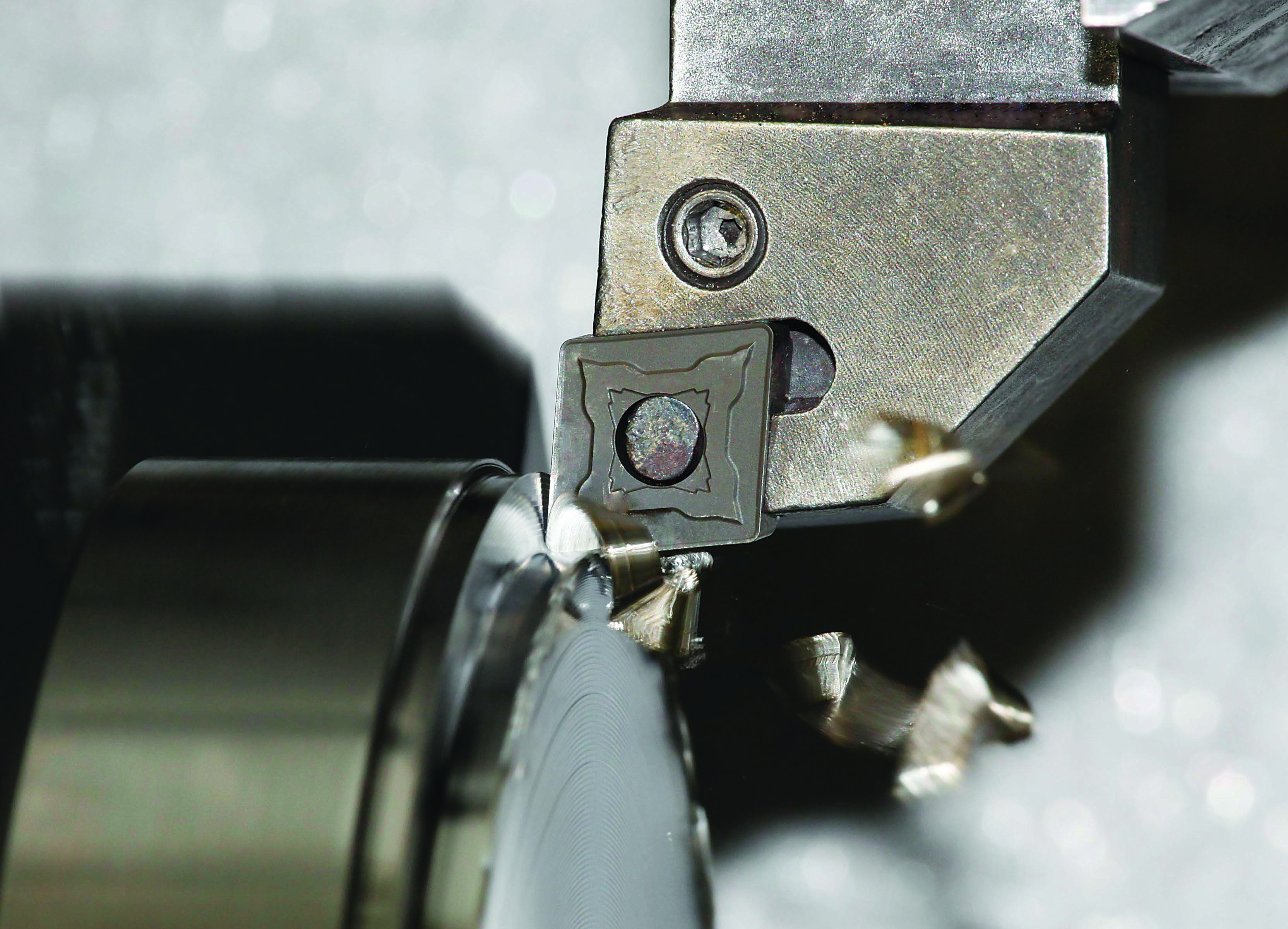

Additionally, high machining parameters can cause heat to transfer into a cutting tool and increase wear, according to Dormer Pramet. The thermal conductivity of stainless steel, nickel and titanium tends to be low. But with the high feeds required during machining, the cutting edge quickly can become overheated, shortening tool life. Large tools dissipate more heat during machining than smaller ones, Dones said.
Dormer Pramet has a range of turning tools for stainless steel. Image courtesy of Dormer Pramet
To remove heat from a tool/workpiece interface while helping chip breaking and improving the dimensional stability of the part, a generous flow of metalworking fluid often is recommended when machining stainless steel. Coolant can be applied through the spindle and tool or in a flood arrangement. However, milling with a tool grade that’s not optimized to resist the effect of constant temperature changes at the cutting area causes heat stresses on the tool, resulting in thermal cracks.

The toolmaker offers the Dormer-branded blue ring Shark tap for threading stainless steel. The tap can be coated with the company’s Super-B, a hard lube TiAlN coating that prevents chips from adhering to the flutes, Dones said. He added that the tap has a lot of back taper to increase sharpness and make it easier to break through a hole.
To increase tool life by reducing torque levels, the toolmaker recommends pre-drilling a hole 0.1 mm (0.004") larger than recommended when tapping stainless steel.

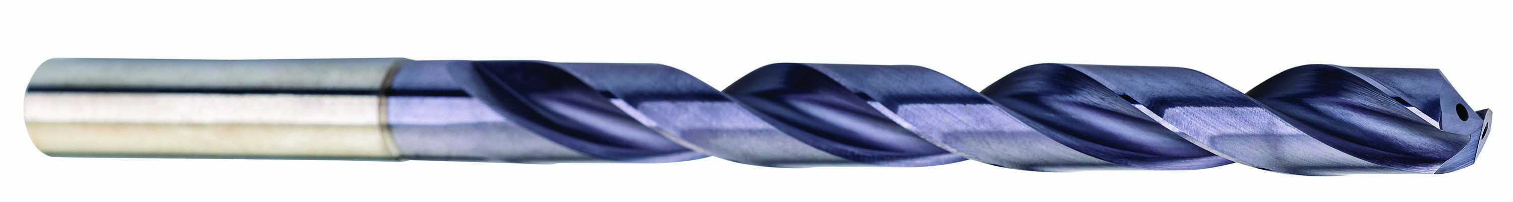

Another Dormer-branded tool designed for stainless steel is the Force M drill, which has a micrograin carbide substrate and a multilayer TiAlN coating. The drill has an S-shape, modified four-facet, split-point geometry to reduce cutting pressure with honed corners and cutting edges so they do not chip when starting a hole, Dones explained.
“When you look at the front tip, it has a 140-degree angle,” he said. “That’s our high-performance, go-to drill for stainless steel.”
