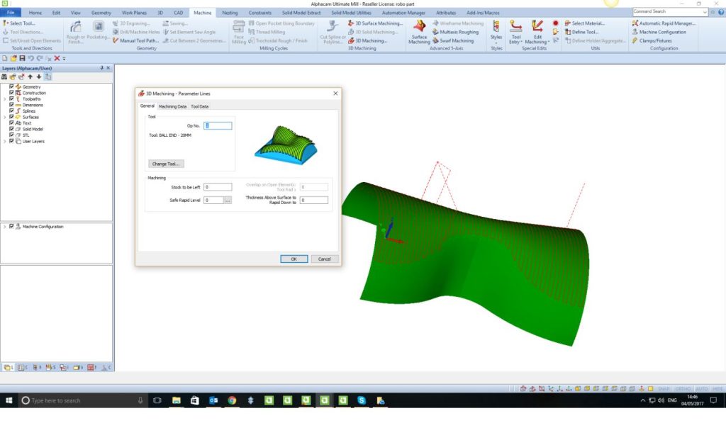

The new release also continues Alphacam’s theme of improving user experience by updating many Dialog boxes, including Profiling, 3D Machining, Lathe Turning Cycles and Stone, providing a more intuitive and consistent approach across the modules, to include new Images, Tooltips and Help Links.
Lathe Turning Cycles benefit from these new style dialogs for Facing, Diameter Roughing, Face Roughing, Contour Roughing and Twin Turret Balance Roughing – again, to include new Images, Tooltips and Help Links.
