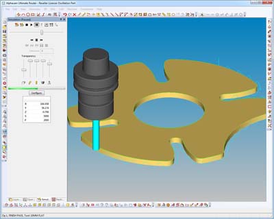

A host of new functionality has been unveiled in the latest release of Alphacam CNC software from Vero Software. Benefits to be gained by using Alphacam 2013 R1 include reduced programming time and material wastage, and improved material surface finish, part quality and tool life.
Tool Path Oscillation: A sinusoidal or zig-zag up and down movement can be applied to any contour toolpath, utilising more of the effective cutting length of the tool used. This improves the surface finish and extends the tool life. Oscillation pitch and height can be easily set, edited and saved as a machining style for future ease of use.
