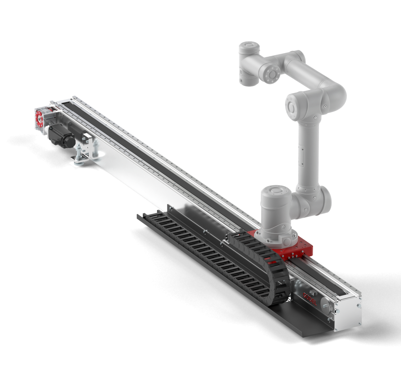

Cobomover
The CoboMover extends the working range of robots up to 5 meters (16.4ft), allowing them to operate multiple workstations and perform a variety of tasks without manual repositioning.
The CoboMover extends the working range of robots up to 5 meters (16.4ft), allowing them to operate multiple workstations and perform a variety of tasks without manual repositioning. The new track is compatible with over 60 cobots and small traditional robots and offers mounting positions at 0° and 180°. The maximum payload, including robot weight, is 78 kg (172 lbs.) with a drive system utilizing a toothed belt and Güdel’s HPG045 angular gearbox. Available stroke lengths include 1000, 2000, 3000, 4000, and 5000 mm. The CoboMover has a maximum speed of 2 m/s and a maximum acceleration of 2 m/s², providing a repeatability of ± 0.05 mm.
