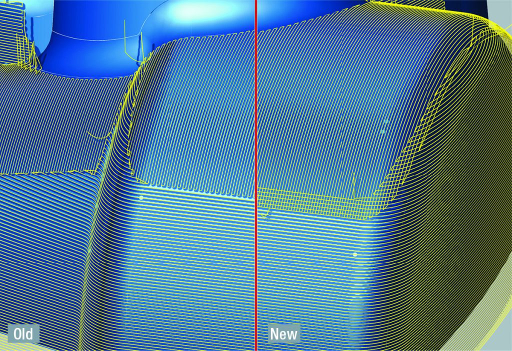

New hyperMILL 2018.1 functionality includes an enhancement to the "soft overlap" feature (pictured) for blending machining marks found between steep and flat areas, or located at the boundaries of rest machining regions. Using this enhanced feature, the milling tool is briefly lifted to blend milling paths into another, preventing visible transitions from being generated, resulting in better surface quality.
