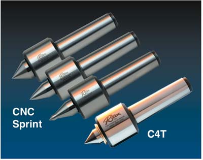

Riten Industries Inc. says its redesigned CNC Sprint series of live centers feature accuracy guaranteed to +/- 0.00004". Developed for today's aggressive high-horsepower turning and grinding, the new design allows deeper cuts, better surface finish and extended service life, according to the company. CNC Sprints are available in standard, tracer and long points in 4 and 5 Morse taper. They can support workpieces weighing up to 5,000 lbs. at speeds up to 6,000 rpm. C4T live centers incorporate the performance benefits of the Sprint design, with the addition of a proprietary frictionless labyrinth bearing isolator seal, which provides permanent bearing protection. The C4T is especially suited for operations requiring high pressure or flood coolants.
