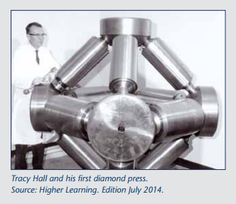

So it is no wonder that in 1954 engineer Tracy Hall was the first who succeeded in growing synthetic man-made diamonds in the U.S. using a specially developed high-pressure press. When General Electric first marketed these synthetic granulated diamonds, with sizes of approximately 170 microns, under the brand name “Man Made Diamond” in 1957, it was one more step towards another technical revolution, which, to this day, is affirmed through new innovations. Once again, it was Tracy Hall who ‐ in 1967/68 -­ implemented the idea to bake very fine diamond grains with carbide as a carrier material during synthesis. He was successful: The first step towards a so-called polycrystalline synthetic diamond cutting material had been accomplished.

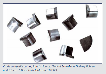

EDG, or electrical discharge grinding (for dividing the round plates, which at first had a diameter of approximately 3.2 mm) had not yet been discovered. Therefore, the carbide had to be scored with electro-­plated diamond cutting discs
to be able to break off either 90 or 60 degree segments afterwards.

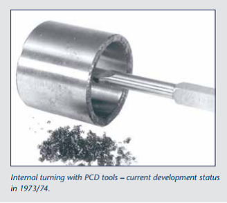

It was in the spring of 1974, shortly before the Hanover Trade Show,  the second year after the first PCD presentation. Since the introduction of PCD for manufacturing copper commutators, we had practiced PCD turning instead of grinding and had tried to win new customers among aluminum processing companies such as Westinghouse, Voith, Solex and Oechsle, an enthusiastic PCD customer, which is still surprising to me today.

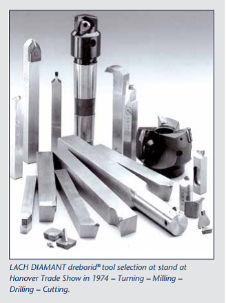

This new business segment, which had been growing rapidly within only a few months, also influenced the strategic planning at LACH DIAMANT. A newly finished industrial building, initially meant for the similarly booming branch of diamond and Borazon CBN grinding wheels, was turned into the first production facility for PCD tools. From now on,
LACH DIAMANT PCD tools were marketed under the registered name dreborid. At that time, the grinding wheel production moved into a neighbor building, a large facility that happened to become vacant and stayed there until 1984 when we moved to Donaustrasse in Hanau.

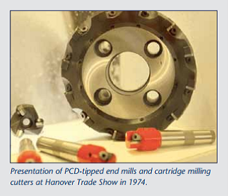

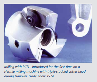

The highlight at our trade show stand in1974 was therefore PCD inserts for turning and milling. PCD milling was demonstrated as a new technology on a Hermle milling machine with 5,000 rpm and equipped with a triple-­studded
cutting head. Aluminum and Duroplast parts, as well as composite materials, were milled.
