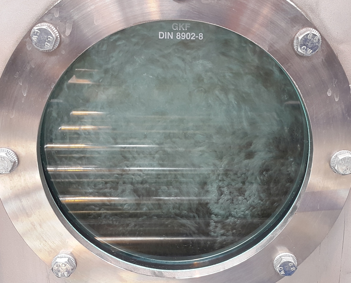

Besides the right cleaning fluid, the process technology - ultrasonics in this case - plays a vital role to reliably and quickly reach cleanliness specifications.

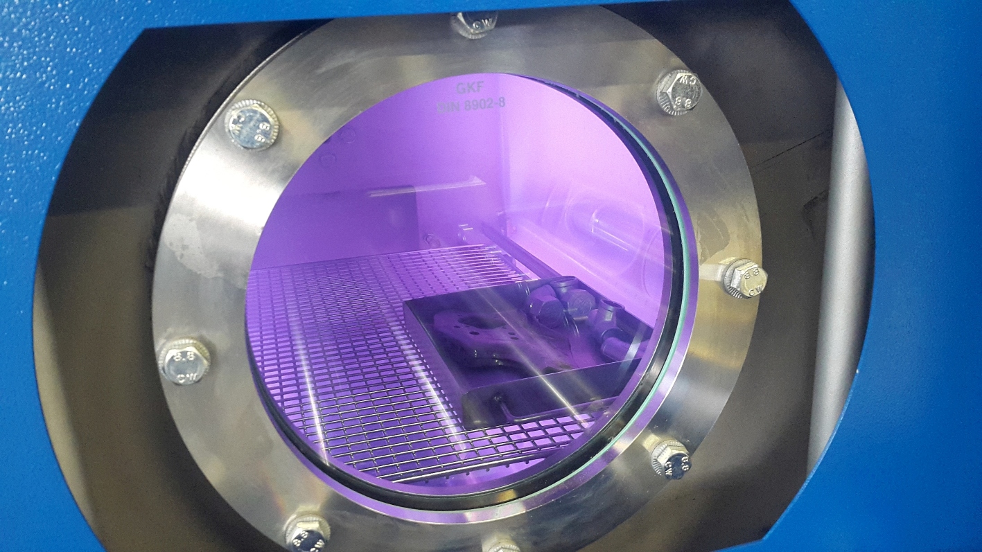

By integrating two cleaning processes in one system, such as wet-chemical and low-pressure plasma cleaning, quality, cost and cycle times can be optimized.
