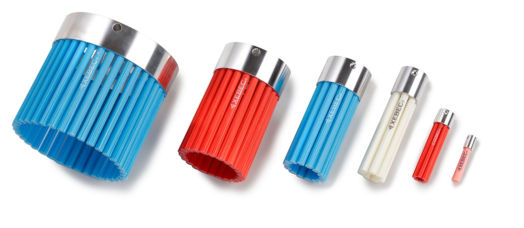

Xebec brushes made from ceramic fiberDeburring and finishing are still predominantly manual processes for many manufacturers and job shops. However, the results can be inefficient and inconsistent. Doing this by hand takes a lot of time and pulls employees away from more productive activities. Then, if the final product isn’t to spec after spending all of that time and energy, it might be scrapped.
It’s an unfortunate, often daily nuisance that manufacturers have come to terms with. But today, there are new technologies, such as integrated solutions with ceramic fiber brushes, that automate deburring and finishing that result in a precise product in a matter of seconds, and its return on investment is fast enough to warrant the cost.
