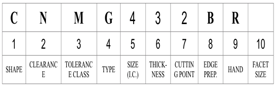

According to ANSI B212.4-2002 standard, identification of the indexable insert includes 10 positions denoted by a capital letter. Each position (from 1 to 10) defines a characteristic of the insert in the following order:
    1. – Shape;
    2. – Clearance;
    3. – Tolerance class;
    4. – Type;
    5. – Size;
    6. – Thickness;
    7. – Cutting-point configuration;
    8. – Edge preparation;
    9. – Hand;
    10. – Facet size.

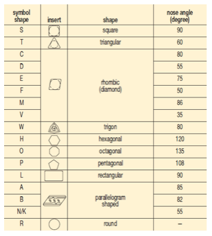

1. Shape
There are 16 standard shapes of indexable inserts, and each shape is identified by a capital letter as follows (Figure 1):
A – Parallelogram 85°;
B – Parallelogram 82°;
C – Diamond 80° (Rhombic);
D – Diamond 55° (Rhombic);
E – Diamond 75° (Rhombic);
H – Hexagon 120°;
K – Parallelogram 55°;
L – Rectangle 90°;
M – Diamond 86° (Rhombic);
O – Octagon 135°;
P – Pentagon 108°;
R – Round;
S – Square 90°;
T – Triangle 60°;
V – Diamond 35° (Rhombic);
W – Trigon 80°.

Figure 1: Kennametal Inc. Insert Shape Identification System. Image courtesy of Edmund Isakov.

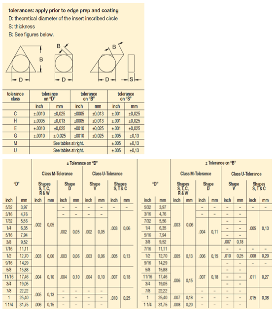

3. Tolerance class
There are 14 tolerance classes that control the indexability of the inserts. Each class is denoted by a capital letter. Letters for tolerances are A, B, C, D, E, F, G, H, J, K, L, M, U and N.
Tolerances on dimensions (± from nominal) are denoted by letters A, B and T. Dimension A is the nominal inscribed circle (I.C.) of the insert. Dimension T is the thickness of the insert. For pentagon, triangle and trigon shapes, dimension B is the insert height, i.e., the distance between one side and the opposite corner (Figure 2).
For all other polygons, dimension B is the distance, measured along the bisector of the rounded off corner angle and a gage roll of nominal I.C. size tangent to the two sides opposite the corner (Figure 2). For example, if a tolerance letter is H, tolerances on dimensions (± from nominal) are: 0.0005″ on dimension A, 0.0005″ on dimension B and 0.001″ on dimension T.

Figure 2: Kennametal Inc. Tolerance Identification System. Image courtesy of Edmund Isakov.

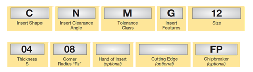

5. Size
The fifth position is a significant one- or two-digit number indicating the size of the inscribed circle (I.C.) for all inserts having a true I.C. such as Round, Square, Triangle, Trigon, Pentagon, Hexagon, Octagon, and Diamond. This position designates the number of eighths of an inch in the nominal size of the I.C. It will be a one-digit number when the number of eighths of an inch in the I.C. is a whole number: 1 – 1 ⁄ 8″; 2 – 1 ⁄ 4″; 3 – 3 ⁄ 8″; 4 – 1 ⁄ 2″; 5 – 5 ⁄ 8″; 6 – 3 ⁄ 4″; 7 – 7 ⁄ 8″;
8 – 1″; 10 – 1-1 ⁄ 4″.
It will be a two-digit number carried to one decimal place when it is not a whole number: 1.2 – 5 ⁄ 32″; 1.5 – 3 ⁄ 16″; 1.8 – 7 ⁄ 32″; 2.5 – 5 ⁄ 16″.
On rectangular and parallelogram inserts, the width and length dimensions are used in place of the I.C. A two-digit number designates the sizes of these inserts. The first digit indicates the number of eighths of an inch in the width and the second digit indicates the number of fourths of an inch in the length of the insert.
6. Thickness
The sixth position is a significant one- or two-digit number indicating the number of sixteenths of an inch in the thickness of the insert. It is a one-digit number when the number of sixteenths of an inch in the thickness is a whole number: 1 – 1 ⁄ 16″; 2 – 1 ⁄ 8″; 3 – 3 ⁄ 16″; 4 – 1 ⁄ 4″; 5 – 5 ⁄ 16″; 6 – 3 ⁄ 8″; 7 – 7 ⁄ 16″; 8 – 1 ⁄ 2″; 9 – 9 ⁄ 16″; 10 – 5 ⁄ 8″.
It is a two-digit number carried to one decimal place when it is not a whole number: 1.2 – 5 ⁄ 64″; 1.5 – 3 ⁄ 32″; 2.5 – 5 ⁄ 32″; 3.5 – 7 ⁄ 32″.
7. Cutting-point configuration
The seventh position indicates the cutting point configuration: a radius or a facet. In the case of a radius, the number indicates how many of 1 ⁄ 64 of an inch in the radius: 0 – sharp corner (0.002″ max. radius); 0.2 – 0.004″; 0.5 – 0.008″; 1 – 1 ⁄ 64″; 2 – 1 ⁄ 32″; 3 – 3 ⁄ 64″; 4 – 1 ⁄ 16″; 5 – 5 ⁄ 64″; 6 – 3 ⁄ 32″; 7 – 7 ⁄ 64″; 8 – 1 ⁄ 8″; 10 – 5 ⁄ 32″; 12 – 3 ⁄ 16″ 14 – 7 ⁄ 32″ = 14; 16 – 1 ⁄ 4″; X – Any other corner radius.
In case of a facet, two letters are used. The first letter designates the facet angle: A – 45°; D – 60°; E – 75°; G – 87°; P – 90°; Z – Any other facet angle. The second letter designates the facet clearance angle:

Understanding the Identification System for Indexable InsertsExample identification chart of the indexable insert (Inch Mode). Image courtesy of Edmund Isakov.

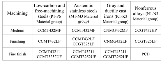

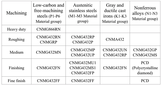

Inserts selection depends on workpiece material, chip control, surface finish, tool life, and the machine tool’s power and torque requirements. One of the commonly used indexable inserts for general turning is CNMG 432.
Due to the magazine’s space limitations, the authors provide the following tables showing most popular Kennametal’s indexable inserts only for general turning of steel, cast iron, and nonferrous alloys. These tables don’t cover all Kennametal chip breakers. (Figure 4 and Figure 5 also show Kennametal Inc. insert identification system and chip breaker identification system respectively.)

Table 1: Negative indexable inserts. Image courtesy of Edmund Isakov.

Table 2: Positive indexable inserts. Image courtesy of Edmund Isakov.

Figure 4: Kennametal Inc. Insert Identification System (Metric Mode). Image courtesy of Edmund Isakov.

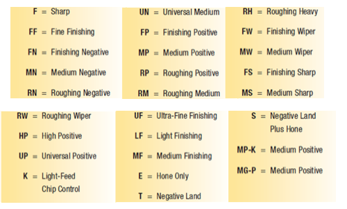

Figure 5: Kennametal Inc. Chip Breaker Identification System. Image courtesy of Edmund Isakov.

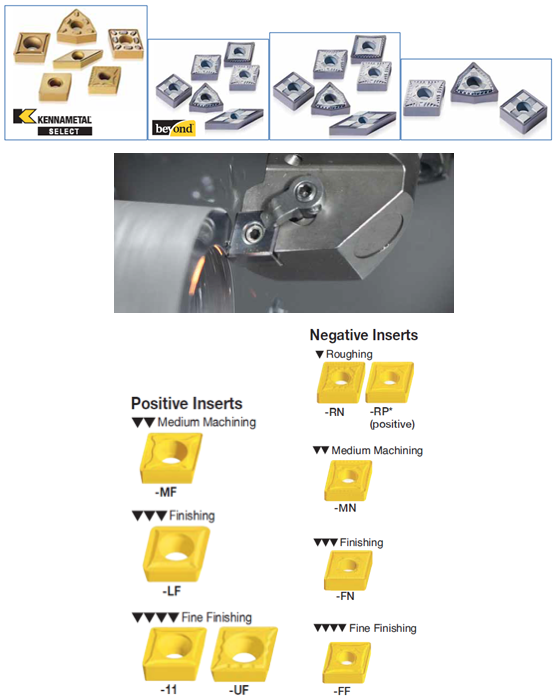

Figure 6: Kennametal Inc. Negative and Positive Inserts. Image courtesy of Edmund Isakov.
