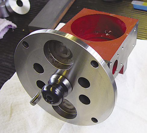

BIG%20Kaiser_5_sides_access.tif
Courtesy of BIG Kaiser Precision Tooling
A workpiece with five-sided access mounts to a baseplate with a BIG Kaiser zero-point knob and timing pin.

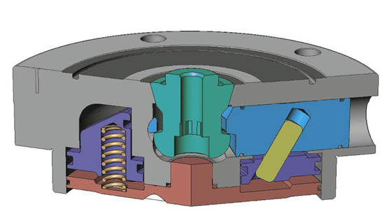

esm_176-02.tif
Courtesy of Big Kaiser Precision Tooling
A zero-point clamping system from BIG Kaiser features a clamping wedge lock, or knob, (turquoise in this image) gripped in a chuck via a self-locking mechanical clamping system. Spring pressure drives wedges against the knob; air pressure is used to compress the springs and release the knob.
