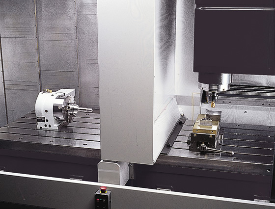

Mazak Trunnion Table.tif
Courtesy of Mazak
A 5-axis approach for vertical machining centers that doesn’t have to be complicated and can boost productivity.

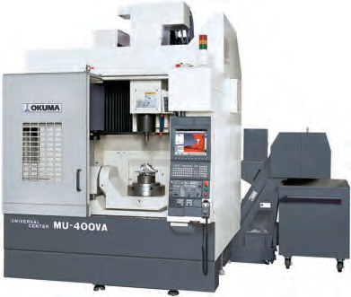

For these reasons, Okuma prefers to talk to potential customers about “universal machining,” Endsley said. “That focus on what we call ‘point-and-shoot’ 5-axis work tends to keep their attention. You position the C-axis, position the A-axis, and you drill a hole. Then you roll to the next position and do it again, or do some milling or whatever operation is required. That’s true universal machining.”
According to Endsley, 60 percent of parts machined worldwide also have a blind side—one that is not machined. “With a universal machine, that’s your locating point,” he said. “You can set that down on a table, roll the table around and attack five sides of that part. Again, that’s true universal machining—one setup and one complete part. “
Okuma’s MU VMC series is a good example of the types of machines that can be fitted with a tilting rotary table. They are sold with 400mm and 500mm tables to avoid potential accuracy issues associated with heavy workpieces. “As you get larger, the part weight can affect accuracy when you articulate the table,” Endsley explained. Okuma specs its tilt/rotary table accuracies at the maximum weight and, for table sizes of 800mm and 1,000mm, builds its Millac VH machines with articulating heads, he added. This eliminates any potential accuracy problems due to part weight.

Mazak offers several options for 5-axis VMCs. Its new vertical Integrex J machines, for example, are multitask machines that don’t provide full contouring capability, Birkle noted.
“We also want to provide shops with some way to automate their process,” he continued. “The vertical Integrex machines have two pallet changers that can integrate with our Palletech system and can provide substantial capability for unattended operation. So you have not only five-side milling, drilling, tapping and turning, but all those operations are consolidated with all the pallets and fixtures right in front of the machine. So what might otherwise take up a lot of floor space is brought down to one discrete manufacturing area.”

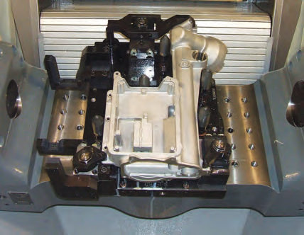

chiron part in fixture.tif
Courtesy of Chiron America
Switching from 3-axis and 4-axis to 5-axis Chiron machines enabled a Tier 1 automotive supplier to machine these power steering rack housings complete in a single clamping and hold position of the intersection point of primary bores on the part to ±40µm.

Okuma MU-400VA.tif
Courtesy of Okuma America
The MU400VA is typical of the “point and shoot” universal machines offered by Okuma. The MU series also includes a 500mm table machine.

Chiron’s Holtzhauer cited a Tier 1 automotive supplier machining two types of cast aluminum steering rack housings for electric and hydraulic power steering systems. The parts were initially produced across multiple setups on 3- and 4-axis machines supplied by Chiron, he recalled.
“Then the customer decided the shop had to hold the intersection point of the primary bores on the housing to within 40µm, with a 2.0 Cpk,” Holtzhauer said. “Basically, that means you can’t be off more than about 7µm to 10µm on each individual axis.”
Knowing that such absolute positioning accuracy was impossible to achieve using multiple setups, the shop initially tried to use a spindle probe to find the correct tool position for the second operation. The setup worked but added a substantial cycle time penalty.
Switching to 5-axis Chiron machines allowed machining of all four primary bores, plus finishing the other features, in one clamping, according to Holtzhauer. “The key was doing all the machining on one machine instead of three,” he said. “They were still doing all the same operations, so there weren’t big cycle time improvements and it still took three machines to get the same output. But the result was a much higher-quality part.” CTE

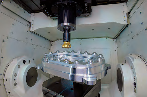

P+S Technik uses Haas 5-axis VMCs to machine bodies for its digital cameras.
Lights, camera, action!
The movie “Slumdog Millionaire,” which dominated the 2009 Academy Awards by winning eight Oscars, was the first movie shot mainly in digital format to receive the Academy Award for Best Cinematography.
The camera used to shoot “Slumdog” was the SI-2K Mini from P+S Technik GmbH, Munich, Germany. Founded in 1990, the company specializes in high-end digital cameras and equipment for the motion picture industry. In 2007, it developed the SI-2K Mini digital camera in cooperation with Silicon Imaging Inc., Niskayuna, N.Y. The SI-2K Mini is a complete digital movie recording system that combines flexibility with efficiency in production and processing. The camera has interchangeable hard drives and stores up to 4 hours of data. It also features a lightweight head housing a ⅔” CMOS (complementary metal oxide semiconductor) image sensor that can be separated from the camera body, so the camera’s “eye” can be hand-held or attached to a moving object.
The camera’s aluminum head is machined by P+S’s manufacturing division on a high-speed VF-3SS vertical machining center from Haas Automation Inc., Oxnard, Calif. Equipped with a Haas TR160 trunnion table, the machine enables milling of the parallel surfaces between the lens and the sensor location face to a tolerance of ±0.01mm, according to Richard Wagner, manufacturing division manager for P+S Technik. The head also requires production of a fine-pitch (M2×0.25) thread and other tight-tolerance features, and must look as good as it works, Wagner added.
