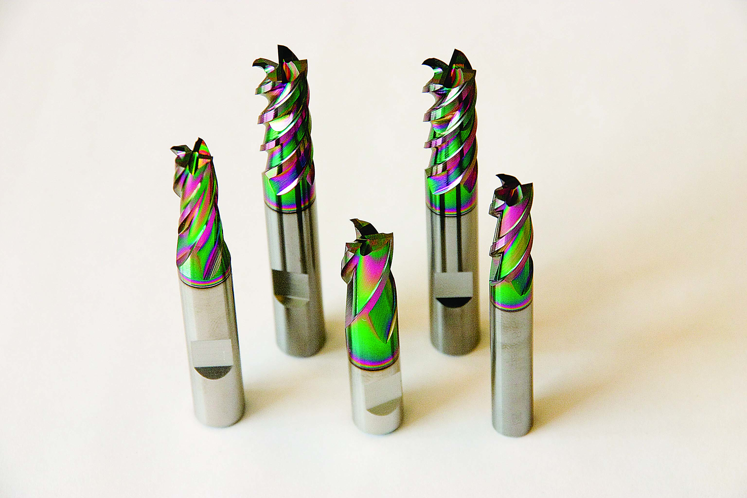

Endmills coated with a ta-C coating via circular arc CARC+ technology display the coating’s typical rainbow color pattern. All images courtesy of IHI Hauzer Techno Coating

DLC coatings, such as ta-C, have a certain degree of transparency. When the coating thickness is less than 1μm, tools will have rainbow colors due to an interference effect. As thickness increases, the color becomes gray-black.
