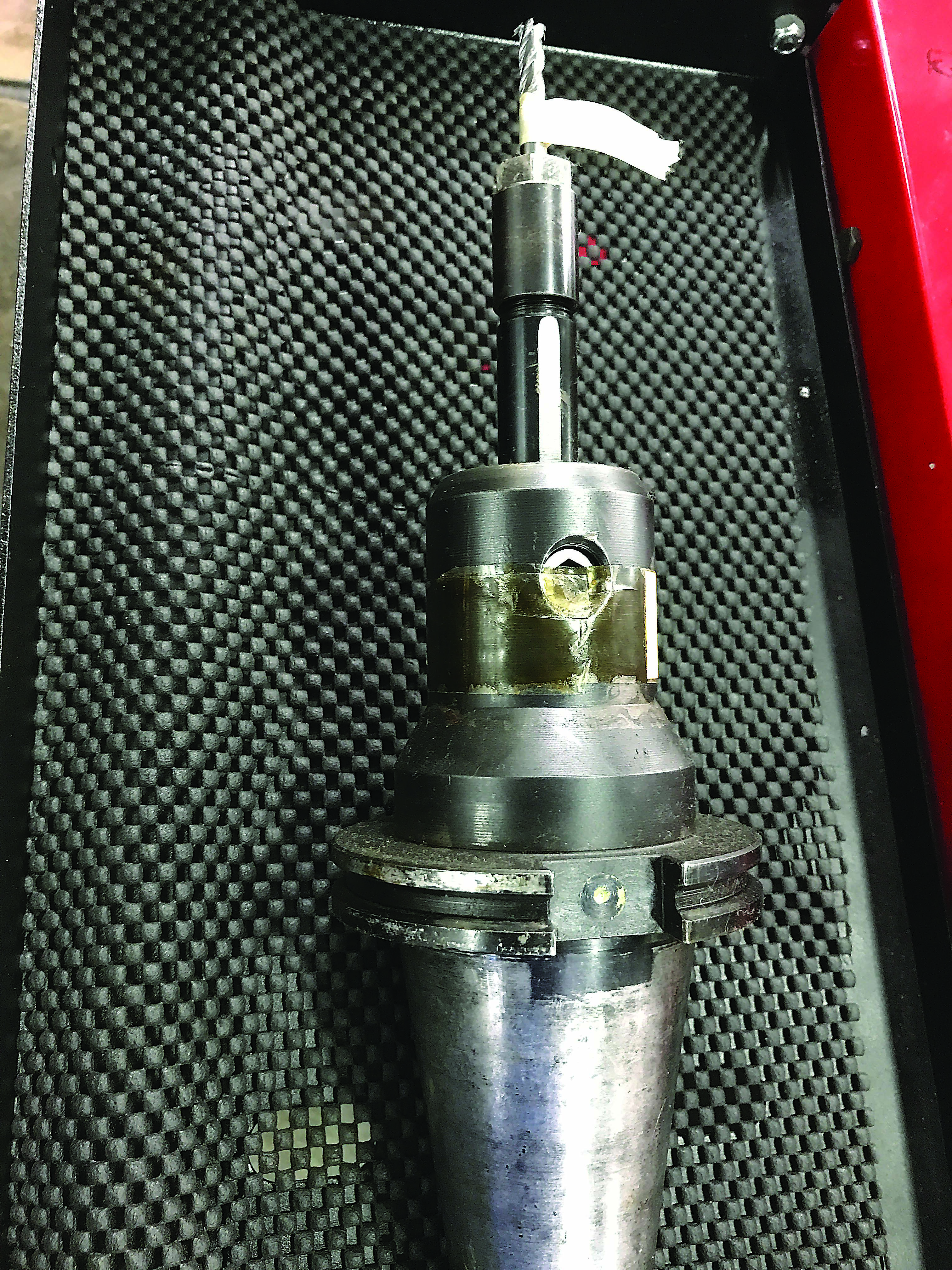

Spindle taper. Look at standards, including CT, HSK, BT, Capto and KM.

A little lean manufacturing goes a long way
If a toolholder’s taper looks like this, the inside of the machine spindle matches it.
Image courtesy of Stellar Industrial Supply
Total indicator runout of spindle. Determine if the machine’s spindle runout has been measured with a gage bar.
Retention knob torque. Note that a pull stud will have a maximum torque specification. Overtightening can damage the spindle and increase runout.
Draw bar tension. Is it within the minimum specs from the machine manufacturer? Is it checked and tracked on a regular basis?
