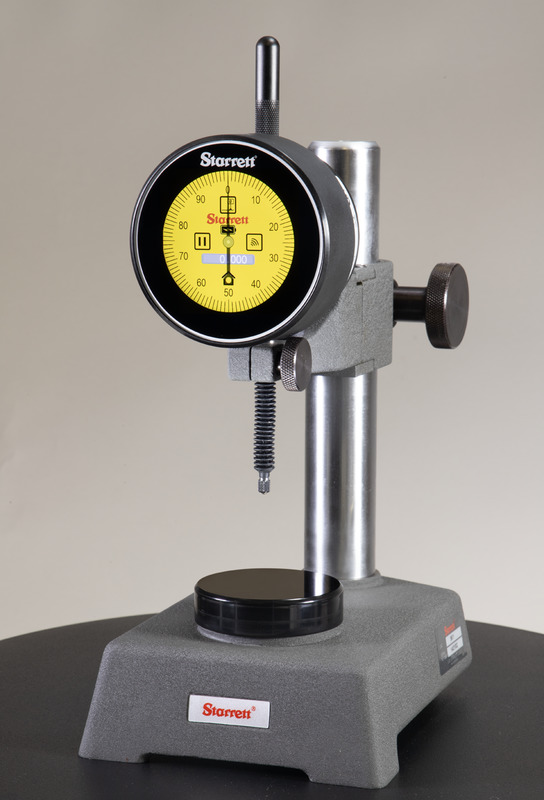

That versatile indicator was the Starrett W4900 Touch Screen Indicator from The L.S. STARRETT CO., manufacturer of precision measuring tools and gages, and metrology systems.

Built for quality labs, inspection areas, and in-process applications where access is not always available, Clinton said the W4900 is highly accurate, fast, intuitive, easy-to-use, and rugged. Its principal features include multiple resolution and color settings, digital and analog readouts in the same indicator, seven languages, and wireless output.
The big new thing with this is the touch screen and the digital dial face. The tool can be set up like any digital or analog indicator that Starrett makes. You can go to the English analog version or the metric analog version. It also gives you the ability to change graduations or the resolution going into the settings as well as intuitively change the settings.
“It can be both a traditional drop indicator – digital -- but it can also be a dial indicator,” Clinton said. “If we have a simple part and we want to measure the height of the part, that is a common easy function to do with an digital indicator in a comparator stand. However with the W4900, we can quickly swap modes to the dial face. Many of our customers prefer dials when probing the flatness of a part so they can watch the dial indicators' hand move.”

In addition to the hands-on demonstrations, a bank of W4900 Indicators were displayed and set up in a variety of configurations that were running continuously, taking measurements of a rotating crankshaft.
"They are all the same indicators, but they are just set up in different configurations," Clinton said, pointing to the devices. "We got them on a CAM shaft to show a little bit of movement. For instance, the first dial goes to yellow and then red when out of tolerance."
