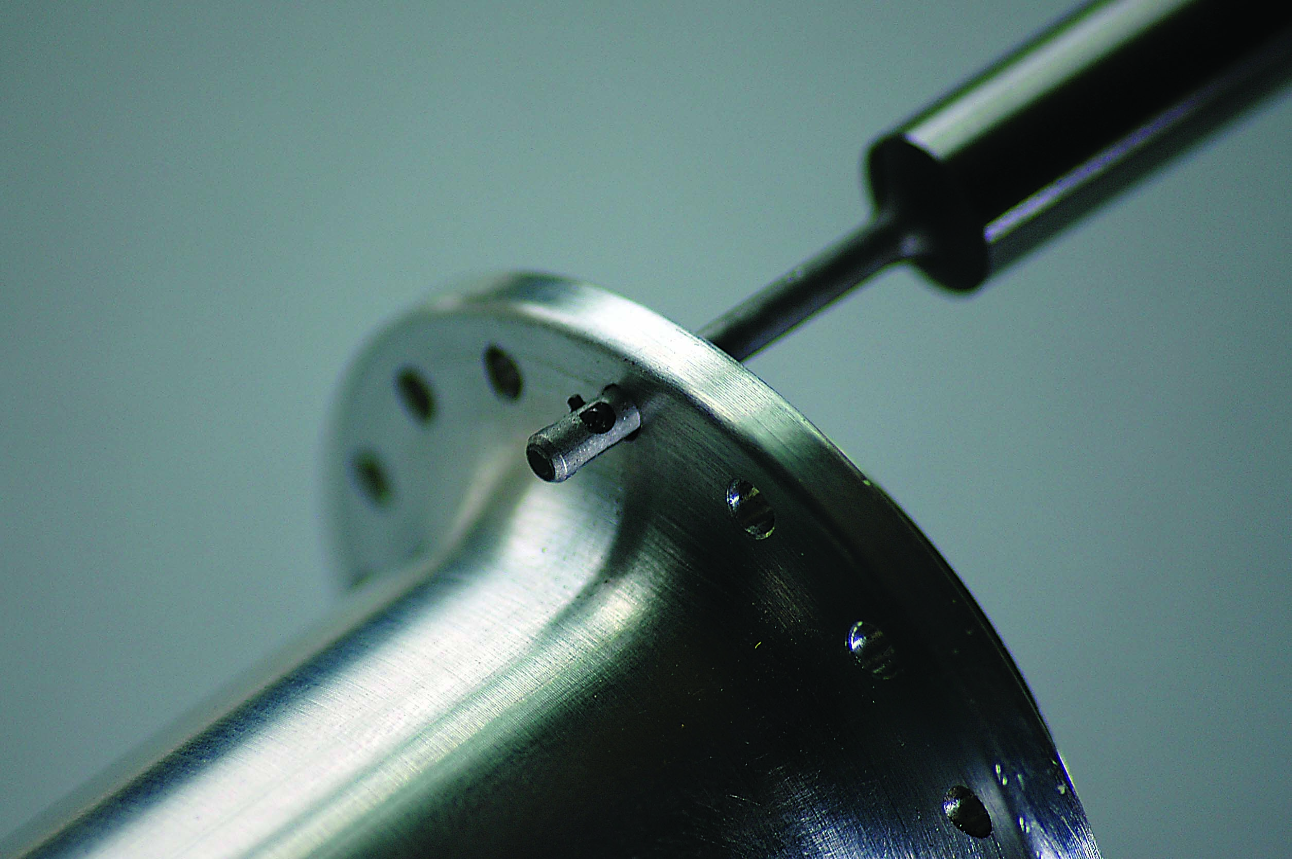

The ability to deburr both sides of a hole (above) in a single operation is a huge timesaver. Image courtesy of Whitney Tool
Two for One
“You don’t want to pay CNC machinists to deburr holes,” said Samuel Dean, director of sales and marketing at Whitney Tool Co. Inc., Bedford, Indiana. “You want to pay them to program and set up and maintain machinery, which means that the deburring — or as much of it as possible — is done inside the machining center where consistency is assured and there’s no chance of missing a hole. This is why it’s so important to convert manual deburring operations into automated ones so that shops can more efficiently utilize their production floor staff.”
One step in this conversion process is the use of Burr-Zit and Handi-Burr deburring systems from Whitney Tool, he said. Often referred to as clothespin tools, Burr-Zit deburrs the front and back of hole diameters from 1.98 mm to 25.4 mm (0.078″ to 1″) in a single in-and-out pass. The Handi-Burr line of spring-loaded deburring tools extends that diameter range to 50.8 mm (2″). Multiple lengths, geometries and coatings are available, and the Burr-Zit series can be purchased in kit form to cover a range of hole sizes.
Dean said Handi-Burr typically is reserved for manual deburring operations in a drill press or power tool while Burr-Zit is suitable for CNC and manual equipment. He also said both tool types are only for deburring, in that they produce a rounded edge. If a qualified, dimensionally accurate chamfer is needed, it should be machined using an actual milling cutter.

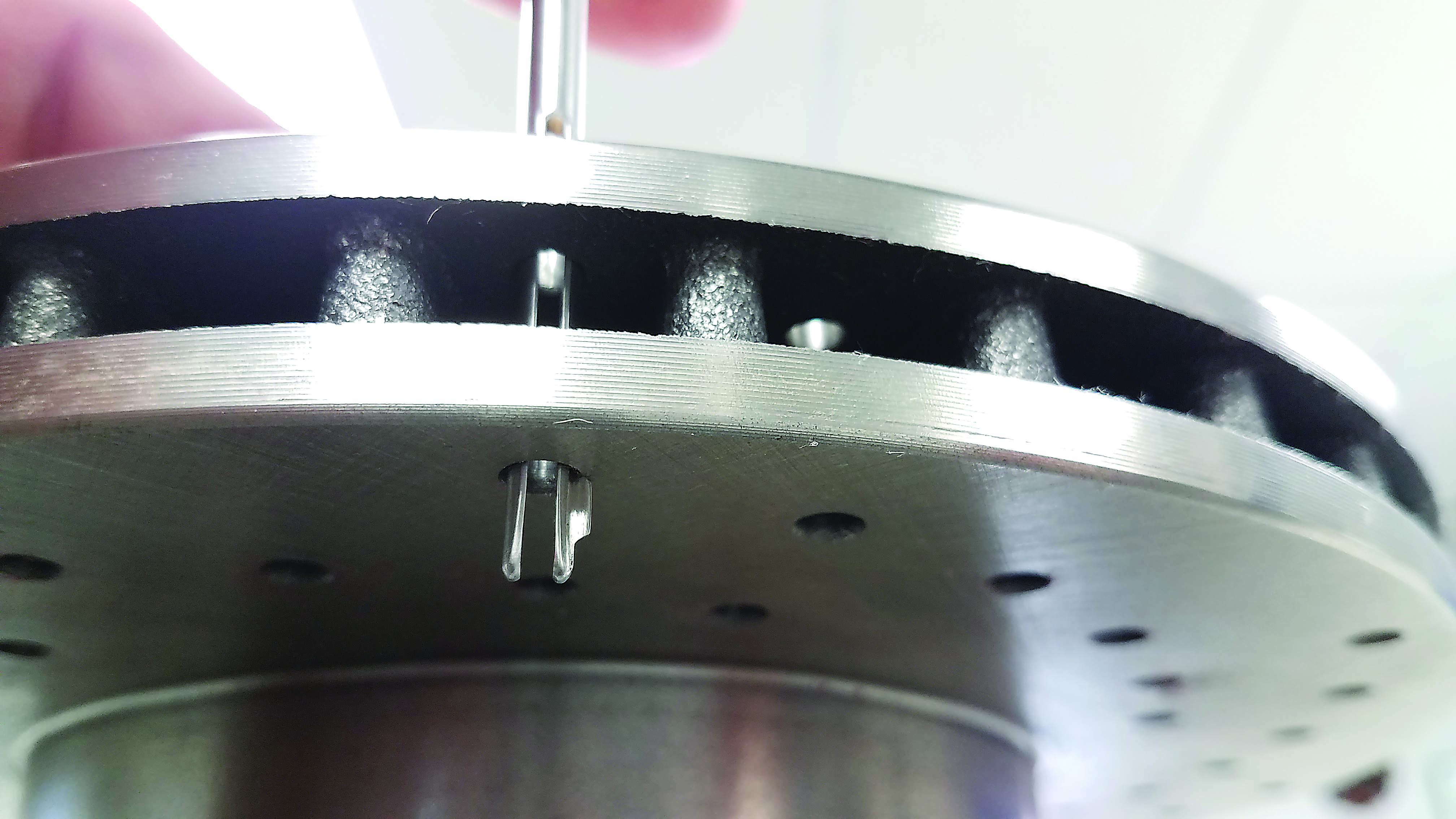

Matt Baumet, technical sales engineer at Heule Tool Corp., Loveland, Ohio, suggested several similar alternatives. The company’s Snap front and back chamfering tools, for example, feature a replaceable, spring-loaded blade and are intended for use with CNC machine tools while providing more accurate chamfering than tools for only
deburring.
“It depends on the hole size and material,” he said, “but you could expect to hold plus or minus a couple thousandths on a chamfer.”
Also available are the Cofa “universal deburring tool” for elliptical or contoured surfaces, the Defa adjustable chamfering tool and the X versions of Snap and Cofa for deburring cross-holes and intersecting bores.
“The Cofa and Cofa-X are specifically designed for irregular surfaces,” Baumet said. “Let’s say you’re deburring a hole drilled on an angled surface or a cross-hole in a piece of tubing. Here, the blade actually pivots in and out of the holder for continuous engagement. You get a nice, even chamfer all around the hole instead of the football shape you’d see using a standard chamfer tool.”

Using an automated deburring tool like the Cofa, tedious deburring of small parts by hand can be eliminated for maximum efficiency and burr-free parts. Image courtesy of Heule Tool

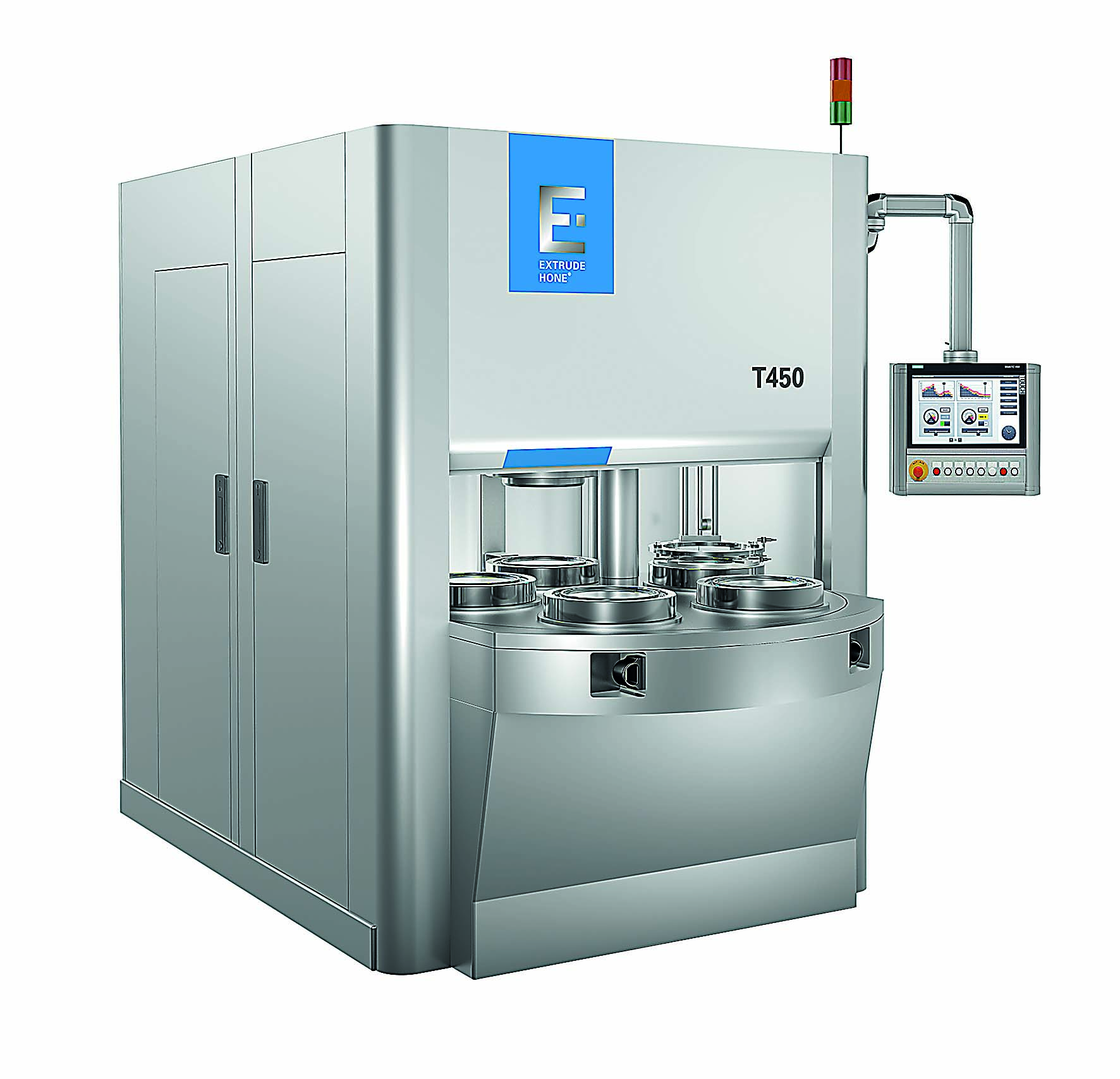

Imagine a process that can completely deburr a part in less time than it took to read this sentence — much less time. The thermal energy method removes burrs, flashing and trapped particles from practically any workpiece in just a few milliseconds. TEM works by placing a workpiece — or hundreds of workpieces — in a sealed, pressurized chamber, filling it with a mixture of methane gas and oxygen and then introducing a spark. The resultant explosion generates a 3,316° C (6,000° F) heat wave that instantaneously vaporizes burrs and loose matter but leaves the workpiece undamaged.
Bruno Boutantin, global marketing director for Extrude Hone LLC, Irwin, Pennsylvania, said suitable TEM applications include die castings and machined parts of all shapes and sizes, but the approach is popular in the heavy equipment industry. This popularity is due to TEM’s fast cycle times, consistency and cost-effectiveness. The method is often ideal for deburring manifolds and other large, high-volume components.

The T350 and T450 (pictured) thermal deburring machines offer a fast, cost-effective way to remove burrs and loose material. Image courtesy of Extrude Hone
“AFM uses a puttylike abrasive media that is forced under pressure through or around a workpiece, removing burrs and smoothing surfaces as it passes,” Boutantin said, “while ECM employs a shaped cathode and electrolytic fluid to quickly erode even stubborn burrs.”
