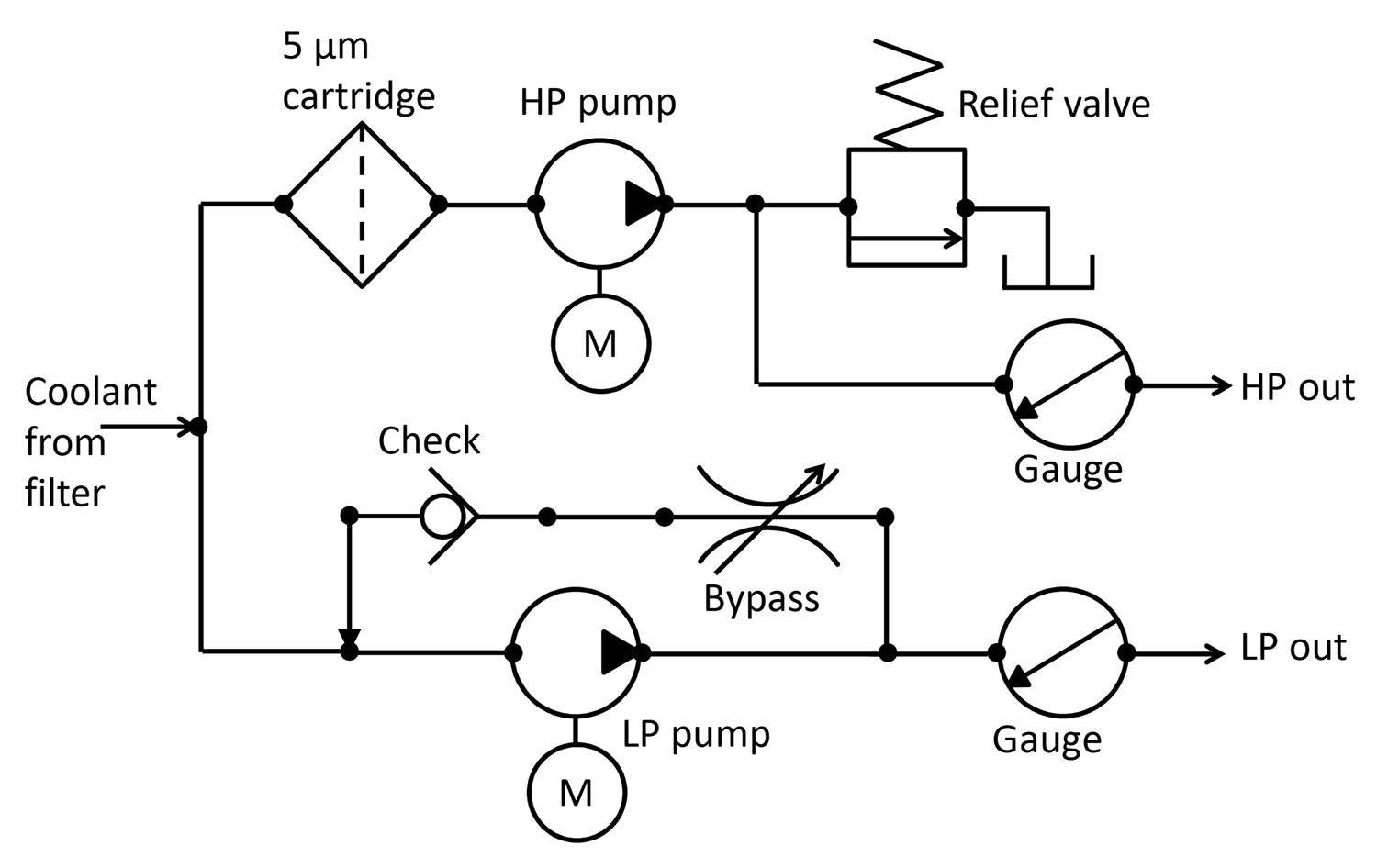

A more effective and less expensive approach is to incorporate two pumps in the coolant system. Work with both a low-pressure (60 to 300 psi, or 4.1 to 20.7 bar), high-flow-rate, centrifugal pump for cooling and a high-pressure, low-flow-rate pump for wheel cleaning, with nozzles of suitable aperture and width to apply the correct flow rate and pressure from each pump. The best strategy is to optimize the low-pressure system first. Then see if the wheel structure becomes loaded with chips before investing in a high-pressure scrubber nozzle and high-pressure pump.

A diagram of a dual-pump coolant systemfor grinding.
The block diagram (above) shows a dual-pump coolant system from Cool-Grind Technologies. Coolant from the central or individual-grinder coolant system is fed into the dual-pump metal enclosure and distributed to the inlet of each pump. A relief valve is fitted to the output of the high-pressure pump to control the pressure. This valve also guards against a blocked nozzle dead-heading the positive-displacement pump, leading to mechanical damage.
A bypass valve controls the pressure from the low-pressure centrifugal pump, which directs coolant to the tangential nozzle, with both circuits returning excess clean coolant to the filtration system. A 5µm cartridge filter in the high-pressure pump circuit minimizes the risk of blocking the small apertures of the scrubber nozzles.
The output pressures from the high-pressure and low-pressure pumps are displayed on gages located on the outside of the enclosure. The complete dual-pump system is easily integrated into the grinding machine control and power circuits. The unit has casters for moving it from one grinding machine to another. It is also fitted with quick-disconnect hose fittings.
