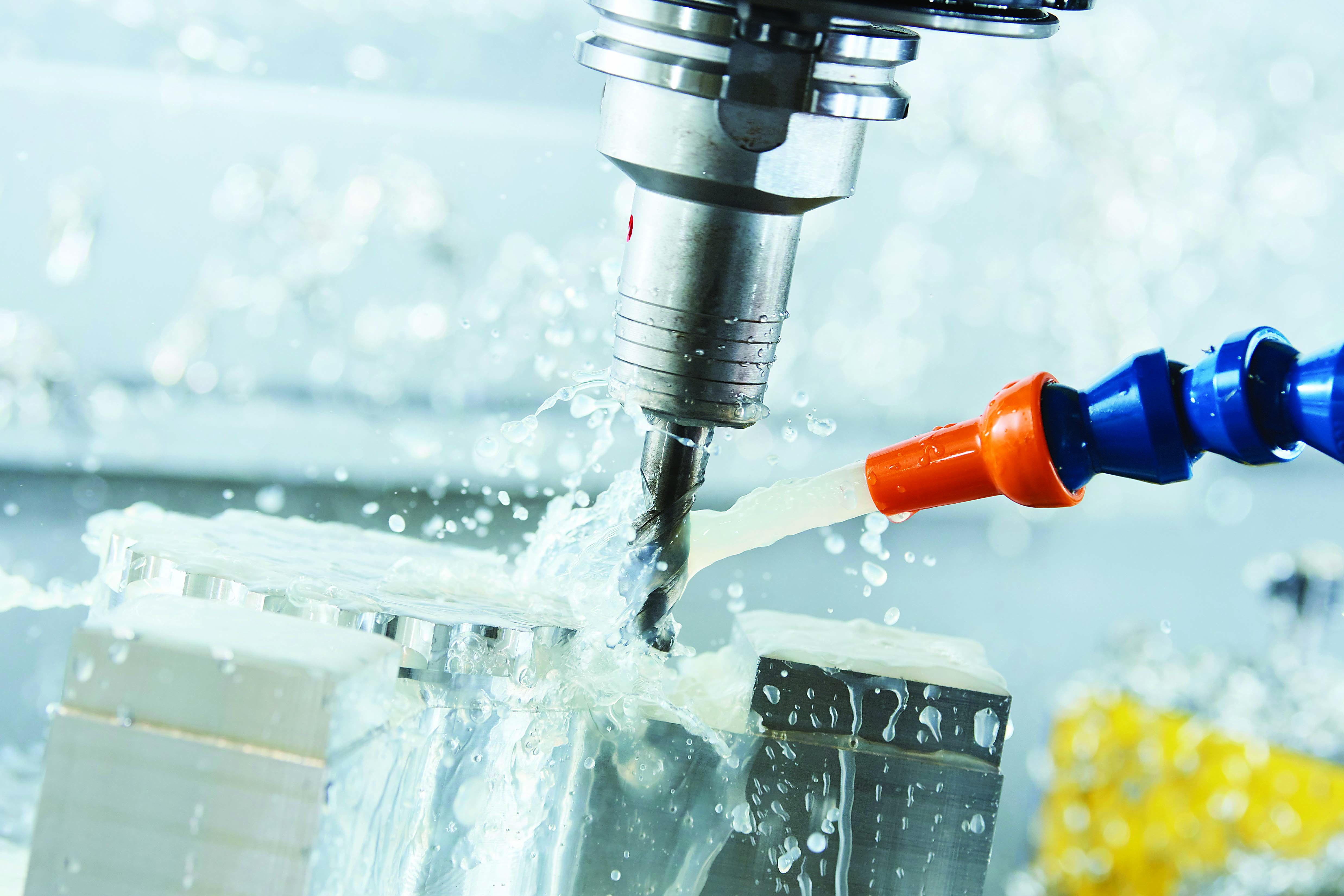

By preventing tools from exceeding critical temperature ranges during machining, coolant performs a pivotal function. However, cutting fluids are subject to deterioration over time as they become contaminated with tramp oils, metal fines and bacteria. If coolant deteriorates to the point where its lubricity becomes ineffective, tools dull prematurely, break frequently and fail to meet part tolerances for surface finish and size.
Further, as coolant breaks down, it damages not only machine tools but pumps, sumps and even electronic components. Machine parts and interiors become vulnerable to rust and corrosion, equipment surfaces suffer from abrasion, and tramp oil mist causes mechanical failures and prematurely clogs air filters.
