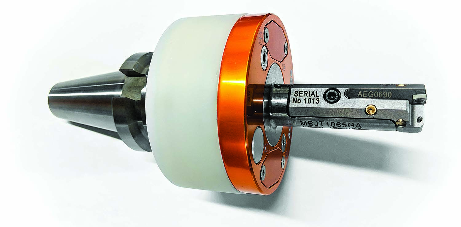

ActiveEdge is a precise, adjustable boring tool. Image courtesy of Rigibore

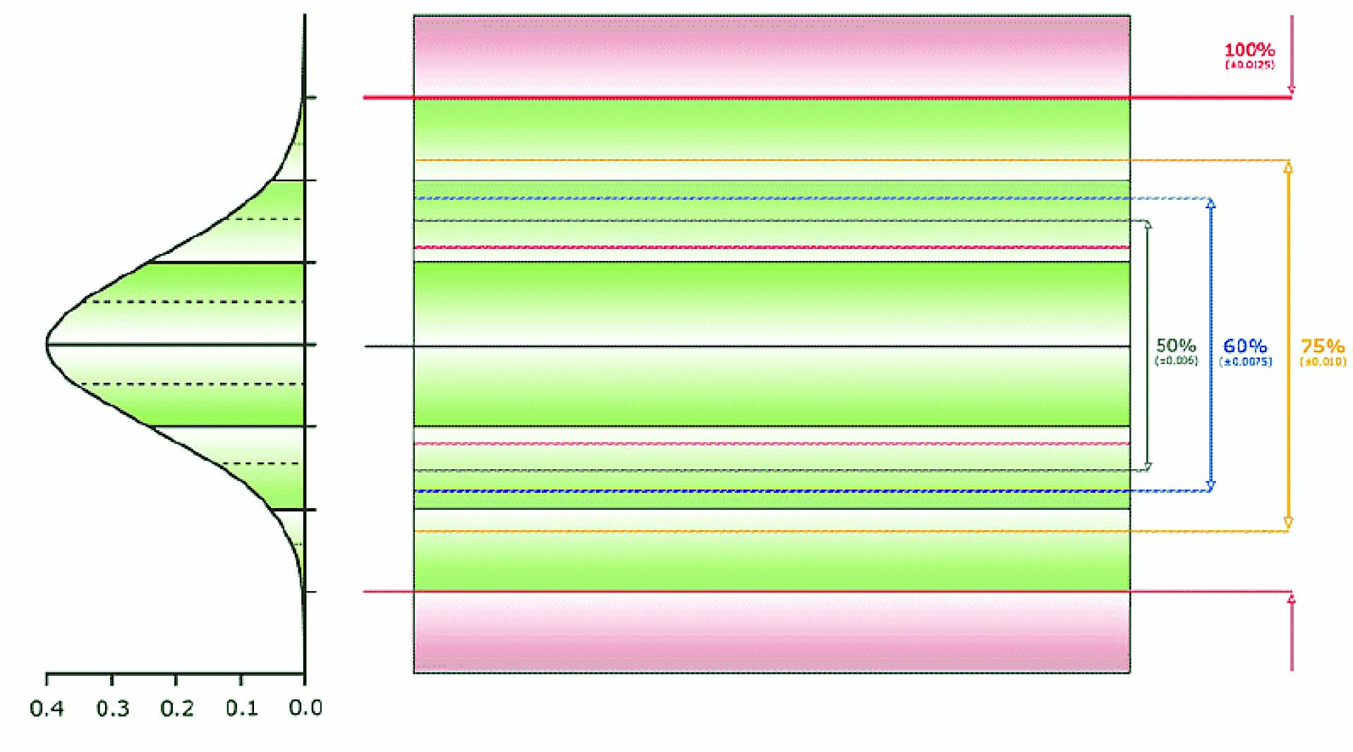

The blue line in the figure below represents the tolerance in a traditional boring operation. Because of the time, skill and risk involved in making an adjustment, operators often set the tool as high as possible, allowing machining to continue until the insert reaches the lower tolerance level.
While this maximizes the time spent between adjustments, the process sacrifices precision by using all the tolerance. This method of adjustment shows a high deviation of bore sizes, which are frequently outside the upper and lower tolerance limits, with minimal time operating at nominal tolerance.
With an automated boring system, adjustments are carried out based on information provided by accurate probing measurement. They are micron-level accurate and triggered when bore sizes reach the warning level. Other advantages include: automatic adjustments that remove the risk of human error; predetermined upper and lower warning limits; a lack of backlash adjustments; and adjustments that may be made in the machine carousel, reducing the need for and risks to an operator.
Ultimately, more frequent, smaller adjustments can be made (see the orange line in the figure below) compared with traditional operations (again, the blue line). Bore sizes have a low standard deviation from nominal diameter and a considerably higher Cpk.

Zenith is Rigibore’s completely automated solution to produce micron-accurate bores. This fine-boring system offers unparalleled savings and a tangible return on investment by reducing labor costs, eliminating scrap and supporting 24-hour production through lights-out manufacturing.
Regardless of their sophistication, modern CNC machines cannot automatically compensate the cutting edges of a boring tool. Rigibore’s ActiveEdge tooling, combined with in-process bore measurement, has overcome this problem. The Zenith system integrates ActiveEdge tools with in-process gauging to enable a machine controller to automatically compensate for insert wear, temperature changes and material inconsistency without manual intervention and without stopping manufacturing.
Rigibore refers to this process as closed-loop tool compensation, eliminating scrap and enabling organizations to meet precise tolerances and production targets in a consistent, repeatable manner.
