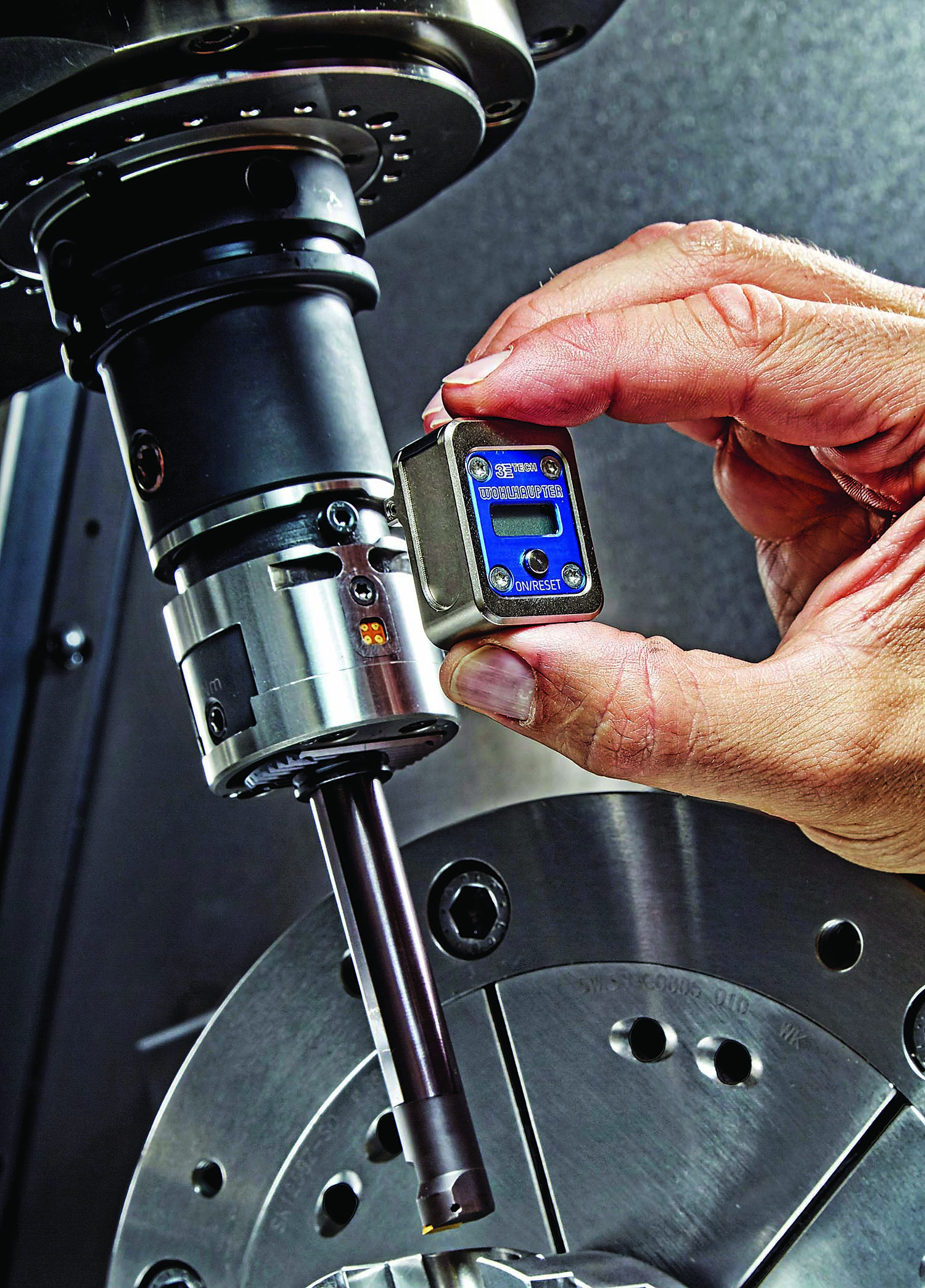

The 3E Tech digital display shows exact boring diameter adjustments.
The 3E Tech digital display shows exact boring diameter adjustments. Image courtesy of Allied Machine & Engineering

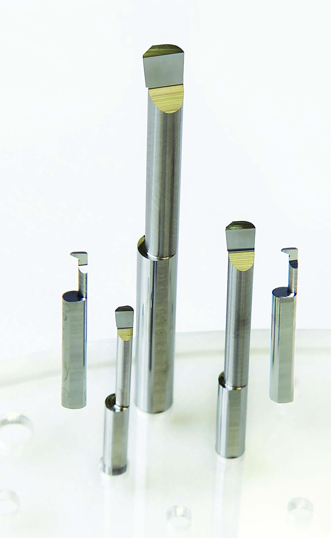

“Then if they’re using them up too fast, they’ll call and I’ll say, ‘You should probably bite the bullet and get a diamond-tipped bar for those materials because they’ll last a long time,’” he said. “Even though they’re quite a bit more expensive, the (number of) parts you get out of them can be phenomenal.”
White said machine shops cutting very abrasive nonferrous materials might get through 5,000 parts with a diamond-tipped boring bar compared with 10 or 15 with a solid-carbide bar.
So even though a solid-carbide bar costs $25 and a diamond-tip option costs $150, “your cost per piece is going to be way less,” he said.
The same is true, White added, of CBN-tipped bars, which are suitable for boring hardened steel.
Once again, in these applications “a lot of people will start out with coated carbide, and if they have a short run, that will get them through and give them a good finish,” he said. “But if the volume is high, then CBN is something to look at.”
In some cases, White pointed out that price considerations lead shops to the least expensive option: an uncoated boring tool. But when those customers cut metals like stainless steel and Inconel, Scientific Cutting Tools urges them to think longer term and opt for a coated tool. He reports that his company has had “great success” with a high-performance AlTiSiN coating called nACo, which provides excellent wear resistance and lubricity.

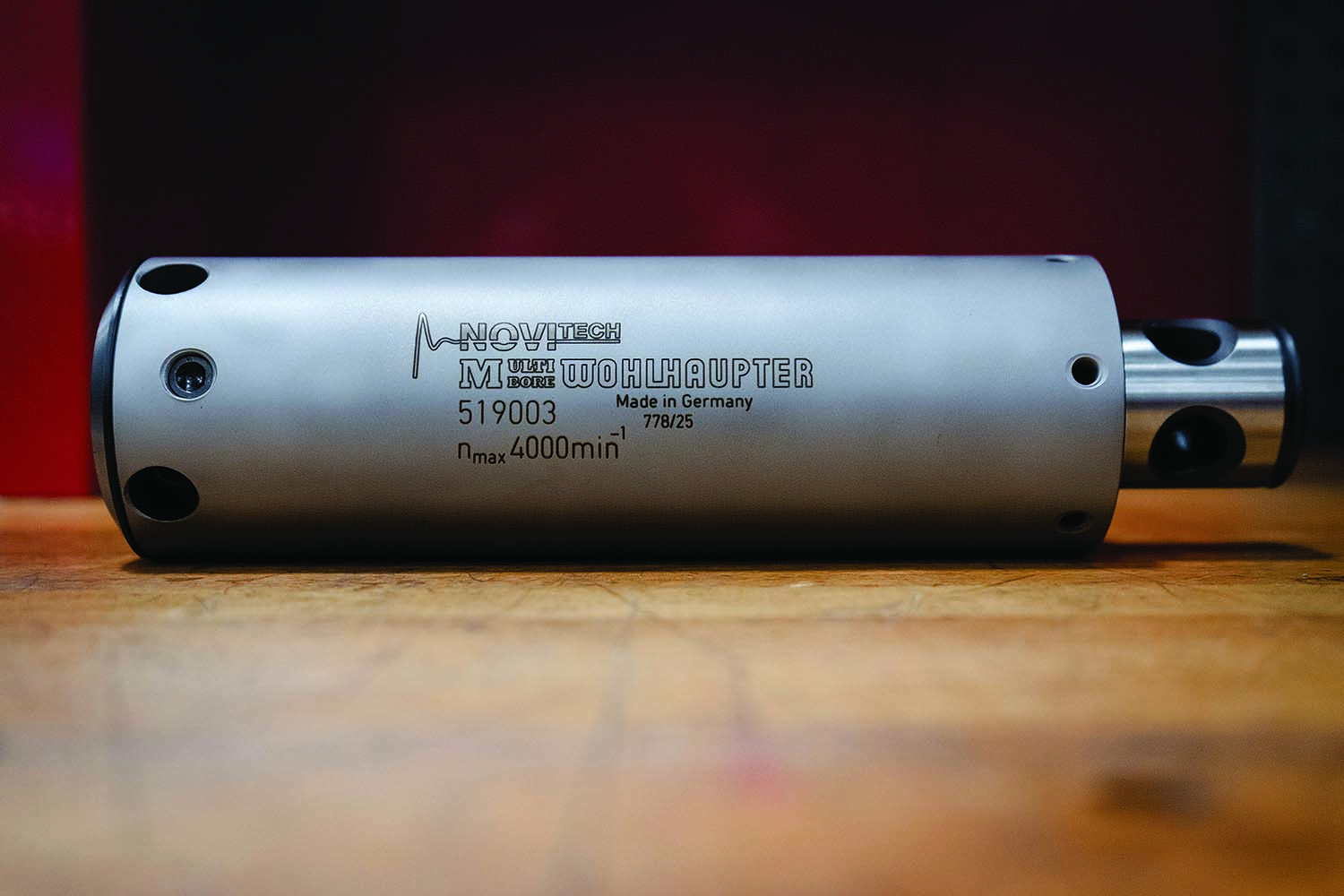

For boring applications with depth-to-diameter ratios greater than 5-1, Allied Machine & Engineering offers Novitech, a mounted module that reduces vibration when machining hole diameters. Wise said this improves the surface finish of bored holes and increases tool life.
“The boring head is going to last a lot longer because it’s not vibrating,” she said, “so there’s not a lot of radial deflection or pressure.”

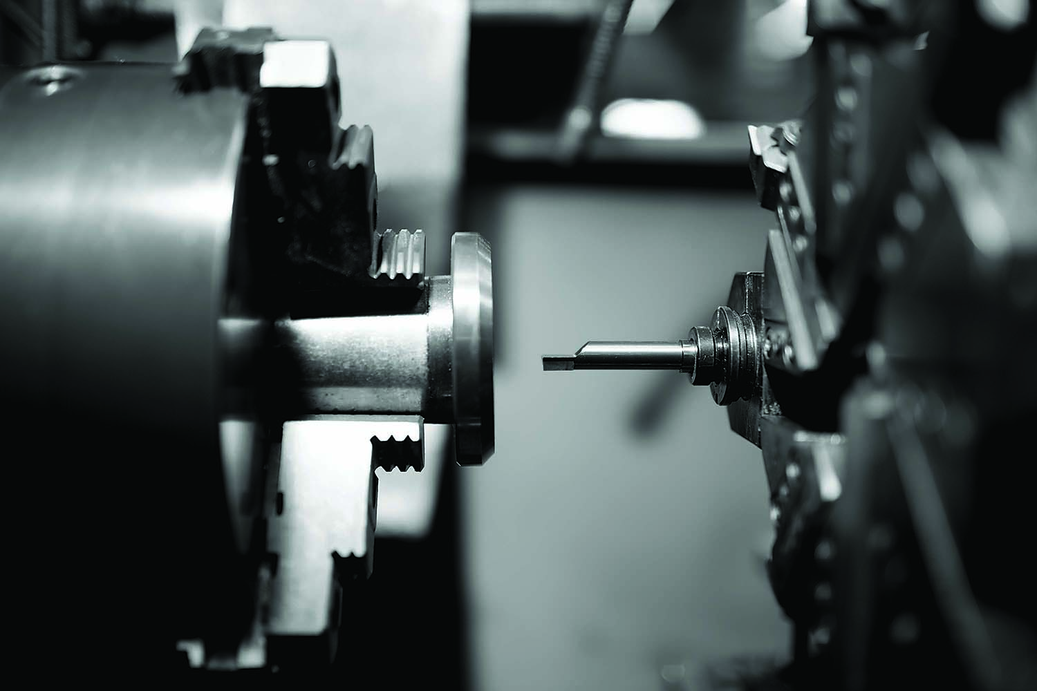

This lathe setup includes a solid-carbide boring bar in a toolholder.
This lathe setup includes a solid-carbide boring bar in a toolholder. Image courtesy of Scientific Cutting Tools

By reducing vibration, the Novitech module allows increased depth-to-diameter ratios in boring operations.

In addition, Wise said her company’s digital technology makes it easier for operators to use boring tools.
These tools can require “a good deal of technical knowledge to set up, run and make those final finishing adjustments,” she said. “So we (offer) digital adjustment instead of an analog vernier scale.”
For boring operations, Allied Machine & Engineering provides two digital tooling options. One is a tool with a built-in digital component: a display fixed to the boring tool. As a user adjusts the tool’s finished diameter setting, the adjustments are shown on the display, Wise
explained.
The other digital option is the company’s 3E Tech display, a small module that can be mounted on a boring tool for diameter adjustment.
“When you’re done making the adjustment,” Wise said, “you just take that digital module off the boring head and you’re ready to go.”
