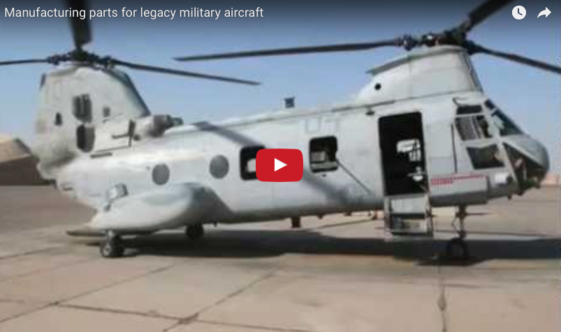

Posted with CTE's October cover story are a few video reports—one on parts for legacy military aircraft, and two others on the KC-135 Stratotanker. Watch the video reports here.

Courtesy of Marine Corps photo by Lance Cpl. Eric D. Arndt
The U.S. Marine Corps uses the CH-46 tandem rotor helicopter to transport troops, supplies, and equipment. It was introduced in 1964 and the Corps received its last new aircraft in 1971.
Until recently, refurbishing the covers required removing several hundred rivets that join the aluminum cover sections and their supporting stringers and ribs. Refurbishment was the only choice because the CH-46 went into service in 1964, was last produced in 1971, and no vendors for the covers exist. The covers invariably were bent and worn, so replacement required straightening them before reassembling and reriveting the cover sections.
According to Ray Jones, CEO of composites design and manufacturing company VX Aerospace Corp., Leesburg, Va., replacing the aluminum covers with carbon fiber components provided increased durability and corrosion resistance while reducing weight and saving the Marine Corps time and money.
Engineering for the CH-46, originally handled by Boeing, the helicopter’s OEM, is now the responsibility of the Naval Air Systems Command and engineers at the Marine Corps Air Station at Cherry Point, N.C. When staff there asked VX Aerospace about replacing the covers with carbon fiber components, the company produced a prototype part for a cover section located near the base of the helicopter’s rear rotor pedestal. The cover consisted of a multilayer carbon fiber shell tapering to about 1⁄8 " thick at the edges, encasing a ½ "-thick base made of Rohacell rigid foam.
