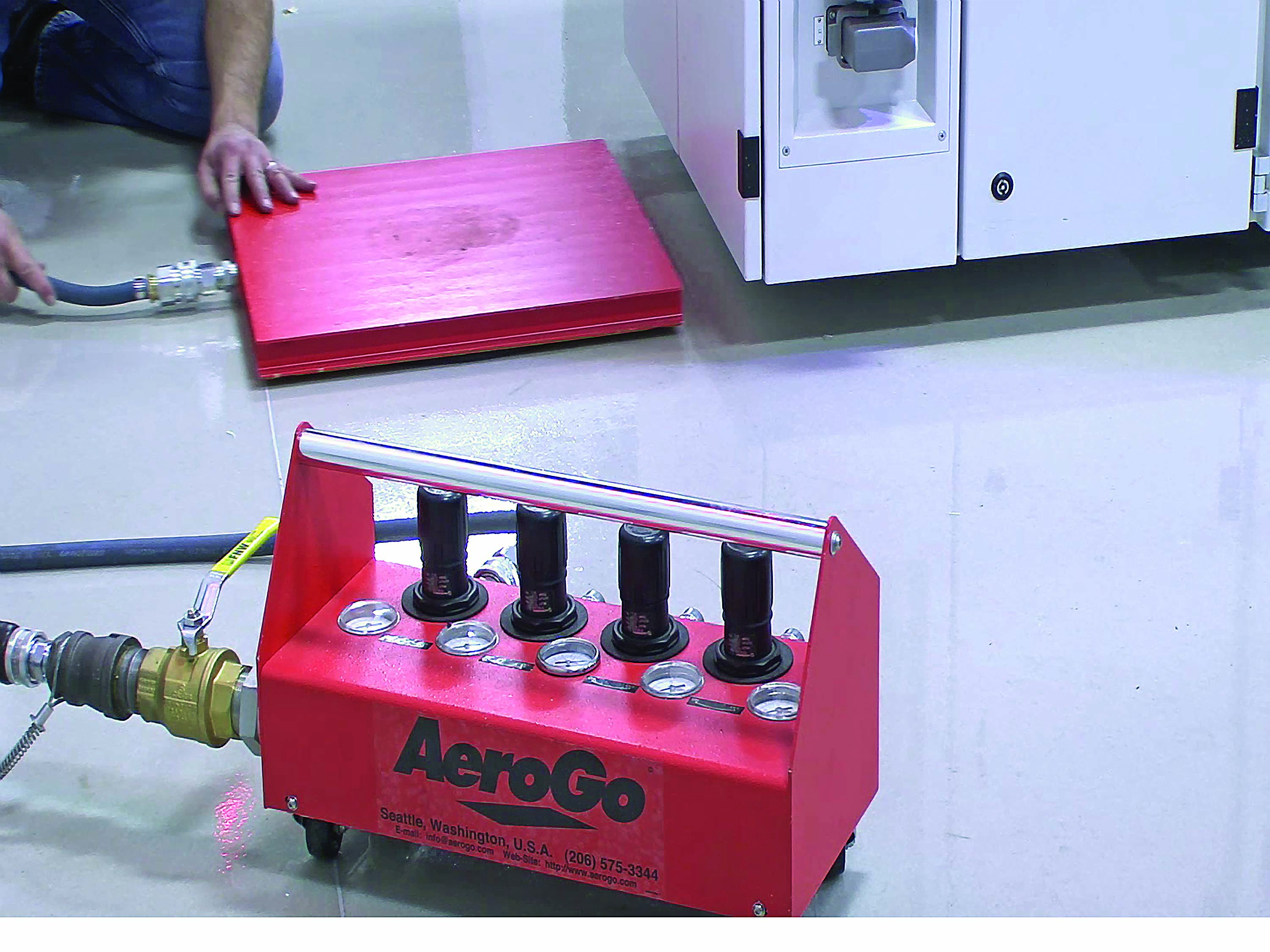

Air casters, on the other hand, fit under an object to be moved and use the same basic principles that power a game of air hockey or a hovercraft but scaled to move industrial-sized machines that weigh up to 6,350 kg (14,000 lbs.), Massenburg said. Operators use standard shop compressed air to fill a flexible doughnut-shaped air bag attached to each caster. As a bag inflates, it lifts a machine by about 51 mm (2") and forms an airtight seal with a floor. Once a bag reaches capacity, excess air is squeezed between the air bag and floor, creating a nearly frictionless film of air. At that point, the load literally is floating on a cushion of air.
AeroGo says its air caster system is simple and fast to implement. Image courtesy of AeroGo
He said air casters also distribute the total weight of a load over a large surface area, producing low floor loading. The net floor load with air casters usually is identical to the load generated by a person walking across a floor.
With a friction coefficient of 1 or less, air caster systems typically require as little as 0.45 kg (1 lb.) of force for every 454 kg (1,000 lbs.) of weight to be moved, or only one-tenth of the force needed to move as wheeled casters, Massenburg said.
He said moving a machine necessitates as few as two people.
“None of these are fast moves,” Massenburg said, “so you just take your time and be careful.”
He said a machine can be prepared for moving in about 15 minutes. A machine generally sits on a set of legs, and areas are available underneath to insert the air casters, which are about 76 mm (3") tall. If called for, users can place plywood cribbing on a caster to fill any gap between the caster and the machine.
