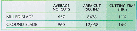

Factory tests have verified that a precision-ground bandsaw blade delivers longer blade life than a milled blade can. In a typical comparison test, cuts were made on 4" round AISI 4150 steel, using 1 1/4"-dia. bimetal blades with a 2-3 pitch on a production power bandsaw cutting at 12 sq. in./min. (Table 1). As indicated in Table 1, the ground blade cut 3580 sq. in. more steel than the milled blade - an increase of 42%. The time elapsed before there was a need for a blade change went from about 1 1/2 shifts to slightly more than 2 shifts.
Table 1: Cutting performance of a ground blade and a milled blade
