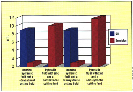

In the case of hydraulic fluids, some of the most advanced compounds may also be the least compatible. To produce fluids that provide anti-wear performance to hydraulic pumps in high-performance service, most hydraulic-fluid manufacturers add zinc diothiophosphate to their products. These fluids are stable and generally offer extended protection against pump wear. They do their job so well, in fact, that most major pump manufacturers will warranty their product only if fluids of this performance level are used.
When these fluids migrate into the cutting-fluid system, however, they have a much different effect on performance. During machining, the ability of both aqueous and oil-base neat cutting fluids to cool and lubricate are impaired when they are contaminated by hydraulic fluid containing zinc additives. The zinc-type additives tend to compromise the cutting fluid’s ability to control built-up-edge (BUE) formation. The fluid becomes less able to cool the operation and flush chips and fines, while the fluid’s lubricating qualities are increased. The results of these changes are most noticeable in grinding operations, where hydraulic-fluid contamination can cause wheel loading or glazing, shortening wheel life as much as 15% to 20%.
The contamination also creates health and environmental concerns. Grinding with loaded or glazed wheels can add mist and smoke to the plant environment. And the zinc byproducts that remain in the fluid eventually contaminate the plant waste stream and can be very costly to remove.
There are alternatives that will reduce the risks associated with hydraulic-fluid contamination. If a machine’s hydraulic system operates at lower pressures, then the shop may be able to use a quality R&O (rust and oxidation)-inhibited oil rather than a hydraulic fluid with zinc additives. However, if the machine’s hydraulic system operates at higher pressures or the protection of the system is critical, a high-performance hydraulic fluid will still be needed. In these cases, the user can choose one of the nonzinc hydraulic fluids that have recently been introduced. In tests, these new-generation fluids have actually outperformed the traditional formulations with zinc additives. In fact, these newer fluids have performed so well that they have earned approval from the hydraulic-system manufacturers.
The developers of premium nonzinc hydraulic fluids knew their products would have to be suitable for use in a machining environment. To achieve this goal, they formulated their hydraulic fluids to separate easily from aqueous cutting fluids.
Flowing Together
Fig 2: When separation was measured one hour after mixing, the samples with nonzinc hydraulic fluid (Mobil DTE Excel) were significantly more separated than the samples with a premium hydraulic fluid with zinc additives.In one series of tests, researchers looked at four different blends of 10% hydraulic fluid and 90% cutting fluid. Two blends were of a nonzinc fluid and either a conventional coolant or a semisynthetic coolant. The other two were blends of a hydraulic fluid with a zinc additive and the two coolants. After these blends stood for an hour, researchers found that regardless of the type of coolant used, the blend with the nonzinc hydraulic fluid showed significantly more separation than the other blends (Figure 2).
