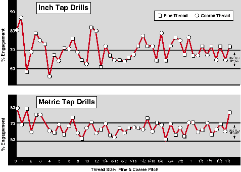

Shops that primarily use drills to create holes for threading may decide to use metric drills to improve thread quality and consistency. "Using metric drills from standard millimeter-based sizes minimizes tool wear and energy requirements while providing maximum strength threads," says Caterpillar’s Joseph Langenstein. The smaller the drill relative to the intended major diameter of the threaded hole, the more energy is needed for tapping. The result is shorter tap life. As the drill size increases, less energy is required to cut internal threads, resulting in longer tap life. A tap drill that’s too large, however, will lead to the production of shallow threads.
Figure 1: Percentage of thread engagement produced by standard inch and metric tap drills for fine and coarse thread pitch.
Caterpillar decided to switch to metric drills in 1971, just before the company’s overall conversion to the metric system. "Even without going totally metric," explains Langenstein, "we were considering converting to the use of metric drills just to have a better selection of sizes." He recommends using drills that will result in 60% to 70% thread engagement. Figure 1 shows the percentage of thread engagement produced by standard inch and metric tap drills for each thread pitch. The graphs show that metric drills produce more threads within the desired range of thread engagement.
Why do so many inch drill sizes fall below 60% or above 70% thread engagement? It’s very possible that the fractional, letter, and number sizes weren’t designed specifically for tap-drill applications. And if the developers of inch drill sizes had thread engagement in mind, it’s likely that they didn’t know as much about threading as we do today. However, metric drill sizes weren’t designed for tapping applications, either. "That’s just how it happens," says Joseph Langenstein. "If you want to drill and tap a hole, you just have to pick the closest size."
When selecting the closest size to produce the optimum percentage of thread, drill users have more metric sizes from which to choose. CJT’s Tom Trost explains that metric drills are in increments of 0.1mm or 0.004", whereas fractional drills are in increments of 0.016". Metric drill sizes also are more evenly spaced. Figure 2 shows that sometimes two inch drill sizes are almost the same, while often there are significant gaps between sizes. North American Tool’s Roger Taylor adds that there are about one-third as many metric sizes as inch sizes. With fewer drills to purchase, stock, and maintain, a shop can reduce its tool costs substantially.
Increased use of optimum tap-drill sizes also can help shops save money through improved tool life. A shop that substitutes an inch drill for a metric drill to produce a metric-size hole is bound to choose an inch size that is larger than the specified metric size. This may result in threads that are too shallow once the hole is tapped. "The closer you drill or drill and ream the hole to the maximum minor diameter," says Trost of CJT, "the less power you use while you’re tapping and the less wear you create on the tap." Dan Gajdosik, senior engineer at Besly, emphasizes the need for metric drill sizes, "especially on those tap sizes where you need to get the percentage of thread down below 75%." Like many toolmakers, Gajdosik expresses concern about the lack of metric-drill use. "While drill and tap manufacturers certainly see the need for metric drill sizes," he says, "we can’t seem to get this point across to the end users."
