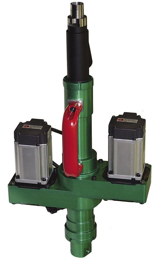

The L-MAX features two servomotors that work in conjunction with each other, one that drives the spindle and another for the feed. The motors are connected to a control system that lets users regulate the speed and feed at any point during drilling operations.
Another key L-MAX feature is its “adaptive drilling” mode. In this mode, the drill automatically recognizes the transition from one material layer to another and matches the speed and feed to the new material conditions.
Drilling stack materials
The portable L-MAX is designed to drill clean holes in stack materials. Image courtesy Somex.

“We’re not only monitoring the position of the drill but also its torque feedback,” which changes based on the amount of power needed to drill through a particular material, Coleman explained. “When the position and torque feedback tell the drill that it’s going from one material to another, the settings quickly change and the unit continues to drill” at the optimal speed for the material.

At a user’s plant, the L-MAX unit is rolled to the drilling location, where the operator takes the drill by its two handles and locks it in place on a fixture, then returns to the control panel to operate the drill.
