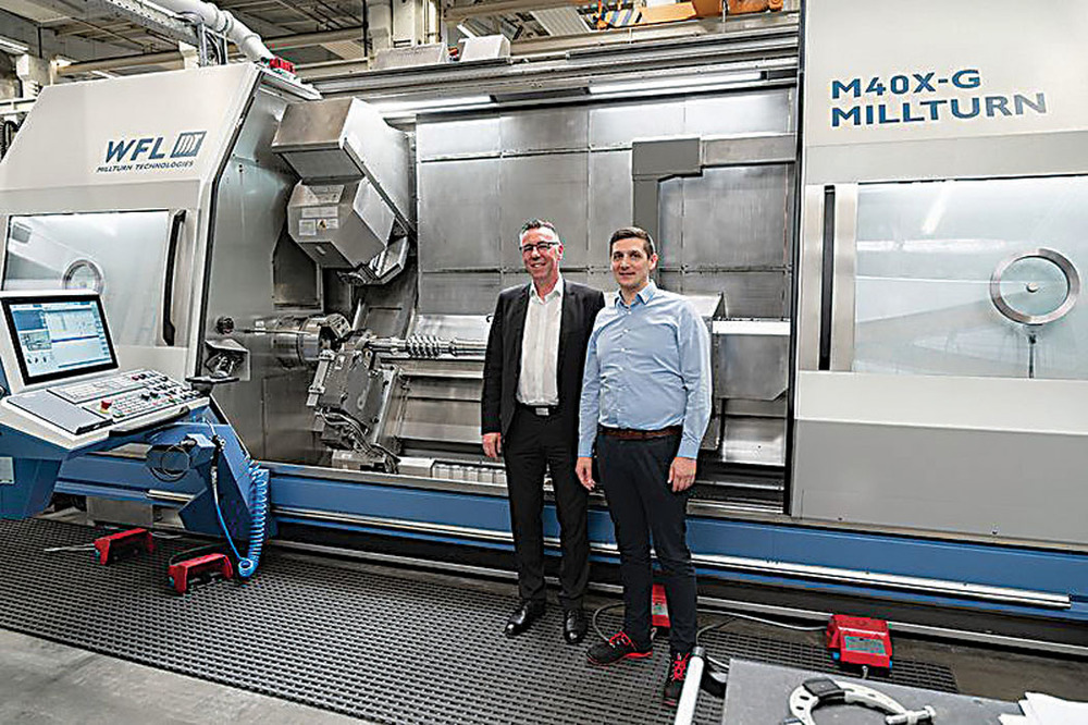

Image of Michael Müller and Marko Kost From left to right: Michael Müller (left), regional sales manager at WFL, and Marko Kost, technical support team leader at AUMA Drives, in front of the M40X-G. WFL Millturn Technologies

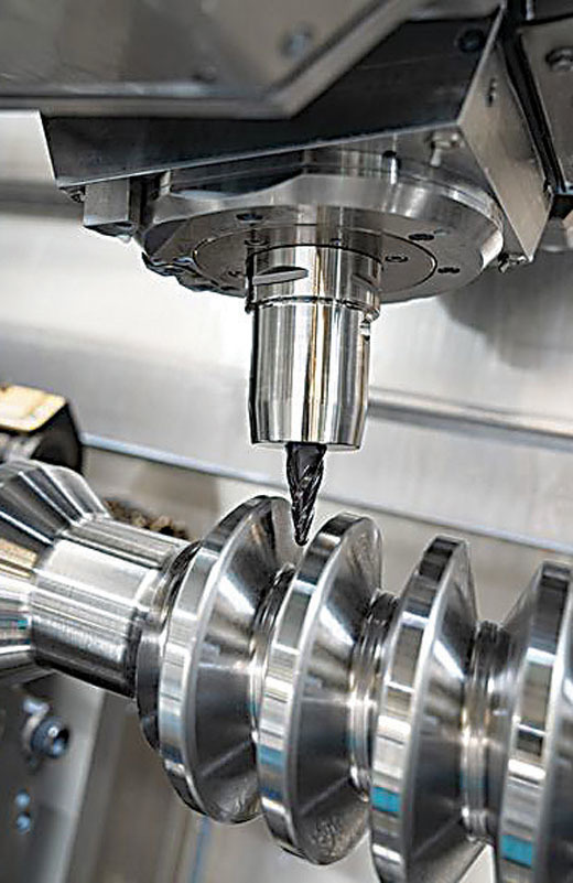

Image of M40X-G mill-turn machine WFL designed the M40X-G mill-turn machine specifically for producing worm shafts. WFL Millturn Technologies

The worm shafts are produced on the WFL machine. AUMA’s high-performance worm gear units can be found in concrete mixing plants, among other applications. The previous machining process for producing worm shafts was less than ideal, according to Kost. “The process for manufacturing this shaft part used to involve a lot of individual steps: turning, clamping, pre-machining, pre-milling the gear teeth and grinding the gear teeth — an extremely expensive process. Then it was time for the heat treatment. The part has to be annealed because the milling and turning process sometimes causes the shafts to twist. “After that, it was on to the finish milling of the shafts. We would pre-grind the gear teeth and finally carry out the heat treatment and case hardening before re-clamping the shaft on the turning machine. Both sides were turned, and slots were then milled before moving the part to yet another machine for the finish grinding of the gear teeth. Finally, we carried out finish grinding the seats externally in the cylindrical grinding machine. That’s a lot of individual processes with an extremely long lead time.”
With the mill-turn machine from WFL, the worm shaft can be preturned completely in just one clamping operation. The gearing is pre-machined, which means that there is no longer any need to pregrind them. The shaft goes from the machine straight to case hardening. Once this has been completed, the rest of the machining process — right through to the finished worm shaft — continues in the M40X-G.
Other than the case hardening, finish grinding of the gear teeth is the only remaining process still carried out on another machine. All other processes are performed on the M40X-G.
The time savings are significant, Kost said. “We have reduced the setup time by 50%. The machining time has been reduced by 15 to 20%, but we can see more potential here. The lead time has been halved. We still have the external hardening process, which sometimes prevents us from being flexible. But thanks to the WFL, we can now theoretically deliver within four weeks if a super urgent order comes in.”

Batch sizes range from one to 24, Kost noted. “Due to the small batch sizes, it was extremely important to us that the machine is easy to set up. That’s why we have a large tool magazine, so that we can set up parallel to machining time. In the past, we would frequently have to change the jaws due to the jaw chuck. Now, we have the same jaw chuck on the main and counter spindles. We sometimes use face drivers for special machining during the high-precision finishing process, and we can attach these face drivers to the jaw chuck so that we are under way in no time.”
The tolerance specifications are in a narrow range, in some cases down to IT6, which AUMA machines completely using the in-process measuring probe by means of turning, Kost said. “We used to always be told that we had to grind to achieve this, but actually we can get the same result by turning. That’s a massive competitive advantage for us. And, of course, the design with the slant bed, that’s critical for stability.”
The M40X-G is also equipped with a pick-up magazine for the grinding unit. This can also be used for boring bars later on and is a huge advantage, according to Kost. “We used to use parameter software to help us produce the gear teeth on the shaft. The operator entered the data, but this was a big challenge for us because you always had to draw the tooth when programming and then simulate it in the program. WFL has developed a specific programming cycle for us for this process, so we can now program the gear teeth directly at the machine.
“You simply enter the gear teeth data and then mill or turn. There is no longer any need for external programming. The whole process runs extremely smoothly. It really was a fantastic collaboration. We can also measure the gear teeth with a measuring probe and then finish them.”
