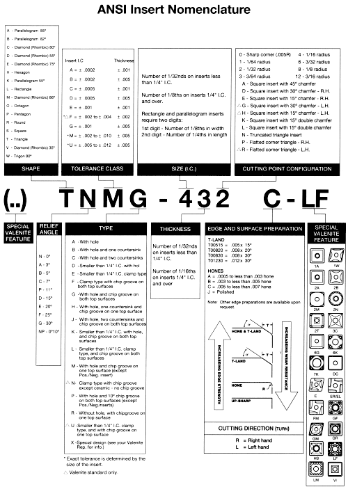

ANSI System
The ANSI code system (Figure 1) has been generally adopted by the U.S. cutting tool industry for the quick and accurate identification of indexable inserts. This system has been widely used throughout the United States for many years. The code system has evolved with the advancement of insert design and technology. But the code hasn’t evolved to the point where it encompasses all advancements. As shown in Figure 1, tool producers have added custom prefixes and suffixes to the standard code where needed.
The current ANSI code consists of up to 10 alphanumeric characters. Of these 10, the first seven are most commonly used. The first four of these seven characters are letters that identify the geometric characteristics of the cutting tool. The next three characters are numbers that describe the size of the cutting tool.
Specifically, the first character identifies the shape of the cutting tool. There are standard designations for simple shapes such as round (R), triangular (T), and square (S), as well as for more complex shapes such as diamonds (C, D, M, and V), octagons (O), pentagons (P), and parallelograms (A, B, E, and F). Although an extensive range of tool shapes is covered in the standard code, many manufacturers produce special shapes for which they adopt their own code identification. For example, one manufacturer may use the code G to designate a 45° parallelogram insert. This is not a universally accepted designation, however; another manufacturer may use G to signify an uneven hexagon with three flat sides and three sides ground in an arc. These special codes can sometimes cause confusion, but a code system that covers all possibilities is impractical. There are simply too many potential insert geometries.
T _ _ _ - _ _ _ - _ - _ _
The second character identifies the clearance angle of the cutting tool, which is the angle formed between the top of the tool and the flank surface. The angle specified is the angular difference from 90°. For example, the code letter N represents a 90° relationship between top and flank, or 0° clearance. This is commonly called a negative-clearance-angle cutting tool. Another popular tool has the code letter P. This represents a positive clearance angle of 11°. The most common clearance angles range from 0° (N) to 30° (G).
 T N _ _ - _ _ _ - _ - _ _
The third character identifies the combination of tolerance ranges under which the cutting tool is manufactured. Tool users frequently will see the letter G in this position. This represents a tolerance of 0.001" on the tool’s inscribed circle (IC) dimension, 0.001" on the tip-radius altitude, and 0.005" on the tool thickness. The M tolerance code is also very popular for nonground, roughing-style tools. This code represents a tolerance of 0.002" to 0.010" on the tool’s IC and 0.005" on the tool thickness. The tolerance chart in Figure 1 describes a range of indexable-insert tolerances.
 T N M _ - _ _ _ - _ - _ _
The fourth character describes the physical characteristics of the cutting tool’s mounting system and cutting-surface configuration. For instance, a flat-top, clamp-type cutting tool would have the code N. If that same flat-top cutting tool had a center hole for screw mounting, it would have the code A. If its center hole was countersunk on one side, it would have the code B. If the hole had an additional countersink on the opposite side, the insert would have the code C.
A different letter will be used in the fourth position if the insert has a clamp-on or molded-in chipbreaker. For example, if an N-type tool had a chip groove on one top surface, it would be called an R-style insert. If it had chip grooves on top and bottom, it would be an F-style tool. Add a hole, and it would be an M-type (one-sided) or G-type (two-sided) tool.
The fourth character describes many tool features. Currently, there are more than 17 different tool configurations described in the standards. And if this is not enough for the tool producer, there is the X designation for special designs. With all these possibilities, it is curious to note that this character is often omitted when describing commonly known turning inserts or when describing milling inserts.
 T N M G - _ _ _ - _ - _ _
At this point, the code system changes from letters to numbers. The next three characters describe the physical size of the cutting tool.
The first of the numbers, or the fifth character in the code system, represents the insert’s IC in 1/8" increments. For example, a 1/4" IC insert is described by the number 2, representing 2/8". It follows that a 1/2" IC insert is represented by the number 4 and a 1" IC insert is represented by the number 8. The exception to this rule applies to small inserts with IC dimensions under 1/4". For small tools, the number in this place represents the IC dimension in 1/32" increments. The number 2 represents 2/32" or 1/16". It follows that 3 would describe 3/32" and so on, up to a 1/4" IC tool.
 T N M G - 4 _ _ - _ - _ _
The sixth character represents the thickness of the cutting tool. Again, there is a split between large and small inserts. For inserts with IC dimensions of 1/4" and greater, this number describes the thickness in 1/16" increments. For small tools with IC dimensions less than 1/4", this number represents the thickness in 1/32" increments. A popular triangular small tool has a thickness of 3/32", which would be represented by the number 3 in the sixth place.
 T N M G - 4 3 _ - _ - _ _
The seventh character can be a number or a letter. Numbers are used for tools with corner radii, which are normally inserts used in turning operations. The number describes the size of the corner radius in 1/64" increments. For example, a 1/32" radius is represented by the number 2, a 3/64" radius by the number 3.
 T N M G - 4 3 2 - _ - _ _
Milling tools differ from turning tools in that they use a letter in the seventh place to describe the design of corner chamfers on the tool. Like the fourth place, this can be a very confusing part of the insert code. The seventh character describes the angle of the corner chamfers, relative to the insert side. The insert hand, left or right, is also a factor in the code letter used, as well as the presence of one or two chamfers per corner. For example, the letter E represents a 15° chamfer on a right-hand tool. The same tool in left-hand configuration would have the letter H in the seventh place. If the tool had two 15° chamfers, the code letter would be L. Because there are so many possible combinations, it’s best to reference a tool supplier’s identification guide when specifying a tool on an order using this character.
 S N K _ - 4 3 E - _ - _ _
The eighth character also can be a letter or a number. When describing a nonmilling insert, which will be identified with a number in the seventh place, the eighth character is a letter. This character describes additional characteristics of the tools. An A, B, or C specifies honed edges, an N indicates negative lands, and a J identifies polished insert-rake surfaces.
 T N M G - 4 3 2 - C - _ _
Milling insert tools, which have a letter in the seventh place in their identifying code, use a number in the eighth place. This number represents a milling insert’s wiper flat length and is measured in 1/32" increments. The wiper flat is most often a chamfer and ultimately produces the surface finish on the workpiece.
 S N K _ - 4 3 E - 2 - _ _
For nonmilling inserts, the ninth and tenth places are most often used by tool producers to distinguish special features of their products. But for milling inserts, the ninth character indicates the direction of cut. This place is identified by the letter R for right or L for left. For both milling and turning tools, the tenth character is used at the cutting tool producer’s option.
 S N K _ - 4 3 E - 2 - R _

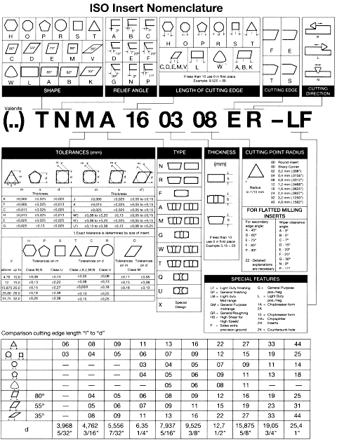

ISO System
While the ISO cutting tool description system (Figure 2) uses metric units rather than inches, it has many of the features of the ANSI system. In particular, the first four characters are practically identical to the ANSI system. The first is the shape, the second is the clearance angle, the third is the tolerance range, and the fourth is the cutting-surface configuration and mounting system. A notable exception: In the ISO system, the fourth character is always used when describing milling inserts; in the ANSI system, it is often omitted.
 T N M A - __ __ __ - __ - __
The big difference first shows itself in the fifth place. In the ISO system, the fifth place describes the cutting tool size by specifying the tool’s side length to the closest millimeter. This place therefore requires two digits for a proper description. Tool sizes designated under this system will vary significantly from tool sizes under the ANSI system, as the following example illustrates.
In the ANSI system, a 1/2" IC insert is represented by the number 4 (4/8"), regardless of the tool’s shape. But because a tool’s shape affects its side length, its shape will also affect its size description. Under the ISO system, a 1/2" IC insert will be represented by the number 12 (12mm) if it is a round, square, or 80° diamond insert; 22 if it is triangular; or 15 if it is a 55° diamond tool.
 T N M A - 16 __ __ - __ - __
The sixth place in the code is also different from the ANSI system. Like the fifth place, it requires two digits and describes the tool thickness rounded off to the lowest whole millimeter. For example, a 1/8" thick cutting tool measures 3.18mm and has the code 03. A 3/16" thick cutting tool measures 4.76mm and has the code 04.
 T N M A - 16 03 __ - __ - __
As in the ANSI code, the seventh character in the ISO code can be a number or a letter. Numbers are used for tools having corner radii, or turning tools, and letters are used for milling tools. For turning tools, the seventh place represents the nose radius size on the cutting tool. Once again, the ISO system uses a two-digit code in this place. The code represents the radius size in tenths of a millimeter. For example, a 1mm nose radius would have the code 10, whereas a 0.5mm radius would have the code 05.
 T N M A - 16 03 08 - __ - __
For milling tools, the ISO system breaks the two letters in the seventh place into separate tool identifiers. The first letter identifies the angle of the wiper flat, or actual cutting edge, relative to the insert side, much like the ANSI code. The second letter describes the clearance angle of the wiper flat.
This tool geometry feature is not part of the ANSI system. In the example below, the letter A describes corner chamfers at 45° to the tool sides. The N following the A means the surface has a 0° or negative clearance angle.
 T N L N - 12 04 AN - __ - __
As in the ANSI system, there are additional characters in the ISO system that can be employed but are often omitted. They are the cutting edge condition, the direction of feed, and the manufacturer’s optional area.
