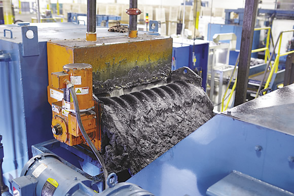

Cast iron swarf can be scalped using magnetic rolls, improving the efficiency of the filter and reducing media consumption.

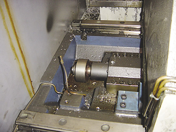

![CNC%20Specialty%20Store%20X%20axis%20lube%20line%20off%20for%20bearing.tif](/sites/www.ctemag.com/files/article_images/CNC%2520Specialty%2520Store%2520X%2520_opt.jpeg)
Courtesy of CNC Specialty Store
This machine likely had a chip buildup problem. The threaded part on the lube line is gone, and the fitting on top of the bearing block is damaged.

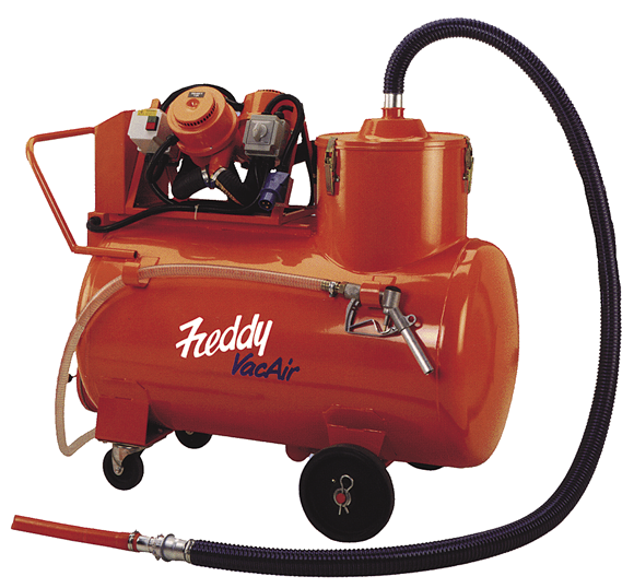

Steven Friedman, general manager for Sanborn Technologies, Walpole, Mass., said by removing solids and tramp oils on a consistent basis, the whole system will work more efficiently.
Sanborn Technologies offers a variety of sump cleaners. Sanborn’s mobile version works at 35 gpm and filters particles down to 10µm. The unit maintains the fluid level so that machining can continue without interruption.
However, many cooling components cannot be cleaned using this in-situ method. A full clean, colloquially called a “sump dump,” allows for the cleaning of all components and surrounding areas.

Sanborn Technologies’ Freddy Ecovac is a sump cleaner that can suck dirty coolant from a sump, filter it to 10µm and discharge the filtered coolant back into the sump.

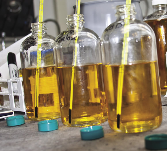

Concentration Control
Knowing when to clean can be aided by measuring pH levels and coolant concentration ratios. The need for checking concentration levels on a frequent basis cannot be overlooked. According to Reindl, many plants run daily concentration checks on central systems.
All water-based MWFs operate at a given concentration ratio of water to oil. Out-of-specification concentration levels are the biggest problem observed in machine shops, according to Eriez’ Wendt.
Operating a system at a low concentration ratio may result in decreased tool life, bacteria and fungus problems, corrosion and eventual downtime because of the lack of proper lubrication, according to Wendt. Operating a system at too high a concentration may result in workers suffering from dermatitis caused by airborne lubricant, as well as foaming and oily residue deposited on parts.
Testing pH levels, i.e., the measurement of hydrogen ions contained within a given solution, can be instructive. For instance, tracking pH levels provides an understanding of microscopic activity, according to a technical paper from Cimcool Fluid Technology, Cincinnati. According to the report, “Metalworking Fluid Controls,” even low levels of bacteria, if left untreated, can cause a drop in pH, because of the bacteria’s production of acidic waste compounds. If pH falls below 8.5, it can result in the MWF becoming acidic, or “splitting,” in the case of a soluble or semisynthetic oil. Levels greater than 8.7 indicate the presence of mold.

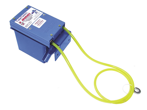

![Abanaki.tif](/sites/www.ctemag.com/files/article_images/Abanaki_opt.jpeg)
Courtesy of Abanaki
The TubeTastic oil skimmer from Abanaki can skim oil from chip conveyors or even enclosed machining centers.

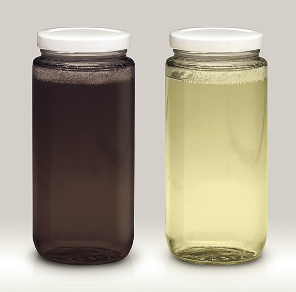

![PRAB%20FF%20%20Dirty%26Clean%20Water%20Jars_Orig%20Photo..tif](/sites/www.ctemag.com/files/article_images/PRAB%2520FF%2520%2520Dirty%2526Clean%2520W_opt.jpeg)
Courtesy of PRAB
Filters can remove fines down to 1µm.
