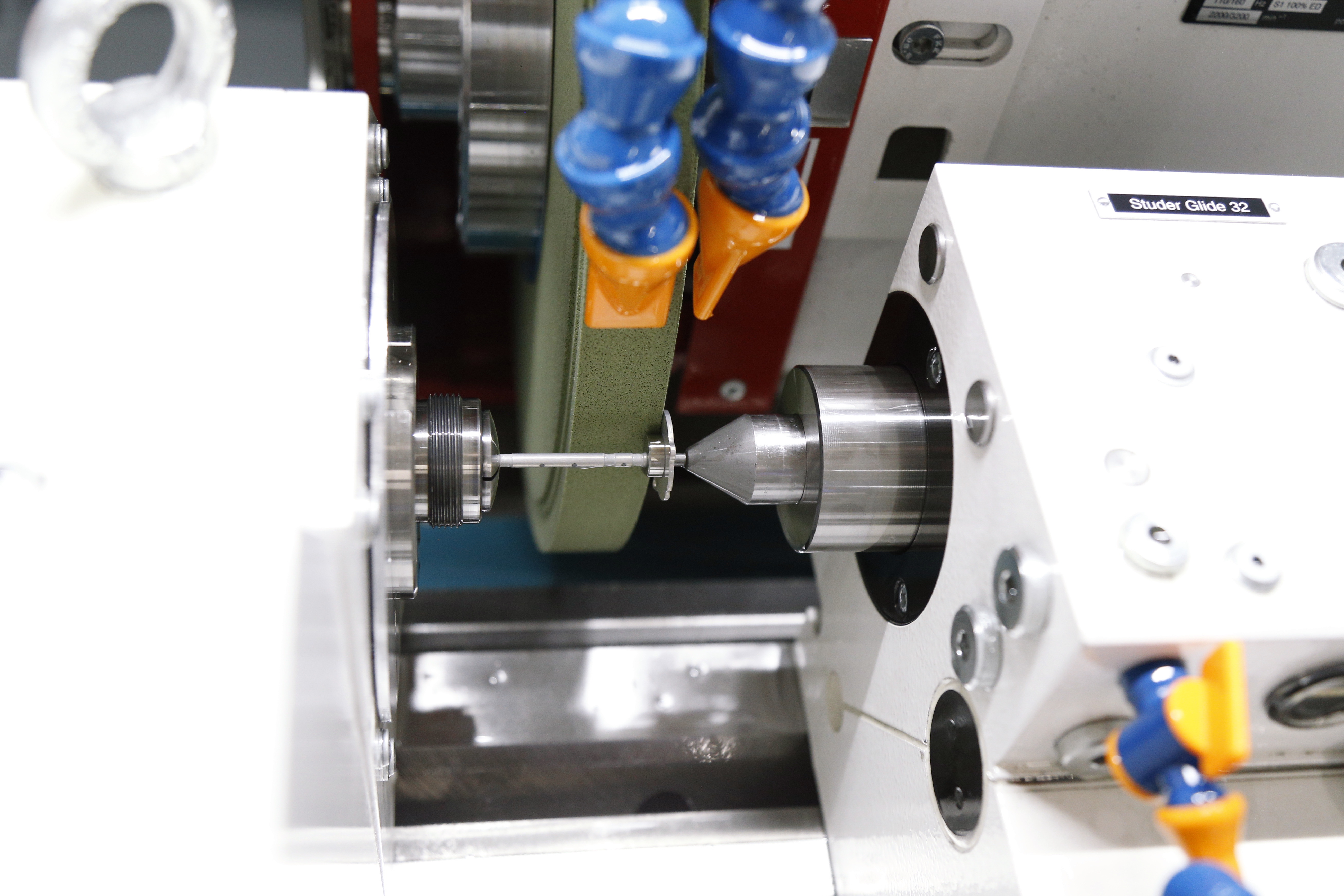

The smallest recirculating ball screws have a ball diameter of 0.8mm. All components are developed and manufactured in-house by MPS, including the balls. The larger series of screw spindles with gothic-arch thread are produced on a fully automated Studer S33.

MPS Microsystems miniature recirculating ball screws, or ball-type spindles, are made exclusively of stainless steel and are positioned with double nuts, which enable fine adjustment of the axial play. These often customized spindles guarantee virtually smooth movement thanks to the high precision of their ground thread. With regard to customized production: There is a wide range of customized options available for recirculating ball screws.
Grosjean added that “Such applications require the highest precision and positioning accuracy – 100% backlash-free. And it is precisely here that our spindle systems show their strengths. We grind a so-called gothic-arch thread profile within the tightest tolerance ranges, so that we can reduce the radial clearance and backlash to zero.”
Gothic-arch thread: grinding from solid
The gothic-arch thread form is ground directly from the solid hardened blanks. A macro was developed for these gothic-arch thread forms together with Studer. The grinding parameters can be adapted very quickly to the respective screw spindles with this macro.
Weyermann, the regional sales manager, Fritz Studer AG, said that the “Studer S33 used here is an external cylindrical grinding machine with a turret wheelhead. Specifically, the wheelhead used here has two external grinding wheels. One of the two wheels is used for the thread profiling, while the second wheel is generally used for external cylindrical grinding.”

Typical thread grinding process
The Studer S33 requires less than quarter of an hour for the complete machining of a screw spindle 8 mm in diameter and 120 mm in length. The thread is roughed and finished with the same grinding wheel. The grinding wheel is dressed repeatedly in the micron range throughout the grinding process. More than 1000 screw spindles of this size can thus be ground with one grinding wheel.”

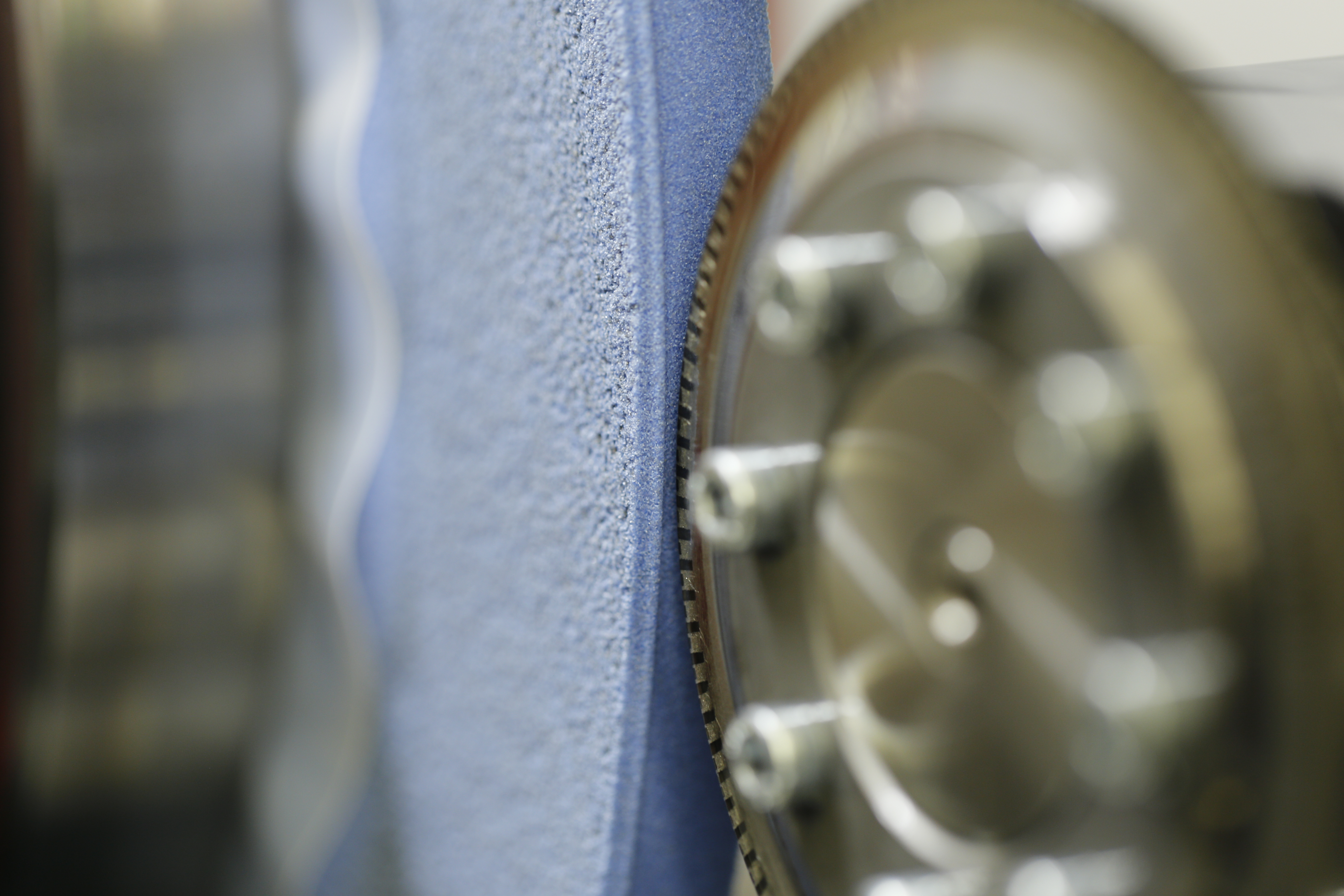

The dressing process with a number of tasks
The grinding wheel dressing process performs an important function during grinding. On the one hand, the dimension and form of the grinding wheel are calibrated, and on the other hand the cutting ability of the grinding wheel is defined.
Julien Grosjean, the screw grinding manager, said “In the case of screw spindles we typically need to dress repeatedly during each production process. Both a diamond and a dressing roll are used for dressing. You can define the roughness of the grinding wheel relatively specifically with the dressing roll, and thus control the grinding process and the surface quality. We have carried out many tests in this regard, until finding the ideal dressing method for the roughing and finishing processes.”
