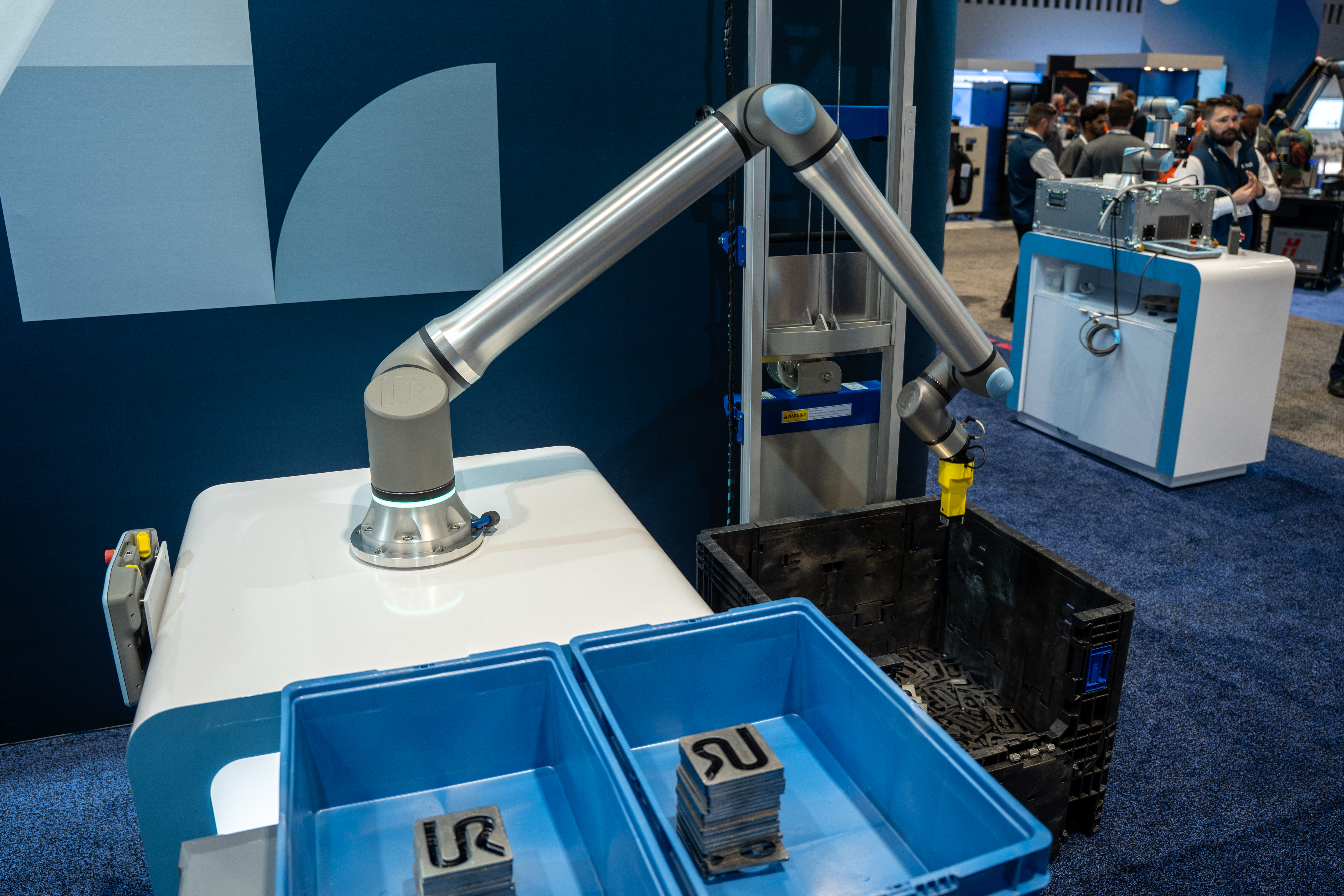

For example, at Fabtech showcased its bin-picking capabilities. It showed the UR8L picked up parts from a full dunnage bin into a separate container. The longer reach, combined with the new robot’s compact tool flange and fast wrist joints, allows more pick positions and for the robot to reach deep into bin corners with ease. The improved joint architecture delivers up to 30% faster cycle times compared to earlier generations of Cobots.
