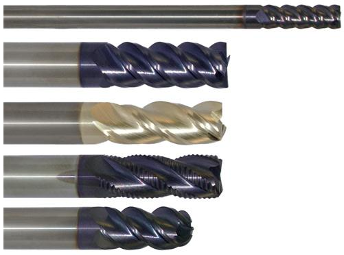

TJ Grinding specializes in short-run production of custom reamers, endmills, drills and burrs, with an emphasis, as Jason Winters remarked, “on the ‘custom’ part of that sentence.”

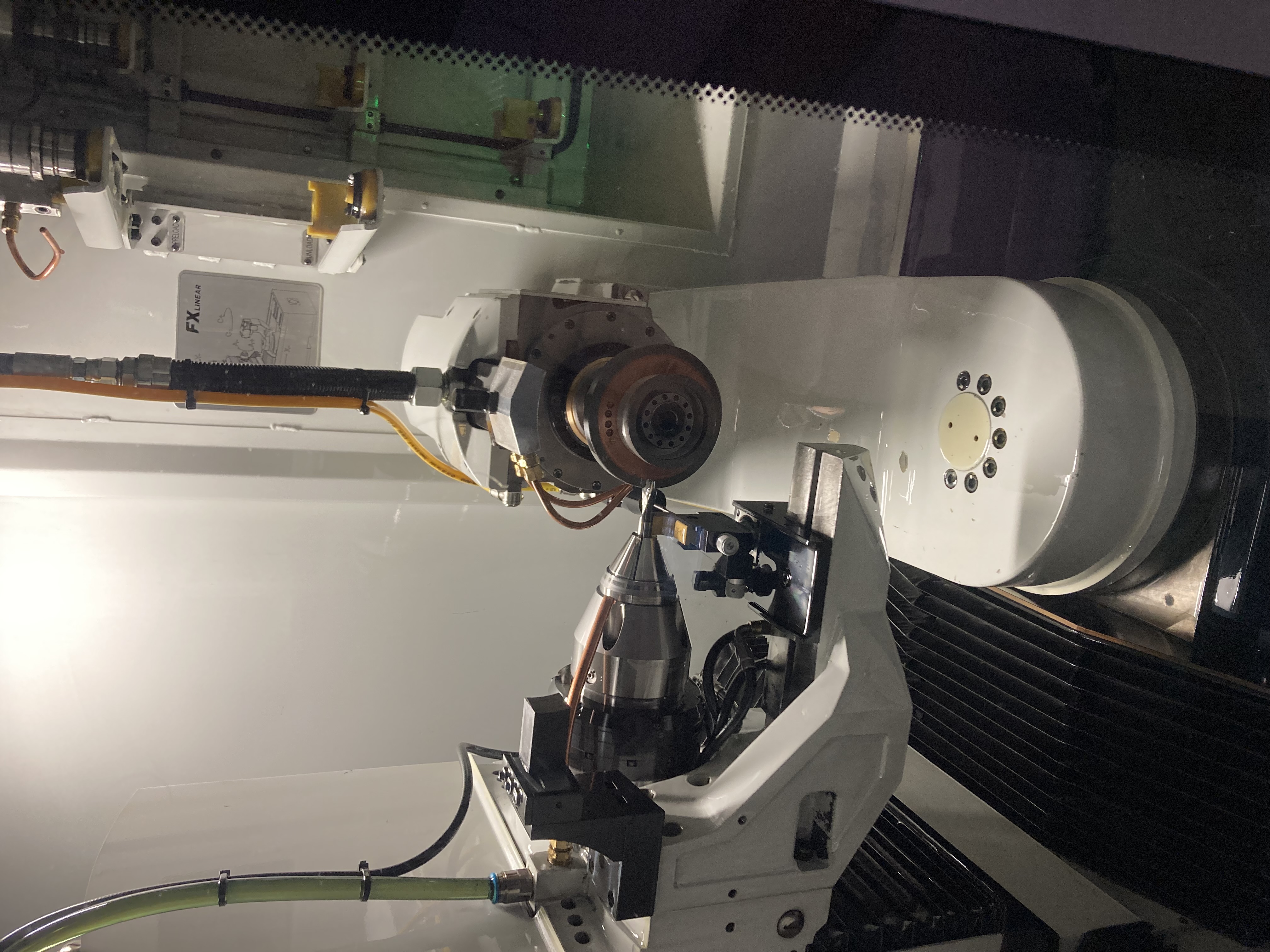

A tool being ground on an ANCA FX7 Linear machine at TJ Grinding.
A tool is being ground on an ANCA FX7 Linear machine at TJ Grinding.

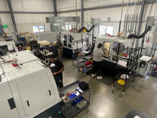

On the training front, Tim Winters notes the machines are very intuitive, so the TJ Grinding workforce is easier to train and especially cross-train to run multiple machines.  There are currently 15 employees at the shop but, as Tim points out, “We have 9 of our 10 ANCA machines running with robotics, so the production in the shop is designed to remain at a very high level.  The company had started as a strictly manual job shop, sharpening mills and drills.
“As you can see, we’ve come a long way down the road to automation and higher-level production,” said Jason Winters.  “We look to solve some big challenges for our customers, another way my brother and I have fun in this business, every day.”

TJ Grinding works with various substrates to produce tools, including specialty coatings, so their products are used on all types of metals, as well as composites, specialty plastics, carbon fibers and more.
One of the company’s specialties is solid carbide rotary cutting tools, used in the orthopedic, orthodontic, catheterized and other surgical instrument markets.
Coated toolingThe shop also produces such cutting tools for auto parts, engines, motorcycles, snowmobiles, pattern and moldmakers, plastic parts and the woodworking industry.

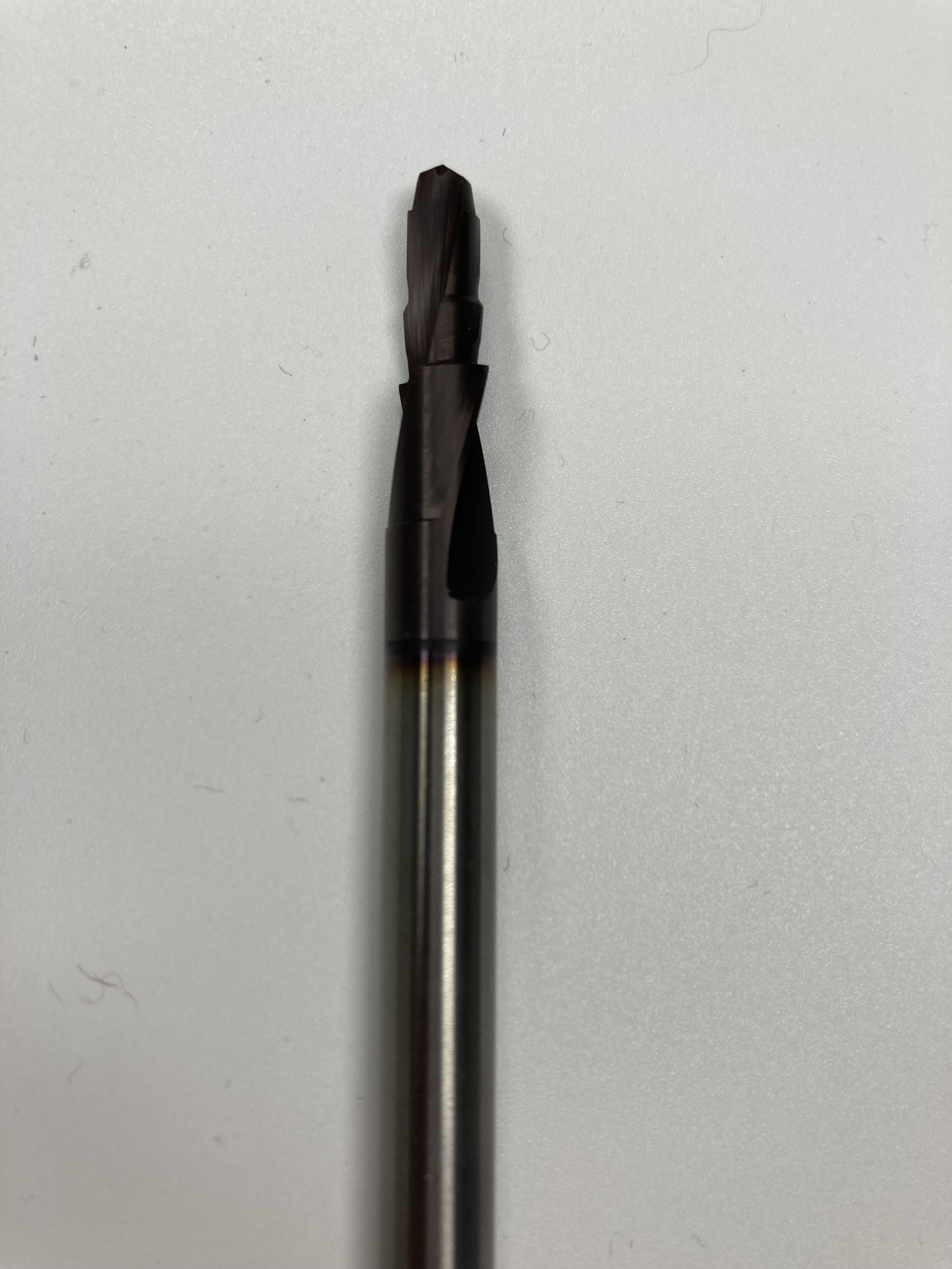

Coated carbide tool used to machine a 1018 steel compressed gas bottle valve.
An example of a part made by TJ Grinding for 10 years now on ANCA machines, originally the RX7 and today the FX5 and FX7.
This coated carbide tool is used to machine a 1018 steel compressed gas bottle valve.  To date, according to Jason Winters, not a single leak has occurred in the customer’s high-volume production, over a ten-year span.
The tool, after coating on the gage line, is holding a +/- 0.0003” tolerance consistently.  According to Winters, “Despite the length of the run and the changeover in machines, the ANCA combination of machine mechanics, software and CNC consistently hold the tolerances for us.  We have made and continue to make thousands of this tool, every year.”
