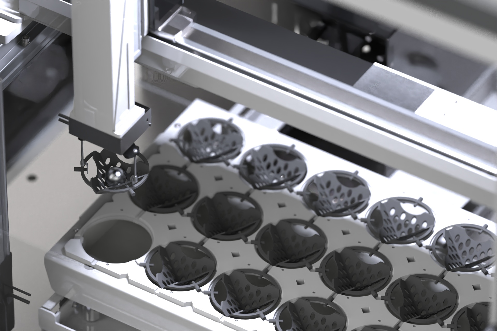

Dimensionics Density
The density of AM parts plays a pivotal role in determining their material properties, structural integrity, and overall performance. Image courtesy of Dimensionics Density

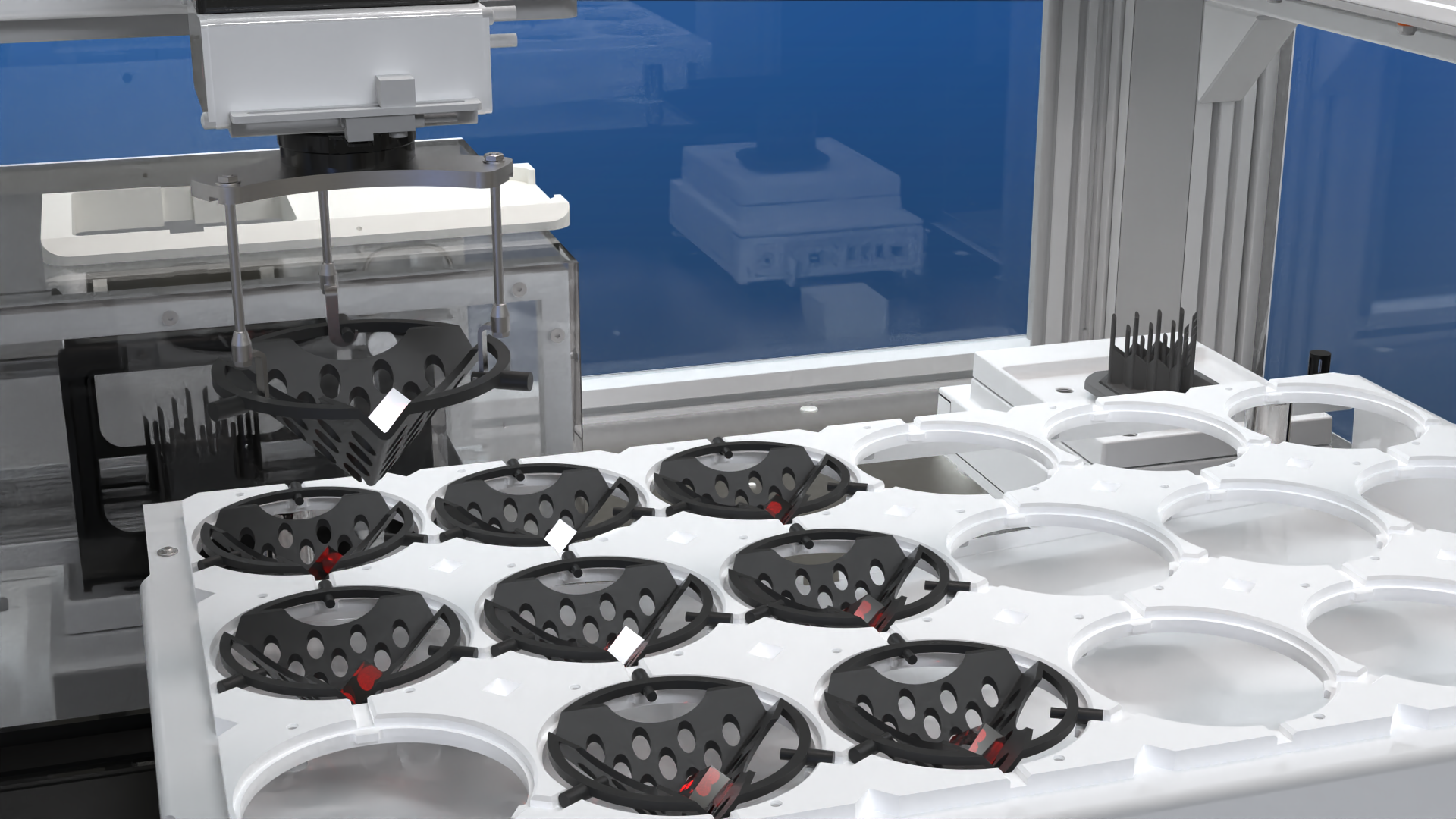

Dimensionics Density’s solution effectively combines the Archimedes density determination method with modern automation technology. Automated part handling eliminates human influence on measurement, as parts are always placed identically onto scales.  The scales are designed to be insulated from vibration. In addition, all ambient conditions such as temperature, air pressure, and water temperature, are recorded via climate sensors, and their influence on the measurement result is taken into account directly in the evaluation algorithm when determining the density.
