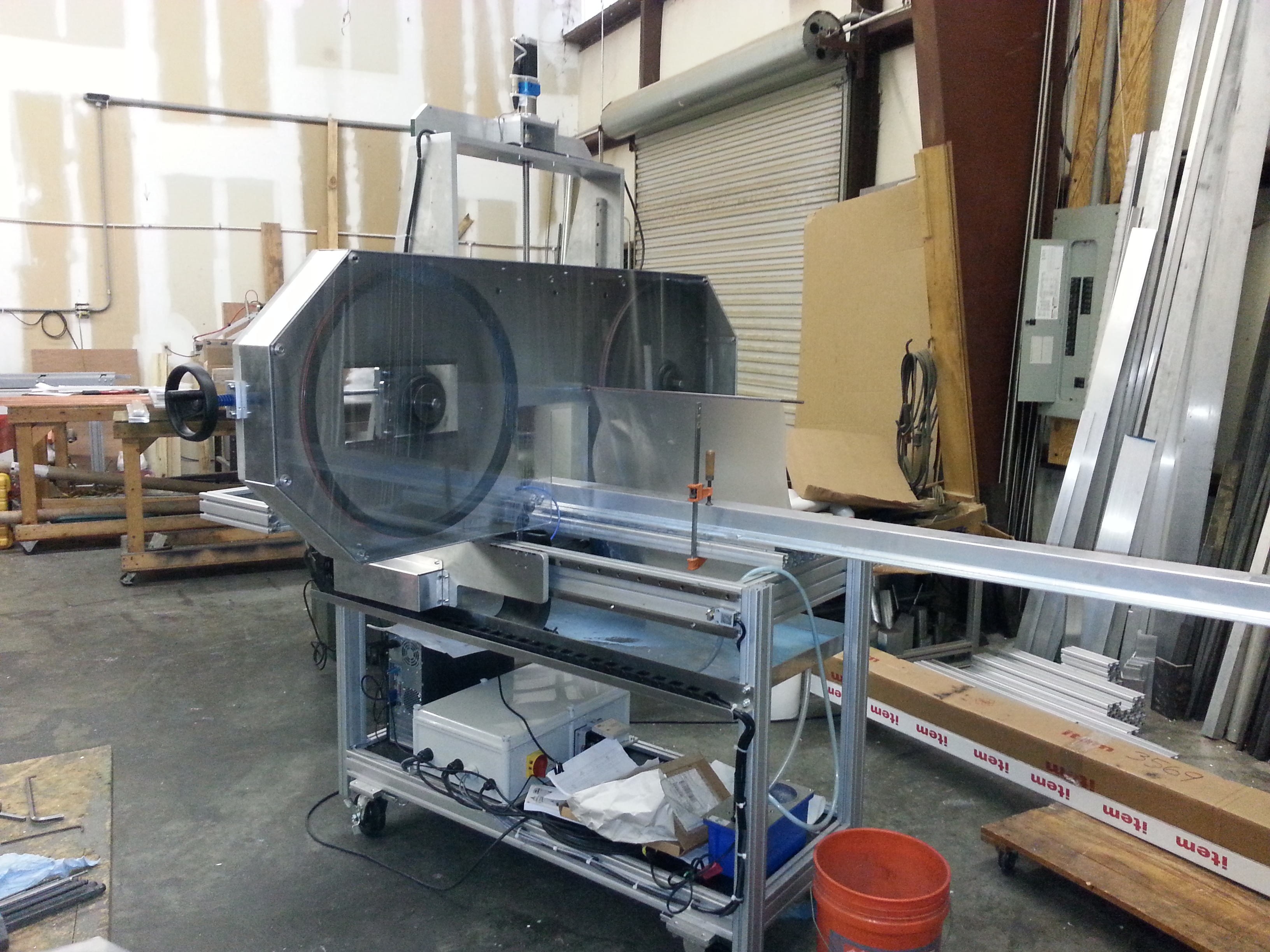

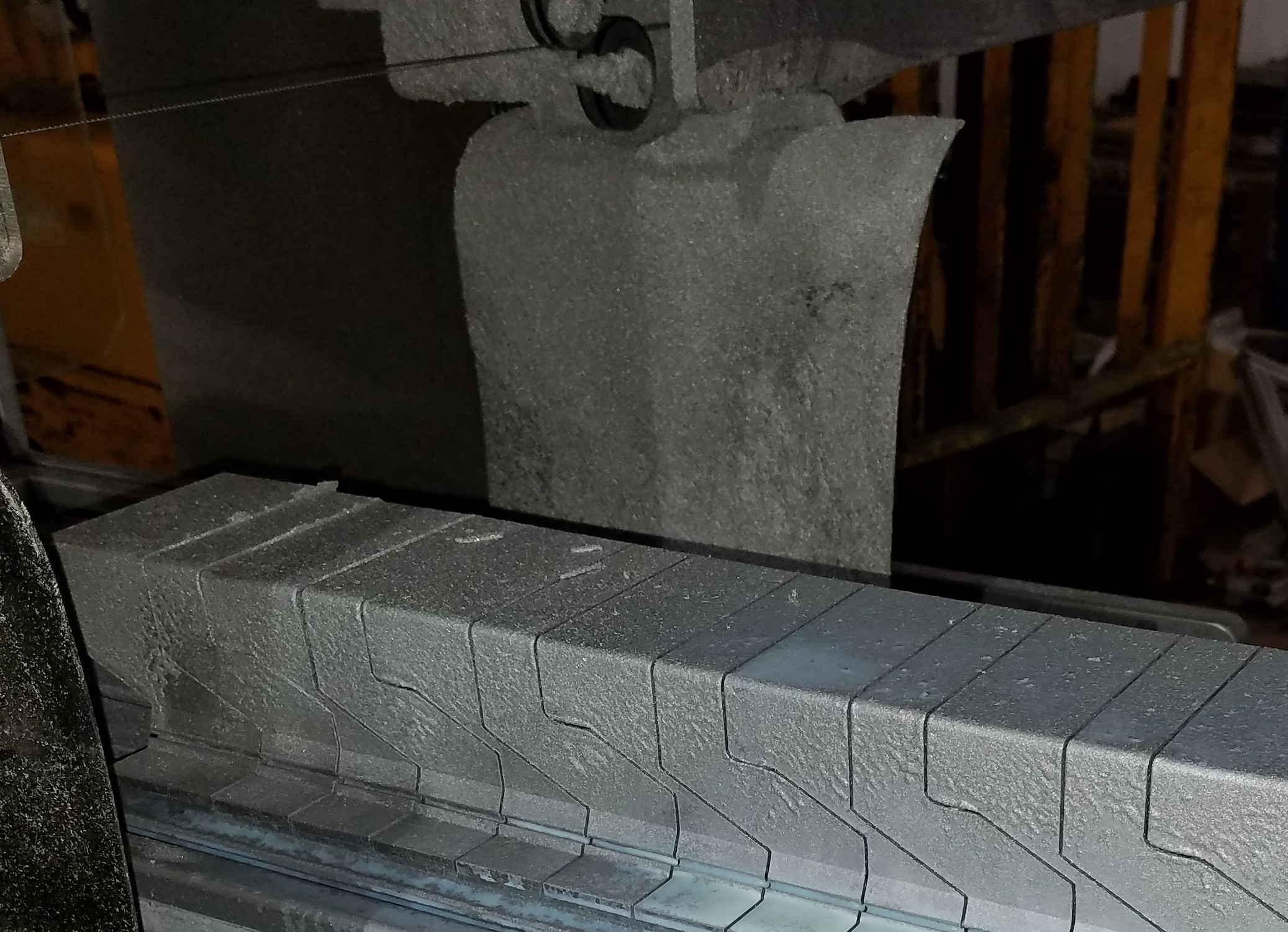

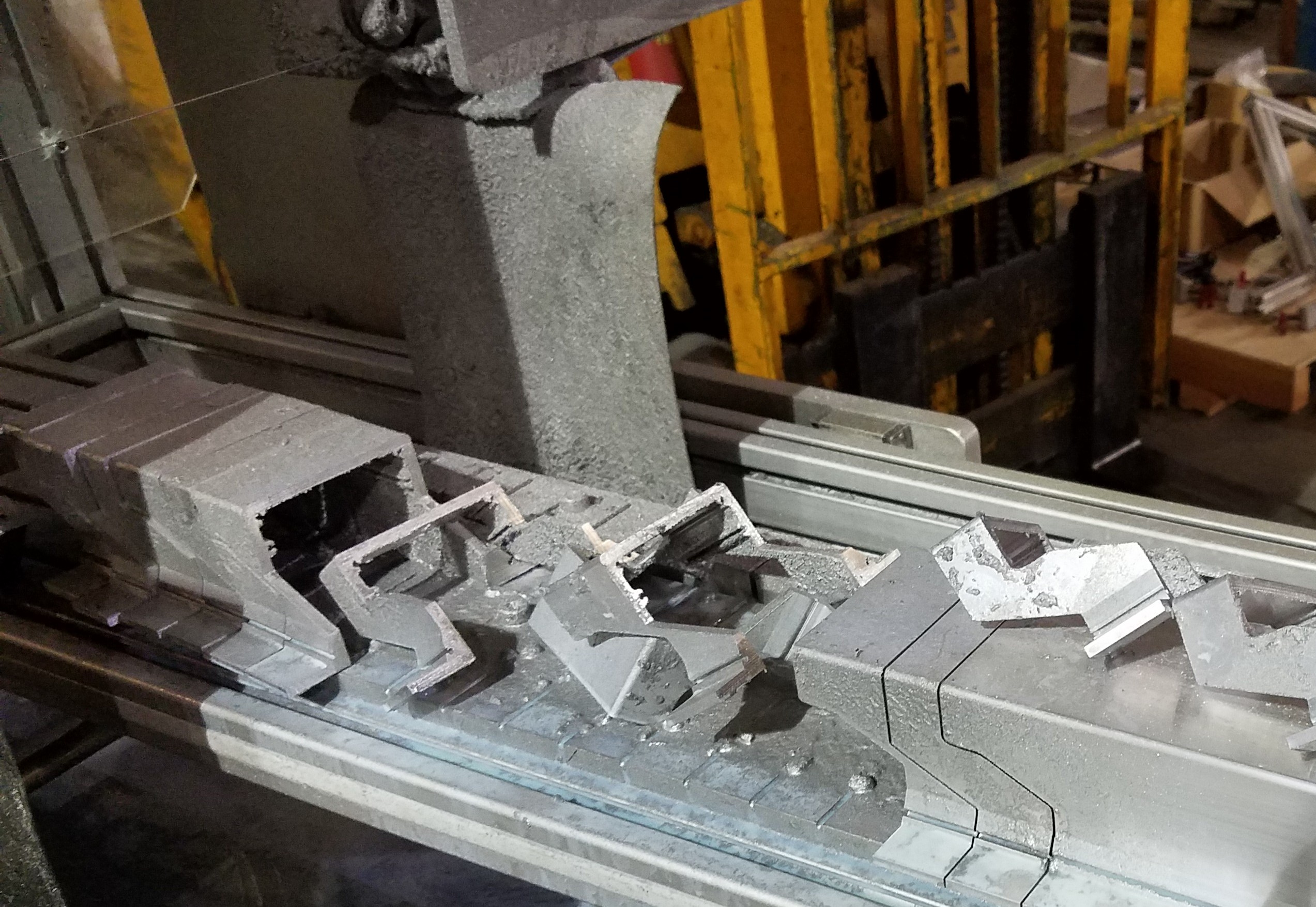

After several initial conversations with Bestway, Panafab developed a cutting platform based on company’s recommendations. This custom bandsaw was designed to rapidly cut the aluminum handles sequentially from their aluminum extrusion, requiring only two axes of motion to produce a part in one cut with the Spyral blade. This action would then be repeated continually until the entire extrusion was consumed.
Prior to undertaking the design of a custom saw, Bestway suggested that Panafab send the extrusion material for test cuts.  “Once we received the material and thoroughly understood their fabrication needs, we experimented with Spyral blades of different diameters until we developed a template that we thought would work,” said Gordon. “We had previously put in a lot of effort to develop a weld for the Spyral blade to be used in continuous loop applications.”
Given Bestway’s vast experience with systems like these, the company was able to provide Panafab with several recommendations within a few days after receiving the manufacturing details and running tests on the aluminum pieces. Within four months of the initial outreach, Panafab was producing 1,500-piece batches of the aluminum handle with a .050” Spyral blade making dimensionally-accurate simultaneous vertical and horizontal cuts in a single stoke.
