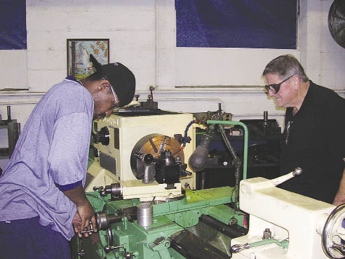

Jerome Green (left), an apprentice at Chesapeake Machine Co., chases Acme threads with Instructor Garry Mathias.
