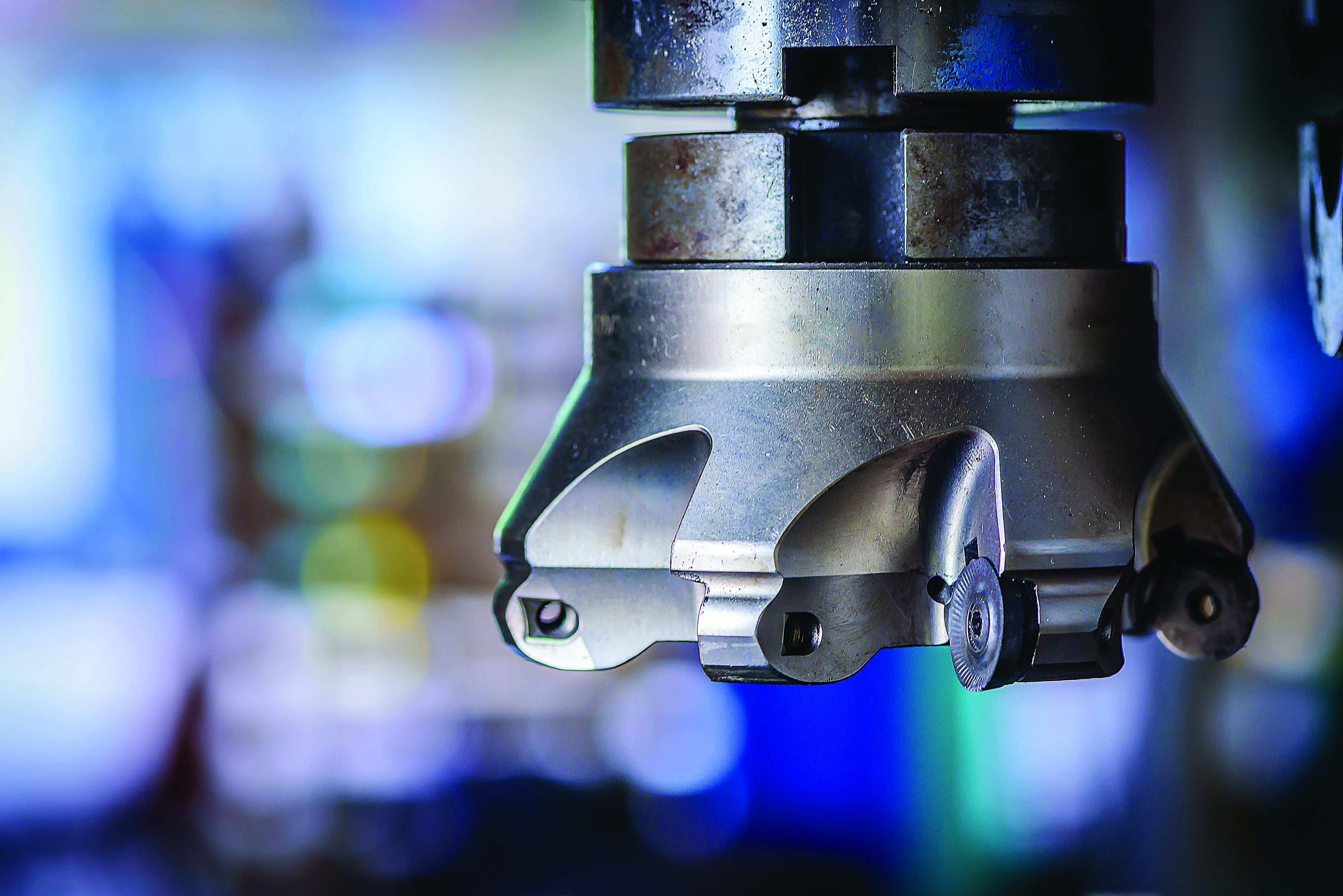

When it comes to cutting angles, the rake can make or break your facemilling process. Rake angles impact key parameters, such as chip flow, metal removal rate and tool life. So rake angles need to be chosen with an eye to the requirements of each application.
For cutters with indexable inserts, the rake angle is the inclination of an insert’s cutting face. There are two types of rake angles. The axial rake angle is the angle between the cutting edge and the axis of the cutter. This angle affects the facemilling process in several ways. It directs chip flow and impacts cutting-edge strength. In addition, toolmakers use the axial rake angle to control power consumption, said Nate Peters, senior tool design engineer at Greenleaf Corp. in Saegertown, Pennsylvania.
For cutters with indexable inserts, the rake angle is the inclination of an insert's cutting face.
For cutters with indexable inserts, the rake angle is the inclination of an insert’s cutting face. A Cutting Tool Engineering image
“If you have a machine that doesn’t have a lot of horsepower,” he said, “we may change the axial rake to give you less cutting force so you’ll be able to use that machine in most circumstances.”
The other type of rake angle is the angle between the tooth face and cutter radius, measured in a plane perpendicular to the cutter axis. Known as the radial rake angle, this angle is important in determining cutting-edge sharpness and strength.
Rake angles also can be positive, zero or negative. A rake angle is positive when the sum of the tool’s wedge angle and the clearance angle between the insert and workpiece surfaces is less than 90 degrees. Positive rake angles make tools sharper and more pointed, which reduces their strength. Positive angles also lower cutting forces and power requirements.
When the sum of the tool’s clearance and wedge angles is exactly 90 degrees, the rake angle is zero. And it’s negative when the sum of those angles is greater than 90 degrees. Negative rake angles blunt tools and give them a stronger cutting edge than tools with positive rake angles. In addition, negative rake angles increase the cutting force and the power required for a cut. They also can increase friction, resulting in higher cutting temperatures, and improve surface finish.

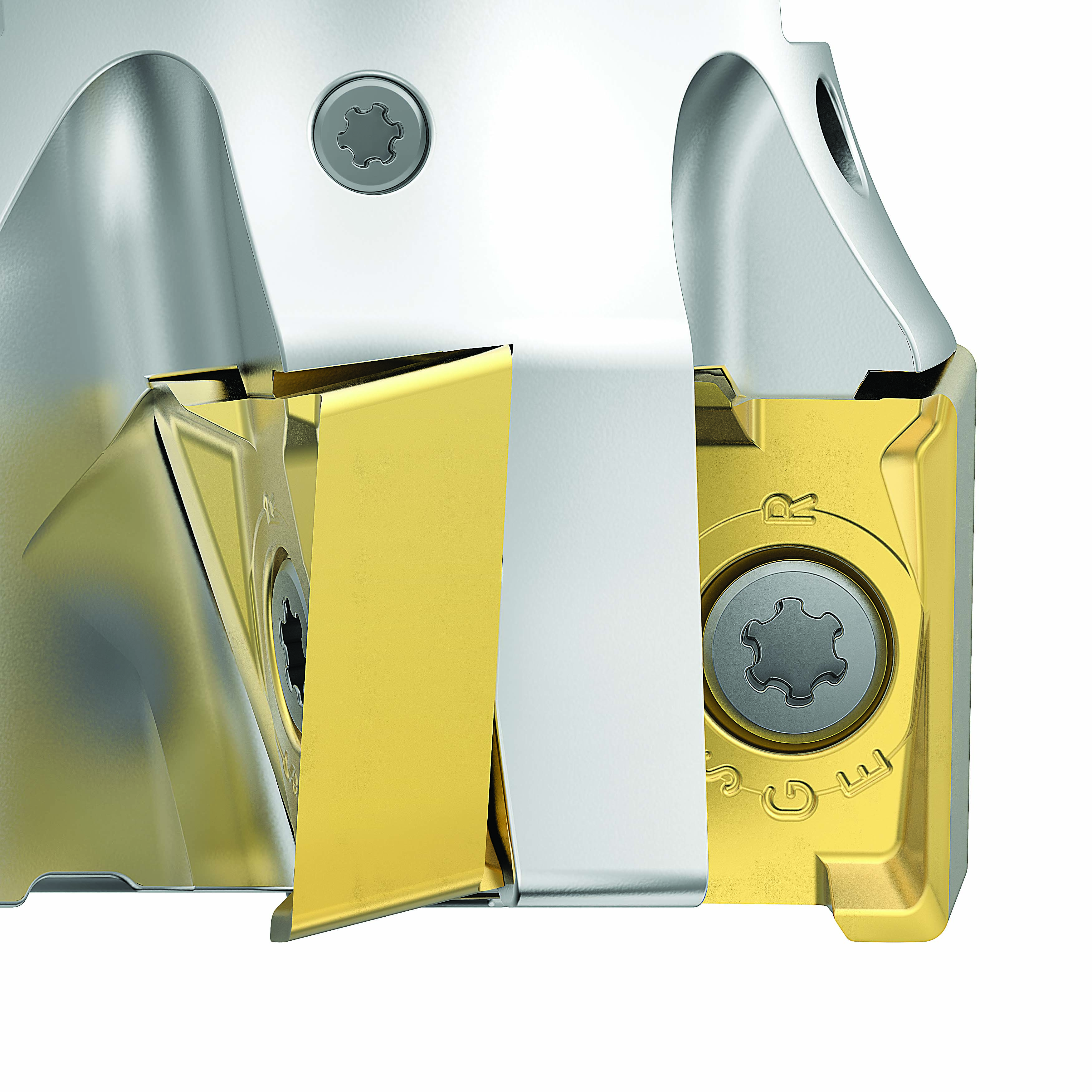

Also boosting the popularity of the positive-negative design is the fact that it allows the use of both double- and single-sided inserts. Since double-sided inserts can be flipped, as well as turned, they can offer twice as many cutting edges as single-sided inserts. For example, Fellner said Kennametal’s KSOM single-sided inserts have eight cutting edges while the company’s equivalent double-sided design has eight cutting edges per side for a total of 16.
When using a double-positive rake angle, the cutting edge of an insert needs to withstand larger forces. The edge requires a strong, stable design so it won't break or wear too quickly.
When using a double-positive rake angle, the cutting edge of an insert needs to withstand larger forces. The edge requires a strong, stable design so it won’t break or wear too quickly. Image courtesy of Kennametal
