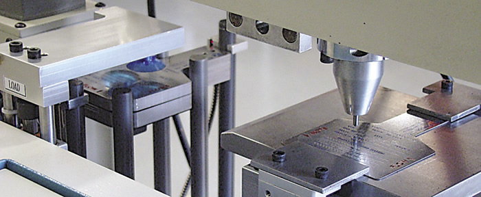

Dot peening is a more-refined method of stamping. Dot-peening machines use a vibrating punch to produce a series of evenly, spaced small-diameter indentations in the surface of a part. Dot-peening machines are programmable and can produce various fonts, font sizes and simple images.

Dot peening has a very neat and clean appearance but does not provide fine-resolution marks. The lack of resolution prevents the creation of detailed images or characters. It’s a cost-effective marking process easily integrated into automated cells or performed as a manual operation in low-volume environments.

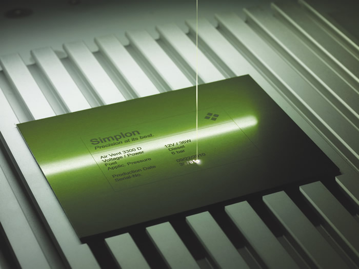

Laser etching is probably the most-desirable method available. It is extremely flexible, accurate and easy to do. The process allows intricate details that would be difficult with other methods. Laser-etching machines can have their power output and speed altered, making them capable of intricate photo-like details.
There is actually a growing industry driven by the demand for laser-etched consumer goods. An online search reveals numerous companies that etch a variety of products. These machines are surprisingly inexpensive, with some small models starting at just over $300. They are also easy to use. You simply connect the computer, select an image and tell the machine to begin.
