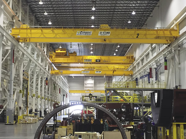

The gas turbine assembly bay is home to the shop's largest bridge cranes. The largest two are rated at 250 tons each.
The gas turbine assembly bay is home to the shop’s largest bridge cranes. The largest two are rated at 250 tons each.
Moving large, complex parts calls for specialized equipment
Bridge cranes, also called overhead cranes, are fixed to the support steel of a building and reside near the roof. Bridge cranes, as the name implies, “bridge,” or span, the entire building. Opposing walls support the rails carrying the bridge structures, with a trolley and hoist moving along rails on the bridge.
We use bridge cranes—the “big boys”—to cover large areas and carry heavy loads, such as 50,000-lb. (22,680 kg) castings, 125,000-lb. (56,700 kg) rotors and entire turbines. Because of their size, power and complexity of operation, we try to use bridge cranes only for the largest loads and place gantry and jib cranes where the loads are smaller and require more-frequent movement.
