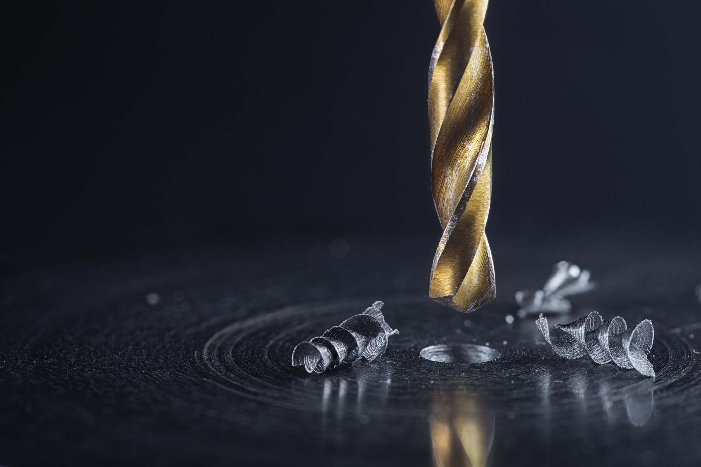

effective chip evacuation improves tool life and  productivity.
Effective chip evacuation improves tool life and productivity. Cutting Tool Engineering image

When everything works right, a drill forms small chips, and it is important to evacuate them from the hole or else chip packing and re-cutting can occur. Chip packing is when chips do not clear a hole and become packed in the flutes of the drill. The result is a poor-quality hole or a broken drill.
Re-cutting happens when a chip becomes trapped between the drill lip and the bottom of the hole. Ideally, the drill cuts the chip, and the pieces are evacuated. Worst case, the chip stays trapped. The drill then is unable to form new chips, stops advancing in the hole and breaks.
Obviously, effective chip evacuation improves tool life and productivity.

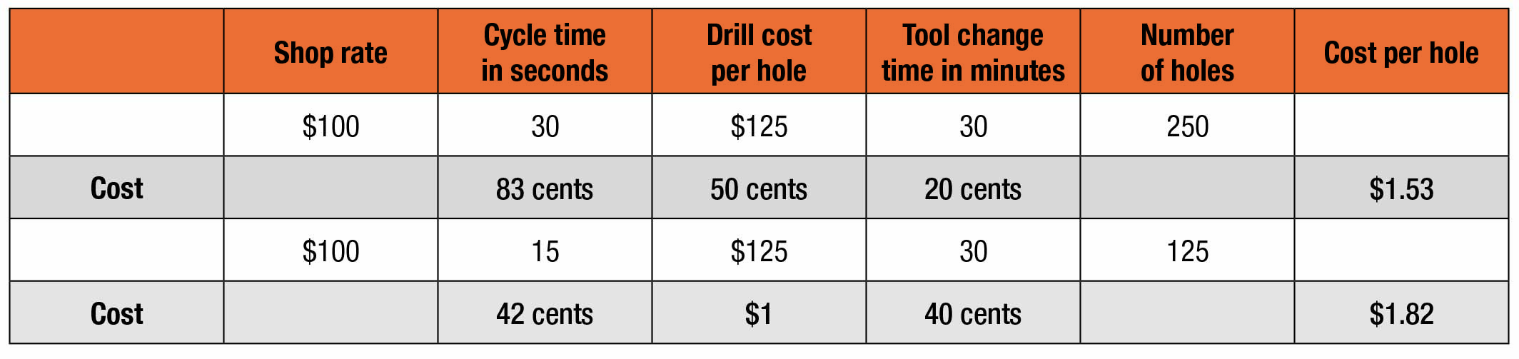

These things are important because efficiency is really a euphemism for cost. Shops want efficient drilling operations to improve profitability, and achieving the lowest cost per hole is how efficiency is measured.
We know that increasing cutting speed or chip load improves cycle time. However, faster holes are not always cost-effective ones. While spinning a drill faster can lower costs, it also can raise them if cycle time is the only cost aspect considered.
Faster holes are not always cost-effective ones.
In the example in the table, if the shop rate is $100 per hour, the labor cost for a 30-second hole is 83 cents. If cutting speed is increased and the hole is drilled in 15 seconds, the labor decreases to 42 cents. The result is a lower cost per hole, right?
Maybe not. The true cost of a hole includes labor (cycle time), the cost of the drill and the time that it takes to change the drill divided by the number of holes that can be drilled.
Increasing the cutting speed usually reduces tool life and the number of holes that a drill can make before it needs to be changed. In the scenario in the table, drilling speed is increased, which delivers a better cycle time. However, drill life is decreased by half, and the cost per hole increases.
Of course, there are caveats with this example. Increasing the drill speed does not always reduce life. Sometimes a speed increase improves tool life. The relationship between drill life and cutting speed is rarely 1 to 1, so doubling speed may produce only a 30% decrease in life. We also are not factoring in the cost of resharpened drills, which reduces the average cost of a drill.
